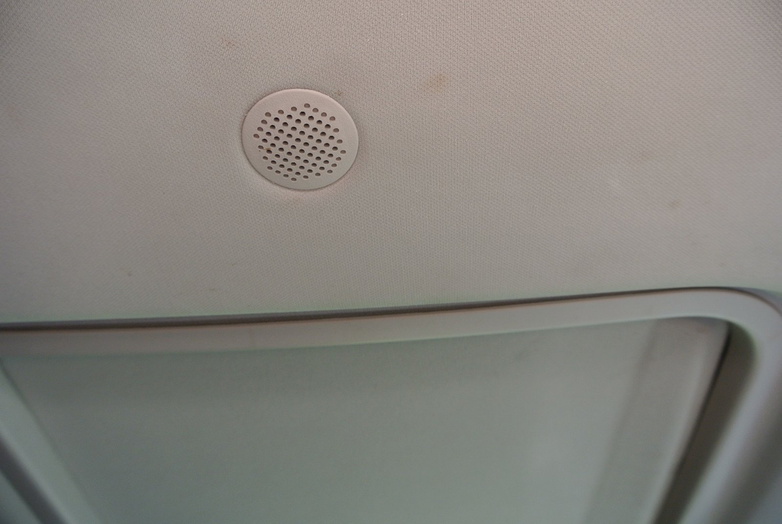

I only have one of those little grills above the driver seat. None anywhere else.
the only other possible location I know of where there could be another one is in the headliner is drivers side rear way in back by the hatch, nothing there?
30,566
48,044
Nope, only have one sensor above my head.
weird, then the calibration on mine would do you no good because mine has 2 sensors, my initial issue was it was looking for a 3rd but there isn't one.
you might want to take the rear hvac panel off and use the tech2 and observe it as you adjust the temp, I see you noted the commands being in reverse it seemed like that to me as well when I was testing mine I think that is normal.
if nothing else you could just install the most current calibration and see if that fixes it.
