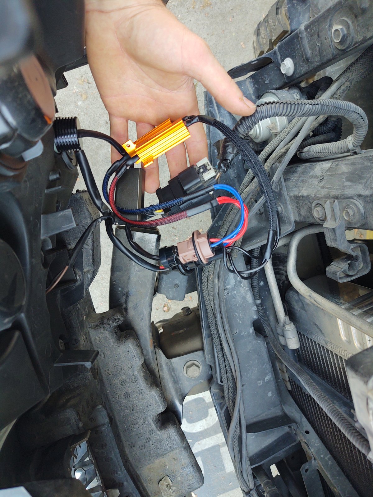

Fixed it(for now) with Amazon next day plug in resistors.
Now I have to figure out how/where to stow this monstrosity.

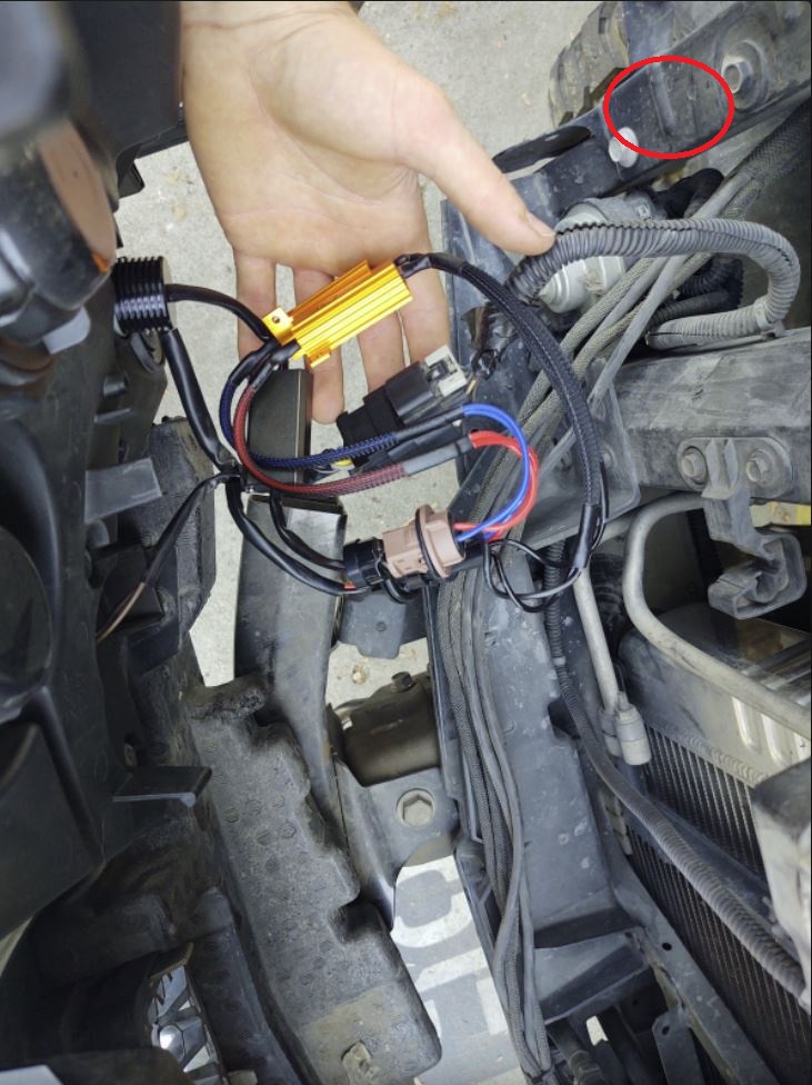

I had one like that on my yukon I mounted it here, not sure if there is clearance on the chevys
Not sure if I have clearance there either, I just tied it up on that mounting point for the headlight harness, there's nothing there between the fender liner and the core support so they're just hanging in free air essentially.
I know they get hot as hell.
30,738
48,417
yep so hot they will melt any plastic that touches them
30,738
48,417
Thats interesting and one if the reasons I am sticking with incandescent bulbs or will have the hyper-flash disabled.
typically the resistor it's self is ceramic and the metal part around it is just a heatsink, attaching it to other metal allows it to dissipate the heat better.
inside the ceramic is a metal strip like a fuse but the ceramic allows the heat to escape and not burn the metal strip creating resistance. at least that's my theory based on taking things apart to see how they work, lol
Sounds right. I understand how resistors make heat. I was just surprised they would make a lot of heat in a flasher circuit. I guess it's 50% duty so sitting at a light for a few minutes would add up.
