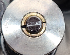

Today is the ol check pushrod length day.
This time around I located my adjustable pushrod and the checker spring.
When I did this last time, I couldn't get them or find the ones I had.
So doing this with the head gasket, and a nice digital caliper that can actually measure the entire pushrod (so much easier).
I'm finding that no matter what, the rocker arms sweep the same... makes sense i suppose right?
So, what I found is the sweep is too far inboard on the valve at the stock ls pedestal height.
But taking a washer that is .060 thick, I get the wipe pattern that i want.
Example,
Swipe with the stand against the head.
Swipe with the stand elevated .060
wtf?!
Example,
wtf?!
Is it the same for all of 'em?
Example,
wtf?!
Do you have hydraulic lifters? if so, are they pumped up?
With non-adjustable pedestal style rockers, the adjustment is made with shims or pushrod length
They are not pumped up
Odd part is the wipe pattern for my 1.8 full rollers is off unless i shim them
Compcams magnum rockers + AFR mongoose heads :think:

This was all noticed because with 7.375 pushrods showed a wipe pattern that was too far inboard.
(right in there with the .050 - .100 ls7 lifter preload)
So i was like fk it, went back to the 7.4's
still good, but under .100 preload
now with the engine torn apart again, i noticed the wipe pattern didn't really change with the longer pushrods.
so here i am, finding the 0 lash so I can figure out preload for the correct pushrods and the sweep never really changes.
it sort of goes closer to the middle by a tiny bit.
I'm sure i'm doing this wrong, but shimming the stand up and it's looking much better. :think:

They are being quite helpful.
They said the wipe pattern looks good since it's mostly in the center.
Still odd to me that it's off.
With my sbc in the vette, the rockers are fully adjustable, much easier.
I explained that my main concern , and the reason why I'm detailing this out is the valve train noise at light throttle.
First blamed on the transmission pump or the thrust bearing.
Last run proved it has nothing to do with bearings, and the pump while damaged, was not bad enough to explain the noise...
Next blame in my head would be the double pac springs in the heads.
Or some weird side-effect of the oil pump flooding the heads..
Now i wait... lol

Another concern with the wipe pattern would be the valve guides in those expensive fancy heads.
I still might play with shims, but i don't want to run a full .060...
I did find some shims that go between the stand and the rockers.
They are .020 each...
