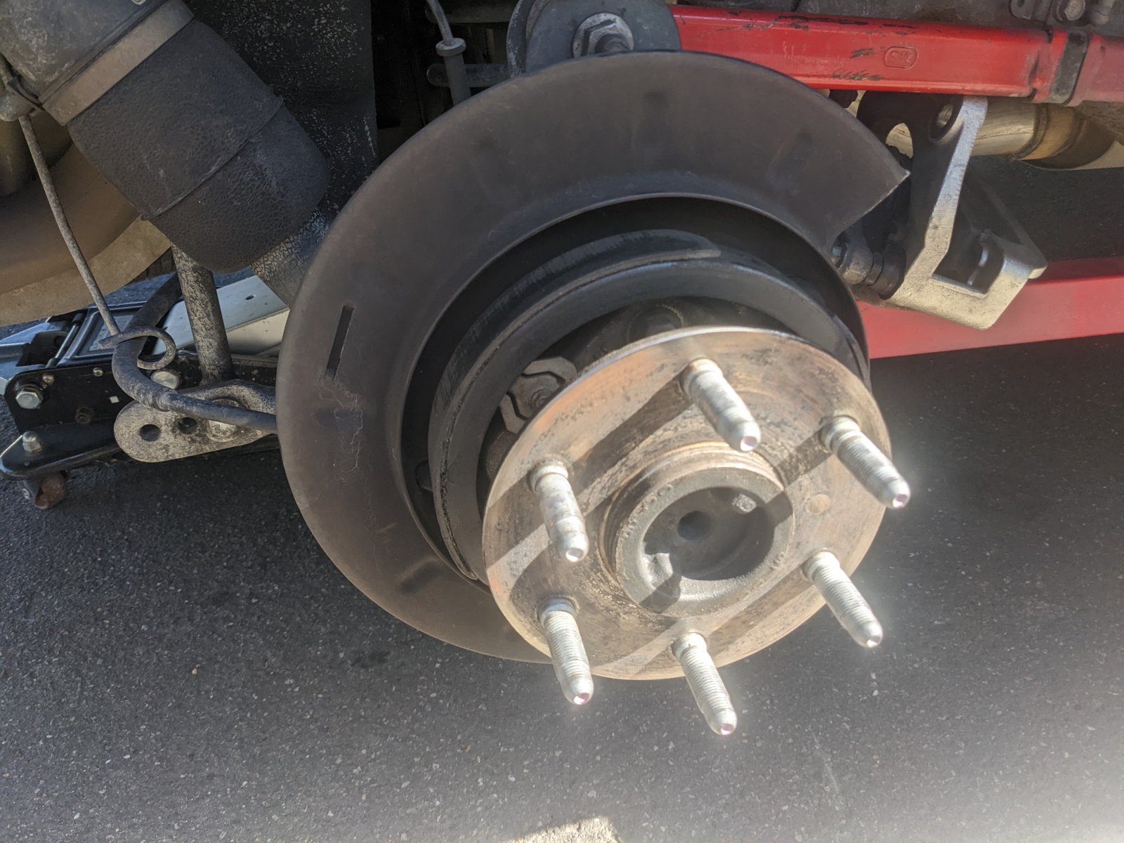

Got some kind of squeak noise on the right rear, only when turning left and occasionally when straight for a second after coming out of a left turn, can't find anything visible, brake cleaned the inside and outside of rotor, slapping it back on. Any ideas? I'm at 144k I doubt it's a axle bearing at this mileage everything looks good

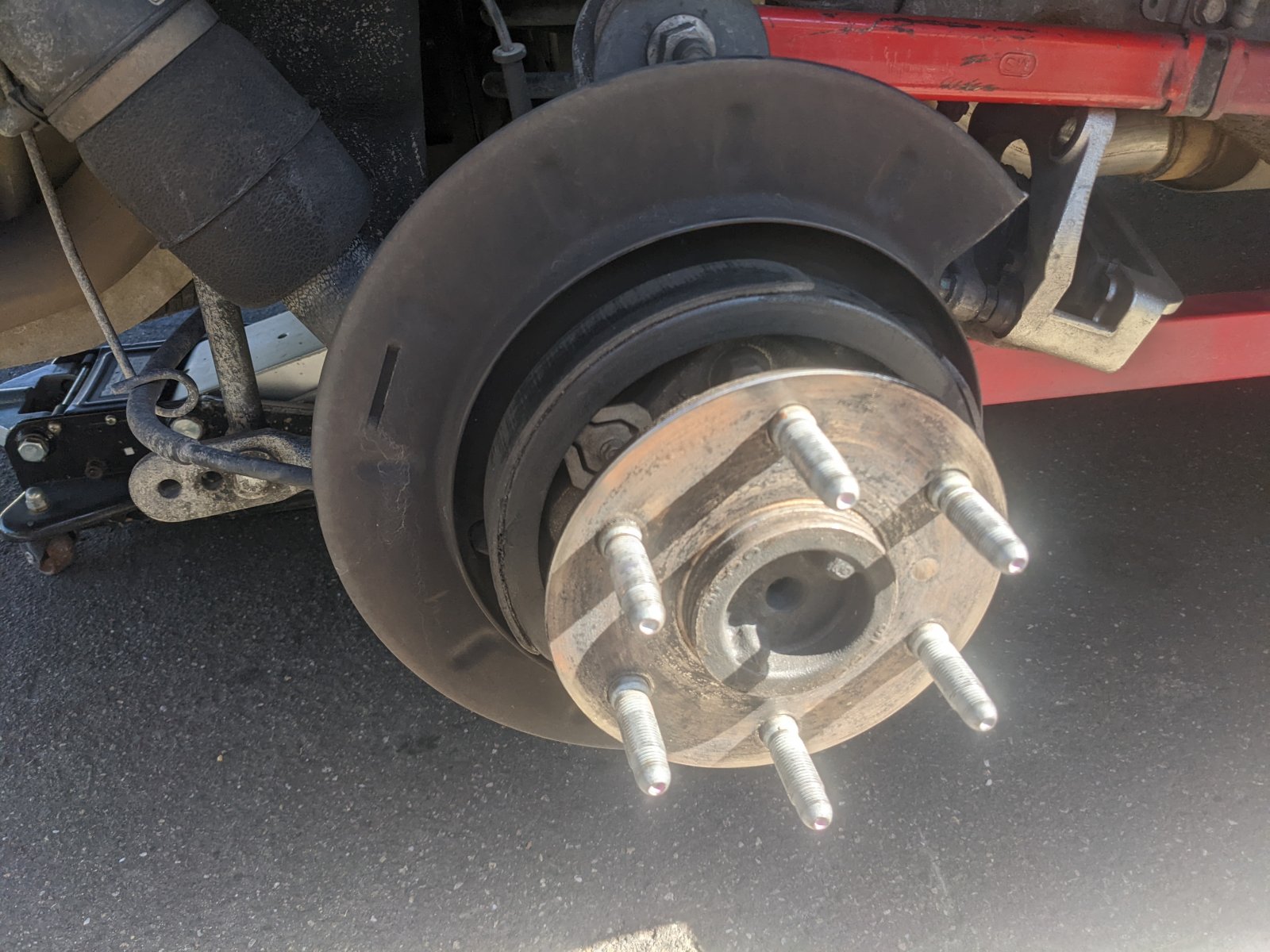

Got some kind of squeak noise on the right rear, only when turning left and occasionally when straight for a second after coming out of a left turn, can't find anything visible, brake cleaned the inside and outside of rotor, slapping it back on. Any ideas? I'm at 144k I doubt it's a axle bearing at this mileage everything looks goodView attachment 367503
Well after driving in circles and rotating front & rear windows up & down and then having the wife ride shotgun with her head out the window it is the front right, not rear, pretty typical for these trucks to throw sound, took the front right wheel off and inspected, did a minor tweak to one of the brake pad metal tabs and 90% of the noise is gone, hubs seem ok no play but I can hear a couple light "ticks" when spinning the wheels which is probably normal but I think I will order new hubs and pads anyway.
and got to use the new Ridgid took 3 of the wheels off and back on, didn't even put a dent in the big battery and with it set on "2" it was pretty dam close to 140ft lbs with a few bumps.
Could those ticks you hear be the cv axle?

Not likely, usually the ticks are bearing noise, 2wd's will make the same noise, one axle is fairly new and both sides sound about the same. at the mileage I am at I am getting close to having to do the hubs anyway I found oem hubs from o-reilly for $175 (special order) I will go by there later today and see if they can get them at that price otherwise rockauto has them for 189, if I can get them from o-reilly then I will save the shipping cost and a few bucks, hubs are easy to do anyway, no rust here and I am pretty sure I have the socket for the axle in my tool box already
