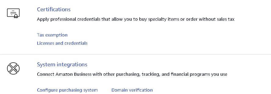

I also have a tax ID number, but it seems they still charge me tax.
you have to change it to a business account, then be sure to enter your hours and days open including holidays or you wont get delivery's on the weekends by default.
if you have a regular account and prime it won't carry over the prime to the business account, business prime is like $150 every 6 months or something stupid like that which is why I don't have it.
Strange, I do have a business acct, and I don't ever remember putting in my hours. I get deliveries Sat and Sun. I pay the normal Prime price too. Weird.
go into settings and set your tax exemption
