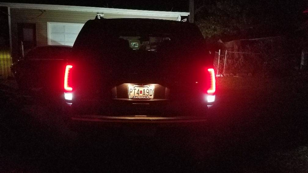

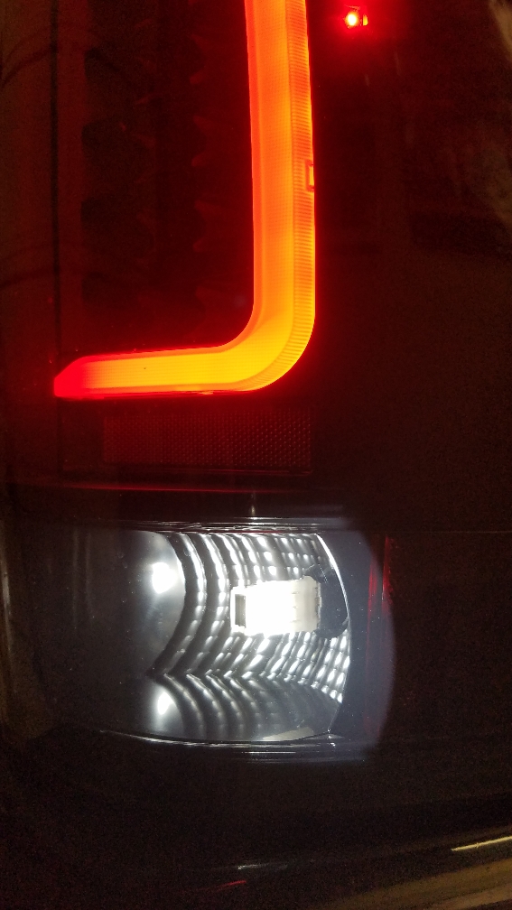

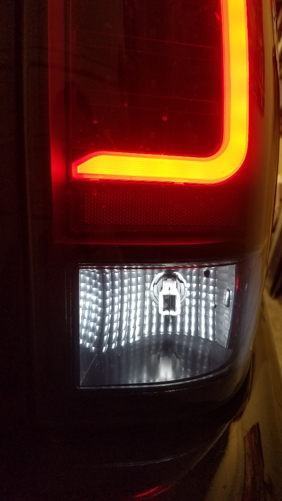

I don't really like these Sylvania LED reverse bulbs. They only have LEDs on each side, none on the top of the bulb (pointing straight back when installed).
Yeah, they're seen easily from the side, but not from behind, or when using the backup camera at night. They were only $14 though from the Walmarts.... Lol

You need projector style. Similar to these. Not saying these are the best, but it’s the type I’m talking about. 3157 LED Reverse Light Bulbs, AUXITO 1400 Lumens 4014 102-SMD 3056 3156 3057 4157 LED Bulbs with Projector for Backup Reverse Lights Tail Brake Signal Lights, 6000K Xenon White https://www.amazon.com/dp/B0749G3M4Y/ref=cm_sw_r_cp_tai_SZEpFbXRQQZX8

That's what the fog lights I got look like, chips all around and one on top with a lens. Thanks for the link!

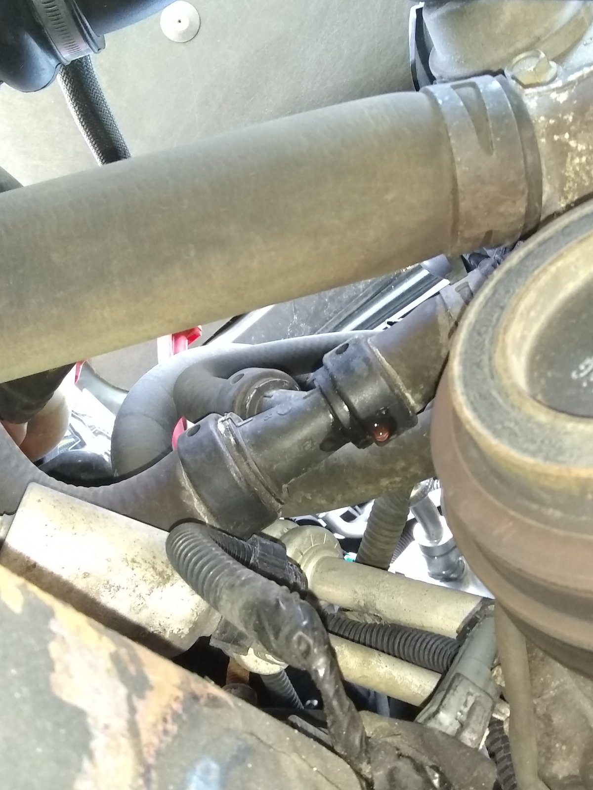

Got a Dorman aluminum Y to replace this leaky bastard.
Anyone ever replace one of these?
Thinking about replacing the shorter hose to the block, overflow tank and the fitting since I'm not having any issues with the fitting going to the firewall.
ya I have had the Y leak before, it lasted a solid 10 years or more though so just replaced it with oem, it's the same hose 00-14

The aluminum one from Dorman comes with all new hoses. I installed one on mine, but I used a Gates hose for the one that goes to the heater cores since I already had it and I wanted those two to match since they run parallel to each other.

I was considering going with a stock replacement (because it has lasted so long) but liked the idea of one solid piece.

Gotcha, planning on removing the factory fitting and reusing the hose to the heater core.
