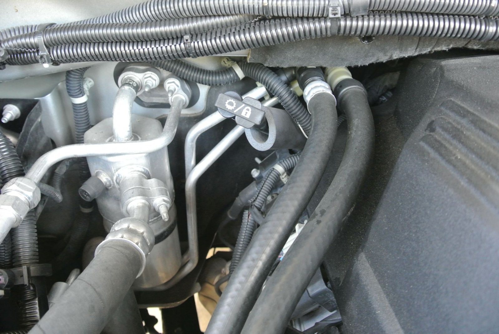

Handle shows up yellow just an fyi [emoji6]![]()
Mine's black with white symbols also, like in Doubelieve's pic

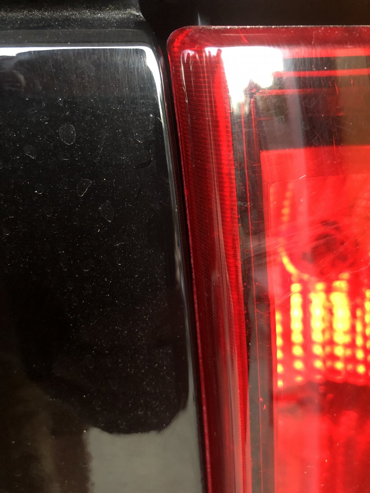

Weird. Wonder how that happened.Noticed the edge of the rear gate was rubbing on the right tail lamp housing. It had worn through the paint to metal right on the edge. Took the inside trim off only to find no adjustment on the hinges to the body. Marked and loosened the hinges from the gate and slid it all the way to the left. That didn’t really help much and it wasn’t very far. So I added some spacers behind the bumper which moved it out and over a bit. Then I removed a little material on the tail light and now I have some clearance.
Maybe the tail light housing is warped or sits funny....Weird. Wonder how that happened.
Does it look warped?Maybe the tail light housing is warped or sits funny....
I had to do something similar for my aftermarket tail lightsNoticed the edge of the rear gate was rubbing on the right tail lamp housing. It had worn through the paint to metal right on the edge. Took the inside trim off only to find no adjustment on the hinges to the body. Marked and loosened the hinges from the gate and slid it all the way to the left. That didn’t really help much and it wasn’t very far. So I added some spacers behind the bumper which moved it out and over a bit. Then I removed a little material on the tail light and now I have some clearance.
