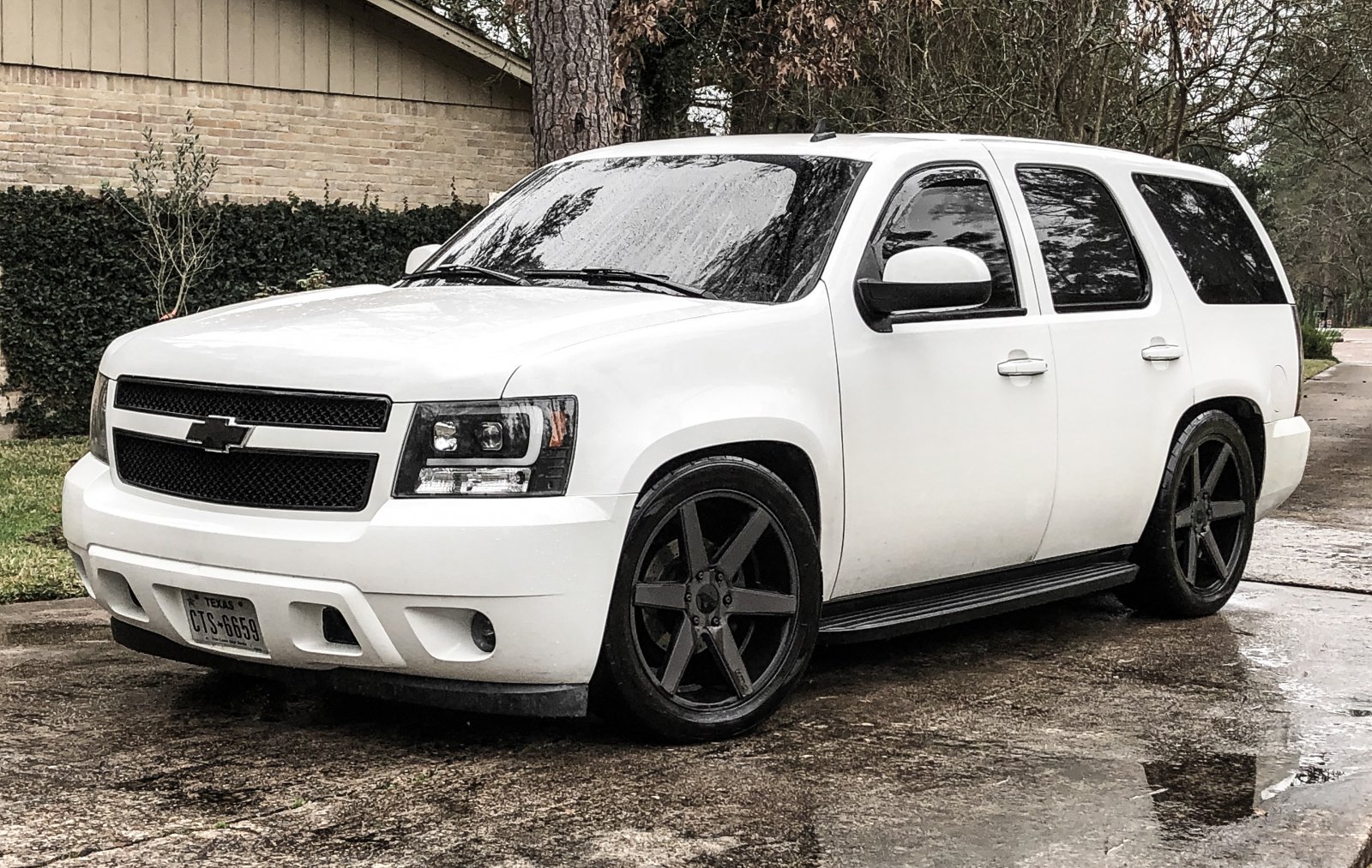

Needs a bath but I like this pic

This is one of VERY few vehicles I’ve seen with black wheels that I actually like. Good job with those. [emoji106][emoji631]
thanks! They’re actually kind of a dark bronze but essentially black at the moment since they’re dirty. I’ve been thinking about switching it up.... maybe these in a 24.
I had some 24” slides a few years ago and kinda hated everything about them except the looks. In my opinion a 24 with a lip is the best look. Power loss to the wheels... ride quality... braking... I did however run a 305/35 which was about an inch taller than stock so I know that was a factor. I’m not big on the chrome lip but these would look amazing. Maybe white lip with black center..? or all brushed. Kinda want to get away from the black
