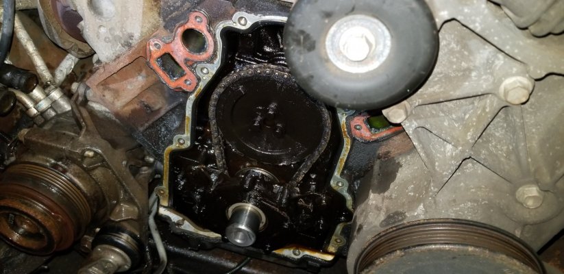

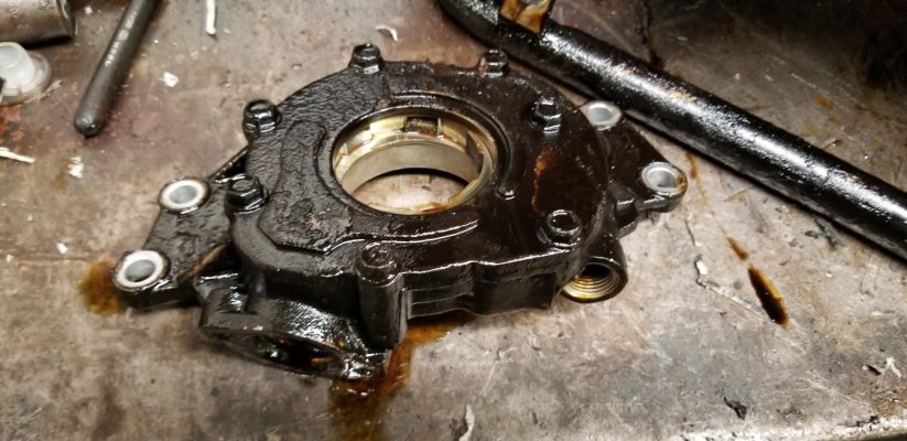

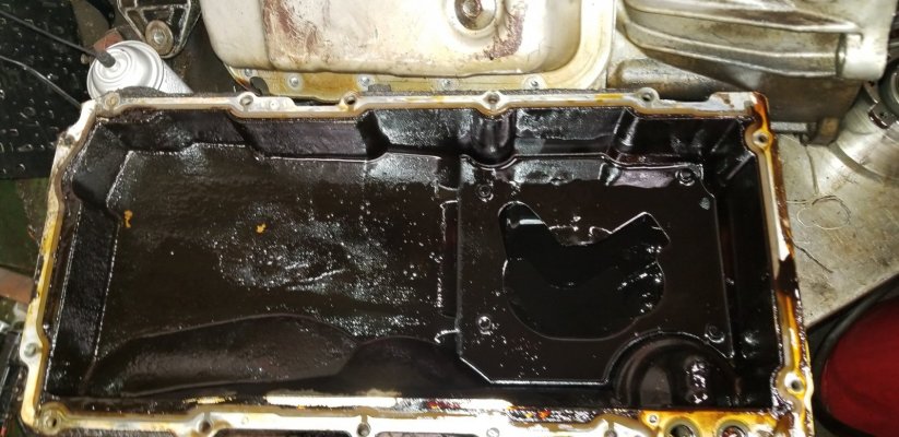

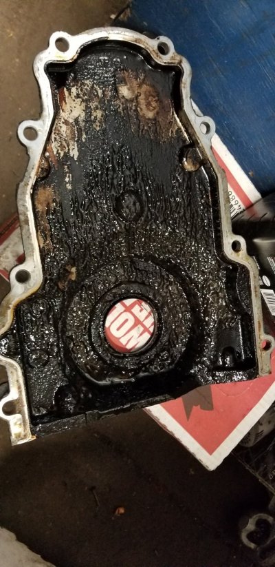

My OP went to 0 in my van. Revving it would move the needle maybe to 10 psi--if that. It also developed a low knock.
O ring was fine, but swapped it out anyway. Here's what it looked like. 20200114_184000.jpg20200114_184153.jpg20200114_190420.jpg20200114_190430.jpg20200114_190436.jpg
The sludge in the pan was really thick. Unfortunately I don't have a pic of the pick up screen, but it had gunk in the screen. It was pretty bad.

My OP went to 0 in my van. Revving it would move the need6maybe to 10 psi--if that. It also developed a low knock.
O ring was fine, but swapped it out anyway. Here's what it looked like. View attachment 353426View attachment 353427View attachment 353428View attachment 353429View attachment 353430
