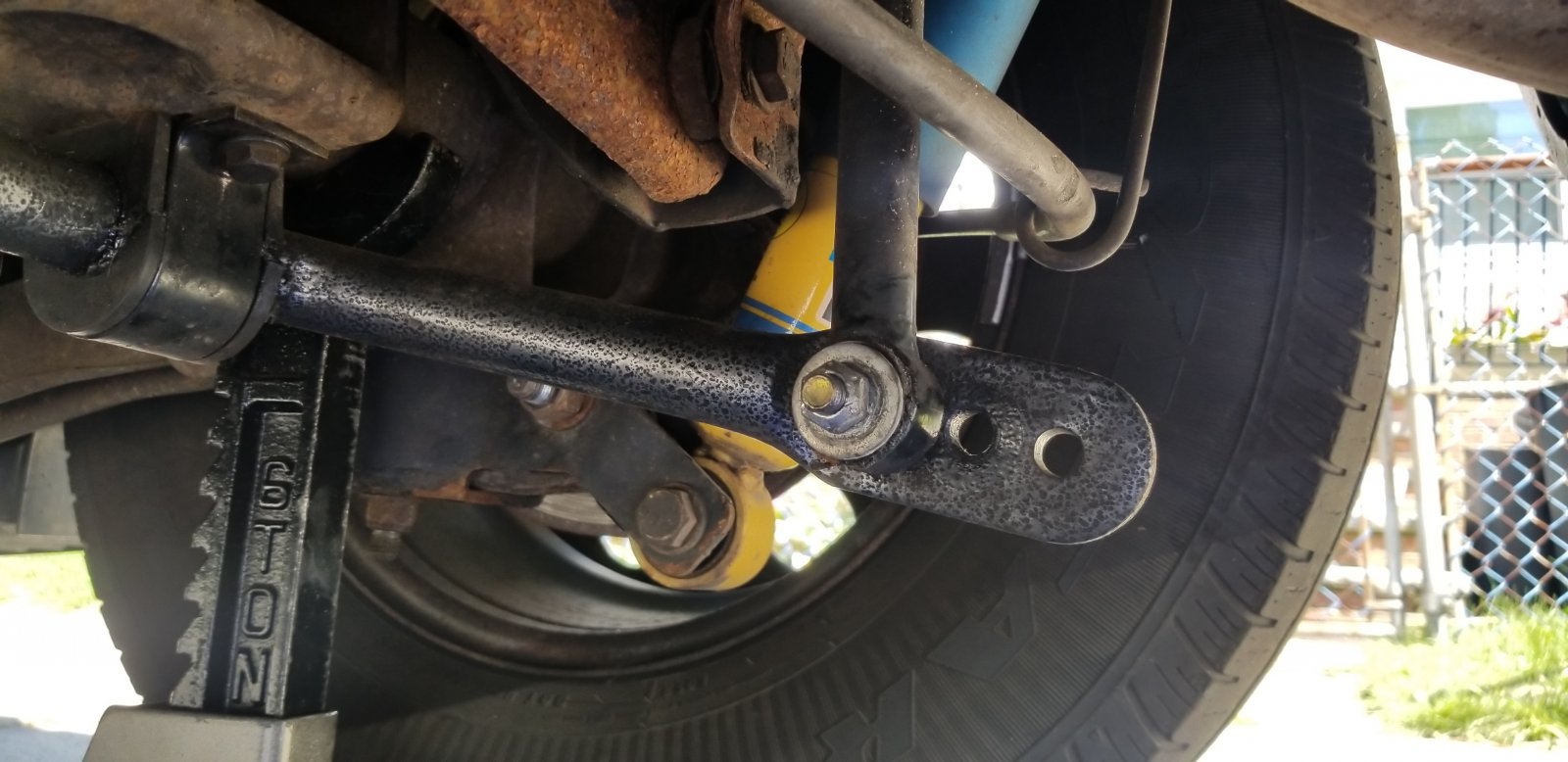

I was able to adjust the rear swaybar to the most aggressive adjustment. 20220703_151631.jpg
