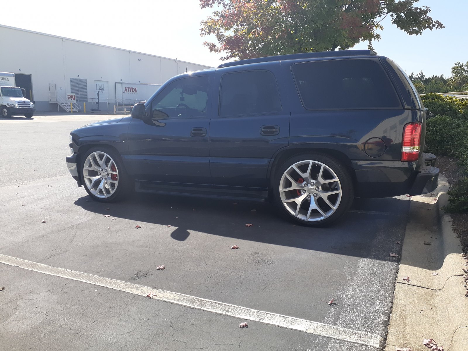

View attachment 259567 View attachment 259568 for some reason, I'm guessing shortage. This just started happening. The driver side turn signal is dim and on constantly. It works normal when i use the turn signals, it does not flash rapidly as if there was a bulb out. I know this dim light happened once before and came back to normal the next day.
Guess I'll have to check all the wiring.
Fix that damn tpms too. :lol2:

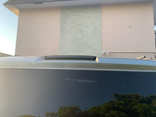

I decided to go ahead and “attempt” to paint the trim around 3rd brake light and Esky appliqués. I say attempt because I already know from previous try’s at painting that things never come out like they’re supposed to.
Trim by 3rd brake light
Passenger side applique
Driver side applique
Close up of driver side and the horrid job I did on my own!
Did you paint while there was a little wind ? What was the temp ?

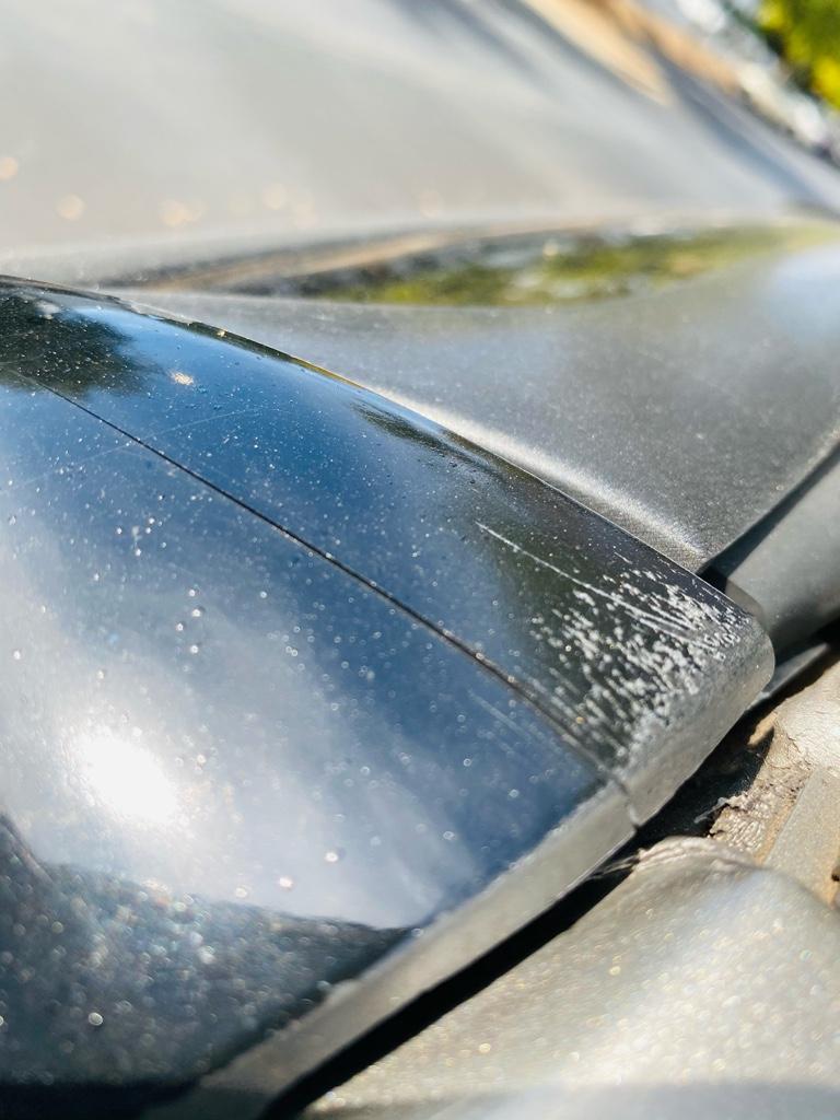

Basically a hairline fracture but I I know eventually it’ll spread.
If you can't find another one cheaply enough, you can fix that one and have virtually no chance of the crack spreading or reappearing. First, determine some way to set up the piece where the portions on either side of the crack would be squeezed together (small blocks and clamps, stacked heavy books, etc.) and where it can remain undisturbed for a day or so until the epoxy cures. Drill a small hole (~3/32") at the farthest tip of the crack. This would basically create a deadhead for the crack so it wont spread any further. Then, epoxy it from the backside but with forcing epoxy into the crack. Set it up in your "jig" until the epoxy cures. Prime, sand and paint as needed.

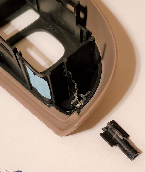

What's the best adhesive for repairing a screw tower on my switch bezel in the door panel? If I remember correctly the last time I tried, Super Glue didn't work. The plastic epoxy held until I tried to turn in the screw. Stupid that GM put a push clip on one end and a captive screw on the other.

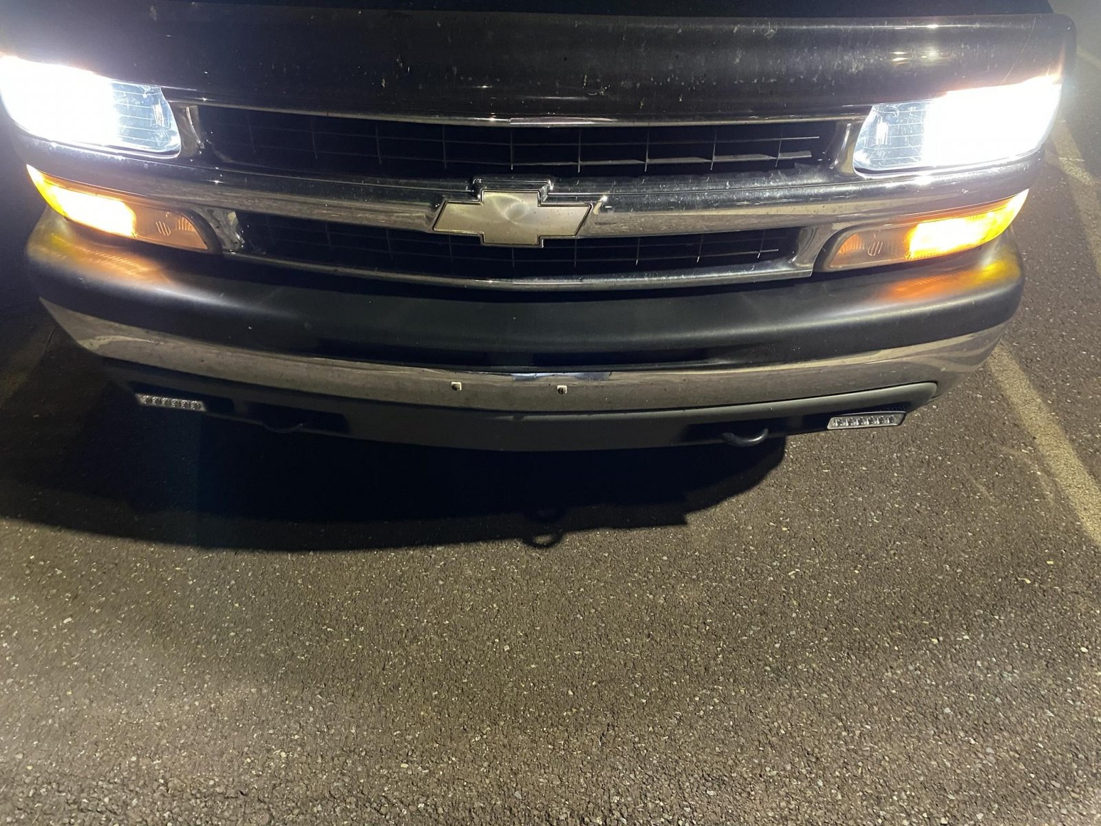

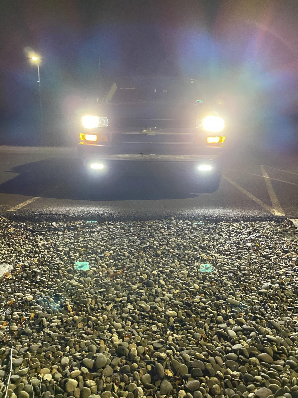

I did a thing today. I put some chineseum fogs in my bumper. I had read about it in the tech section I believe @Tonyrodz was the one who did the write up. I am pretty pleased given how I am such a little noob at these things. I fudged with the way the were pointing up/down/left/right for like 25 minutes still not totally happy. I only bled a little.
