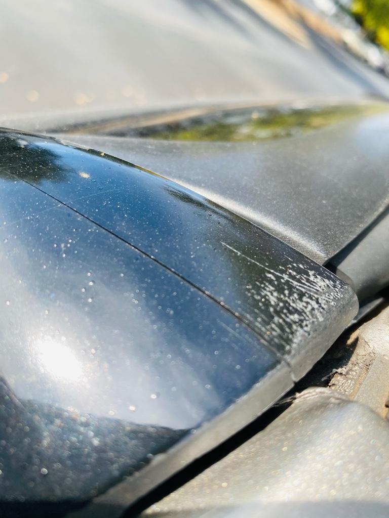

Do not like. I’d probably replace it myself. As long as you can fine one relatively cheap. Ebay.. local..
That’s what I was thinking too. And I lucked up on this black pair. Haha

Basically a hairline fracture but I I know eventually it’ll spread.
What I would suggest is to find yourself the harbor freight super glue and gently follow along the crack. But then again, you already know the extent of my knowledge! Hopefully someone with more than myself will chime in and help out!

If you have access to the back of it, get some Q-Bond and you won’t have to worry about it spreading. You can usually get it at most auto part stores.

It really is. It has a powder that helps fuse broken pieces together. It comes with some really strong super glue and 2 bonding powders, one is for plastic and the other is for metal. When you put the liquid on top of the powder, you will see a little smoke as it reacts. It only takes about 10 seconds to cure depending on what you are doing. It’s what I used to fuse the Metra pocket to my console when I took the CD changer out. The first time I used it was to glue a nipple back on a vacuum actuator. They have a good video of it on YouTube. I always keep that and Plast-Aid always on hand. Check out the ratings on them.
