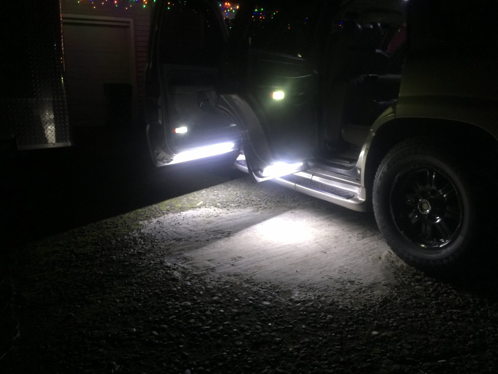

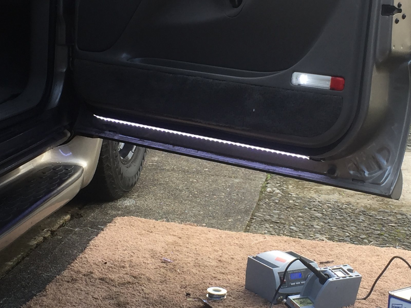

Nice. Damn they’re bright af!Here you go guys. They're wired into the door light wires like Tony said. Bright as hell at night, they really light up the ground. I just bought a roll of cut-to-length LED strip lights. You just cut them to whatever length you need, and peel the rubber coating off at one end which exposes the soldering pads. I used heat shrink tube over where the wires connect to waterproof that part.
View attachment 243041 View attachment 243042 View attachment 243043 View attachment 243044 View attachment 243045

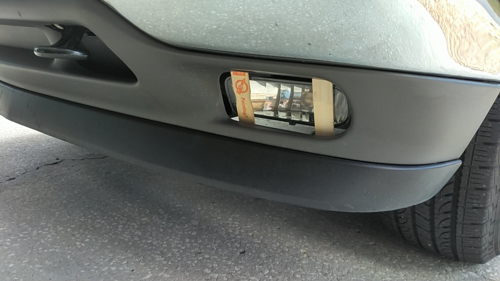

I did something similar but pulled it off and used a couple clampsBut.... TODAY,..... I am gluing a fog lamp lens.. It fell off on my driveway yesterday after washing.
I was not going to use my hands , holding the lens for 4 hours for glue to cure, so I improvised.....
Paint stir sticks fit perfect, to press on it.
At LEAST the lens fell on my driveway !!
If I am not confident the seal is perfect, I will remove the fixture and put a bead of sealant around the outer edge.
View attachment 243019 View attachment 243020
It held for the rest of the summer [emoji2373] worst case is buying a new fog light assemblyUh, yea.... I'm not to optimistic.....

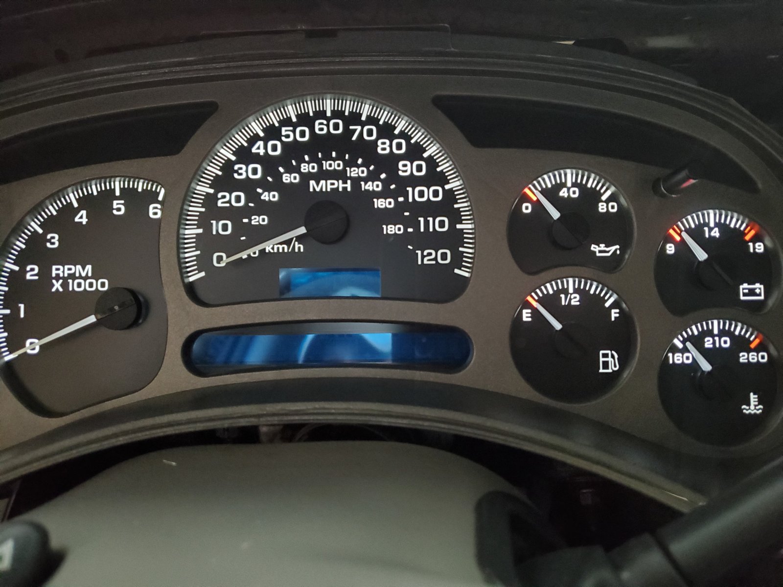

Today I installed the cluster back after getting it rebuilt and adding new white leds, it looks pimp.
Did you put blue tint for the odo display? Looks blue.Today I installed the cluster back after getting it rebuilt and adding new white leds, it looks pimp.
