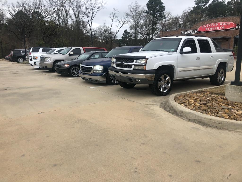

Ok so I did a brake flush at work on my Yukon the other day. I put new rotors and pads on maybe 3-400 miles ago. The brake pedal is still mushy. Been like that for years. I figured the flush would fix it for sure. The flush basically sucks all the old fluid out of the reservoir. Pressurizes it with new. And you go to each caliper and sucks the remaking old out till you see new fluid. It helped some but not enough. My avy is night and day difference and both have hydroboost. Any ideas? Recent pic of the avy when I met up with a few buddies from another forum for lunch
Might need a master or brake booster. Burb wa s that way and I think it was the master but never got to it
