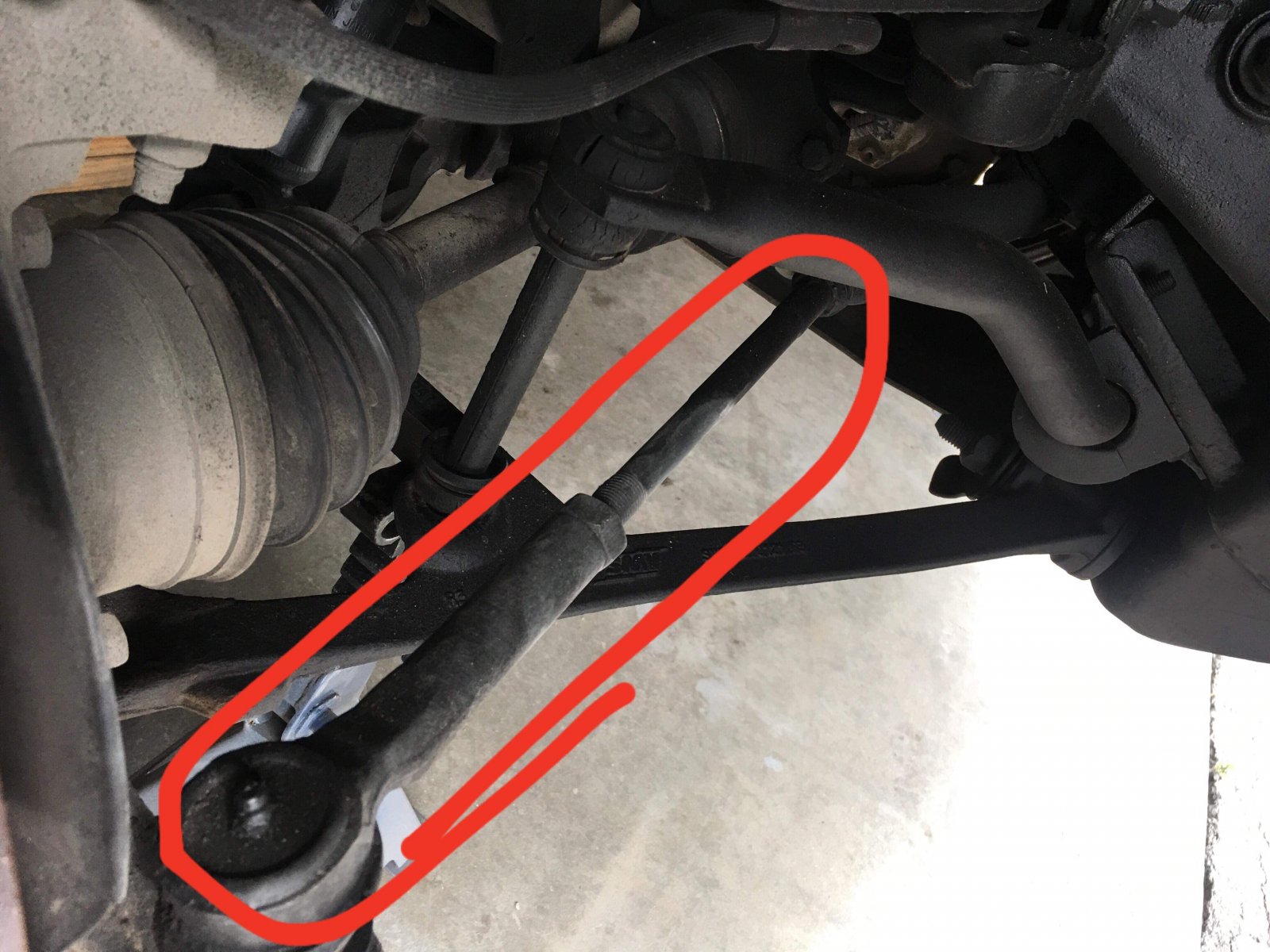

So I only know how to replace stuff that I’ve had to replace, if that makes sense lol. Steering isn’t one of them. I smacked a curb head on pretty hard few weeks ago. The alignment was slightly off but nothing seemed broken. After I put the 26” wheels I think they loosened up what might have been damaged and now when I hit bumps there’s a clanking. Not when I turn though. I feel like its the tie rod. But with it up in the air I can’t mimic the sound. I have a buddy who builds bag trucks that lay frame look at it this week. Fingers crossed it’s nothing too major.

with the wheel on, jack it up, then push and pull at 3 and 9 o clock feeling for play. if you got play the tie rod end is bad.
that sway bar end link is looking pretty dry rotted too.

Yea end link I’ll replace at the same time. I turned the tired left to right and couldn’t make the same sound but the that’s when I found some play. But I’m still curious on sound, could the sound be the rotted end link?
