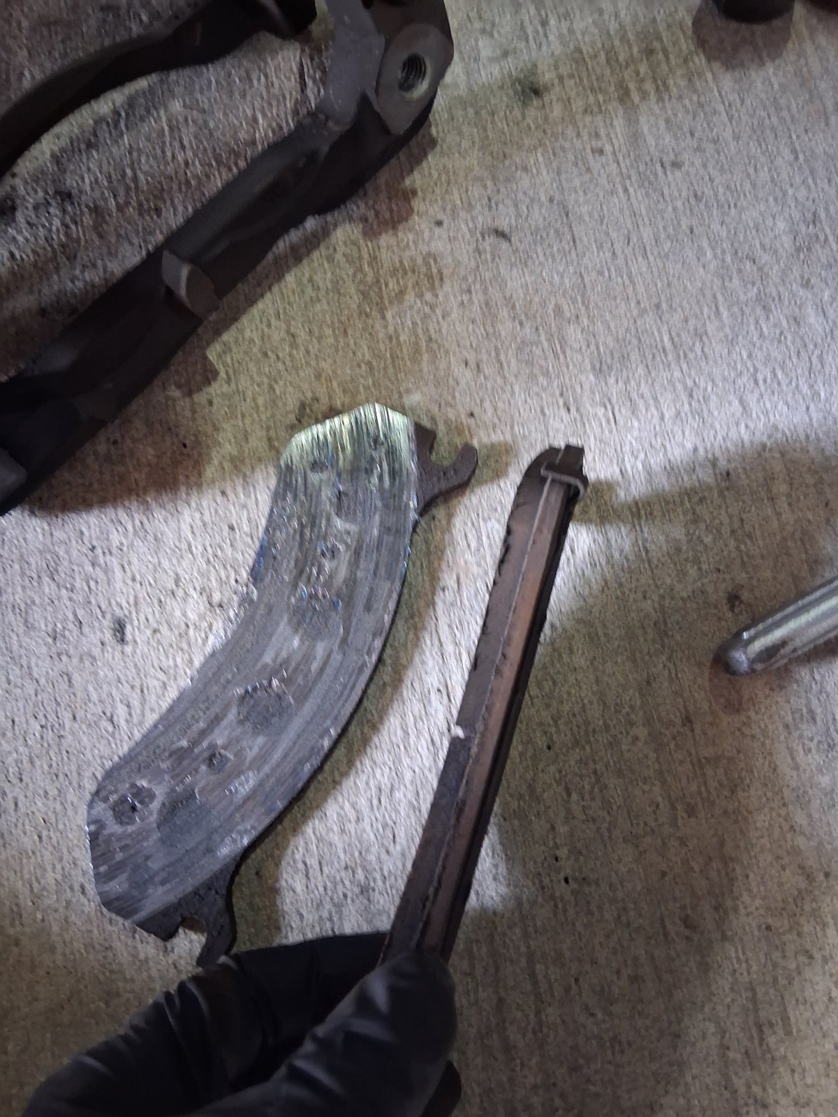

Drove the wifes Denali and thought it had more road noise than usual. Then started to hear a grinding noise when braking, funny thing was it sounded like the drivers side but on the passengers side one pad was down to the rivets, the other 3 all looked the same as in the picture bout a 1/4 inch of pad.
This is the same vehicle that the previous owner/mechanic put a 4 foot long spark plug wire and a a/c condenser from a non rear a/c as replacement parts (I had fun figuring out why my new correct sized condesor wouldn't fit right). I think thier mechanic had a junkyard and just got old parts, wouldn't surprise me if the pads were pieced together from a used vehicle when I got it.
Oh well time for pads and rotors and I think the axleshaft seal is leaking.

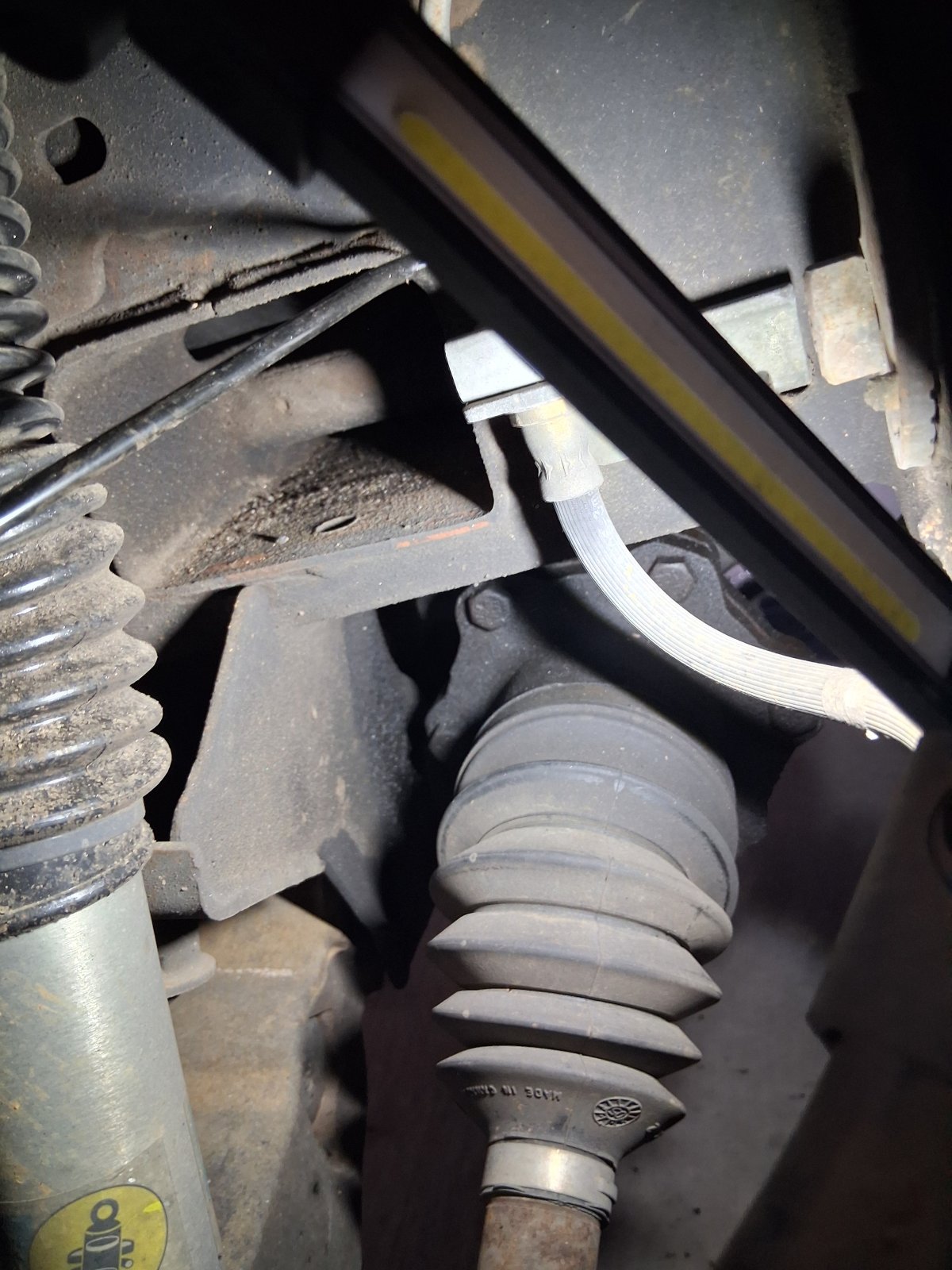

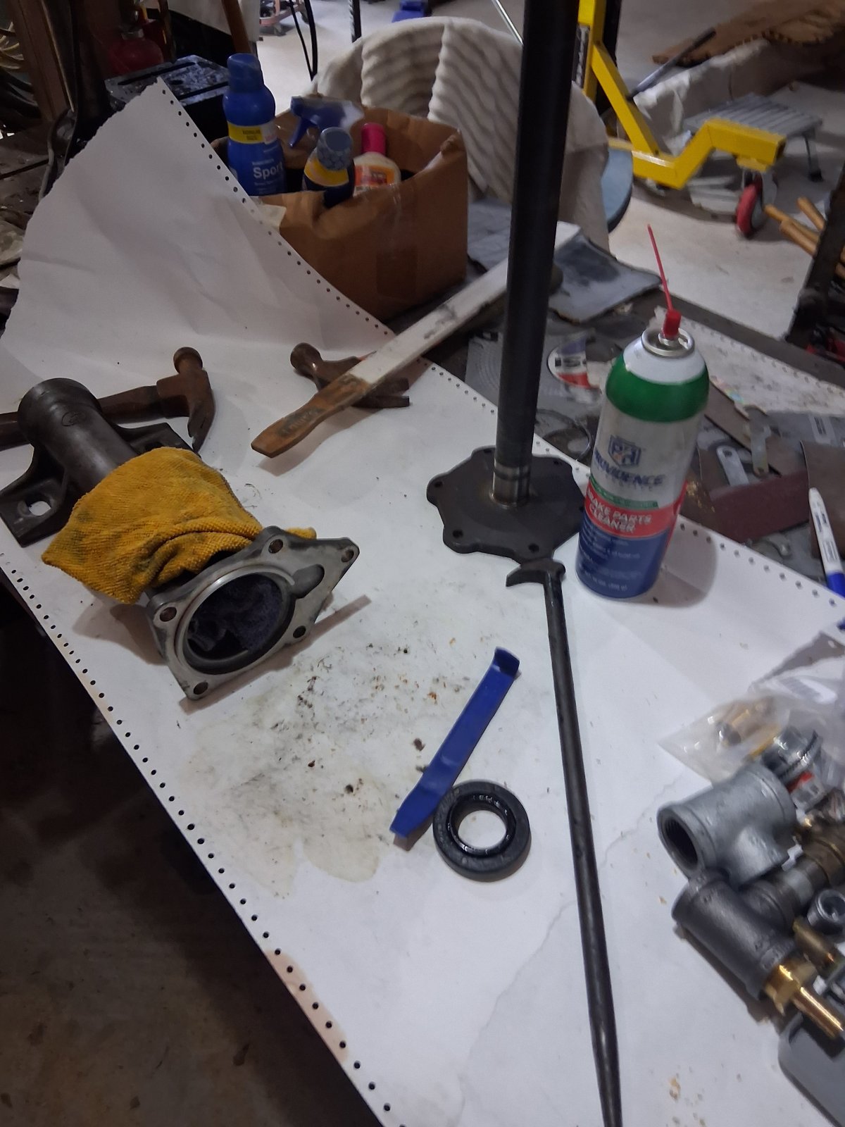

I had taken off the front axle of my Tahoe some years ago and I remember it was short. So I needed to take off the passenger axle of my Denali so I watched some ytube vids to refresh my memory and I wasn't paying attention to the ones I watched were the drivers side (foreshadowing).
So I pop the axle loose and as I pull it just keeps coming out until it's almost out but the shock is in the way. So I remove the shocl, then the sway bar is in the way to I remove the links and pull it out of the way, then the control arm is in the way and I said, no not gonna remove that. Back to the internet I go. So all the videos I could find are of trucks and the axle tube all has springs and washers and stuff in it. So I thought I better put the axle back in so when I pull the tube it all doesn't come dropping out.
Well the AWD Denali doesn't have any of that stuff, just an axle.
The seal comes in tomorrow in the mail and I have to go buy some anerobic sealant since it's aluminium, or at least that's what's recomended.

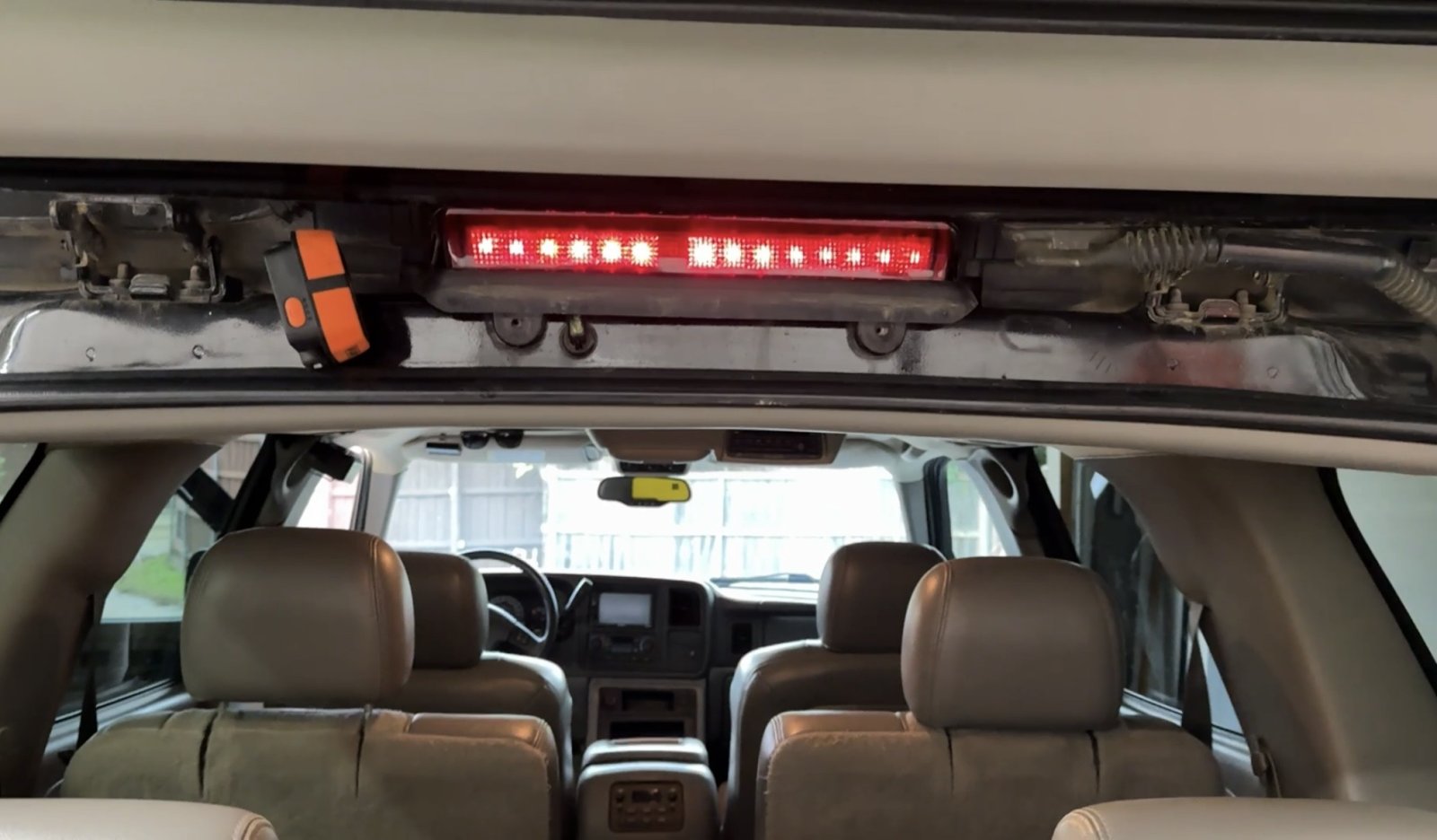

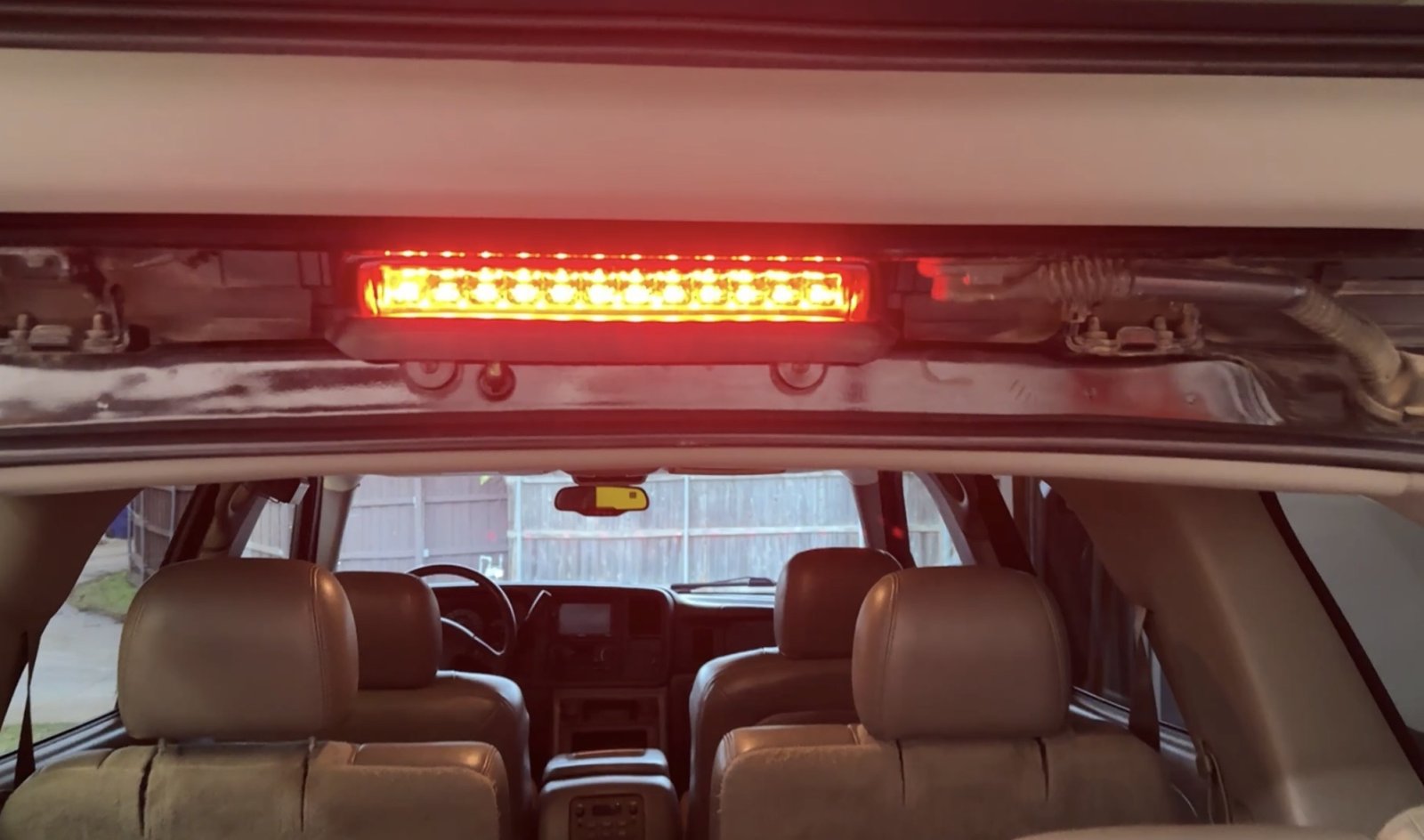

On Monday I replaced my high mount brake light (for the third time, I think) and last night I replaced my factory original turn signal switch (it was turning on the high beams every time I turned on the right turn signal). Cost was $18 for an aftermarket DOT stamped brake light and $160 for a Genuine GM turn signal assembly.

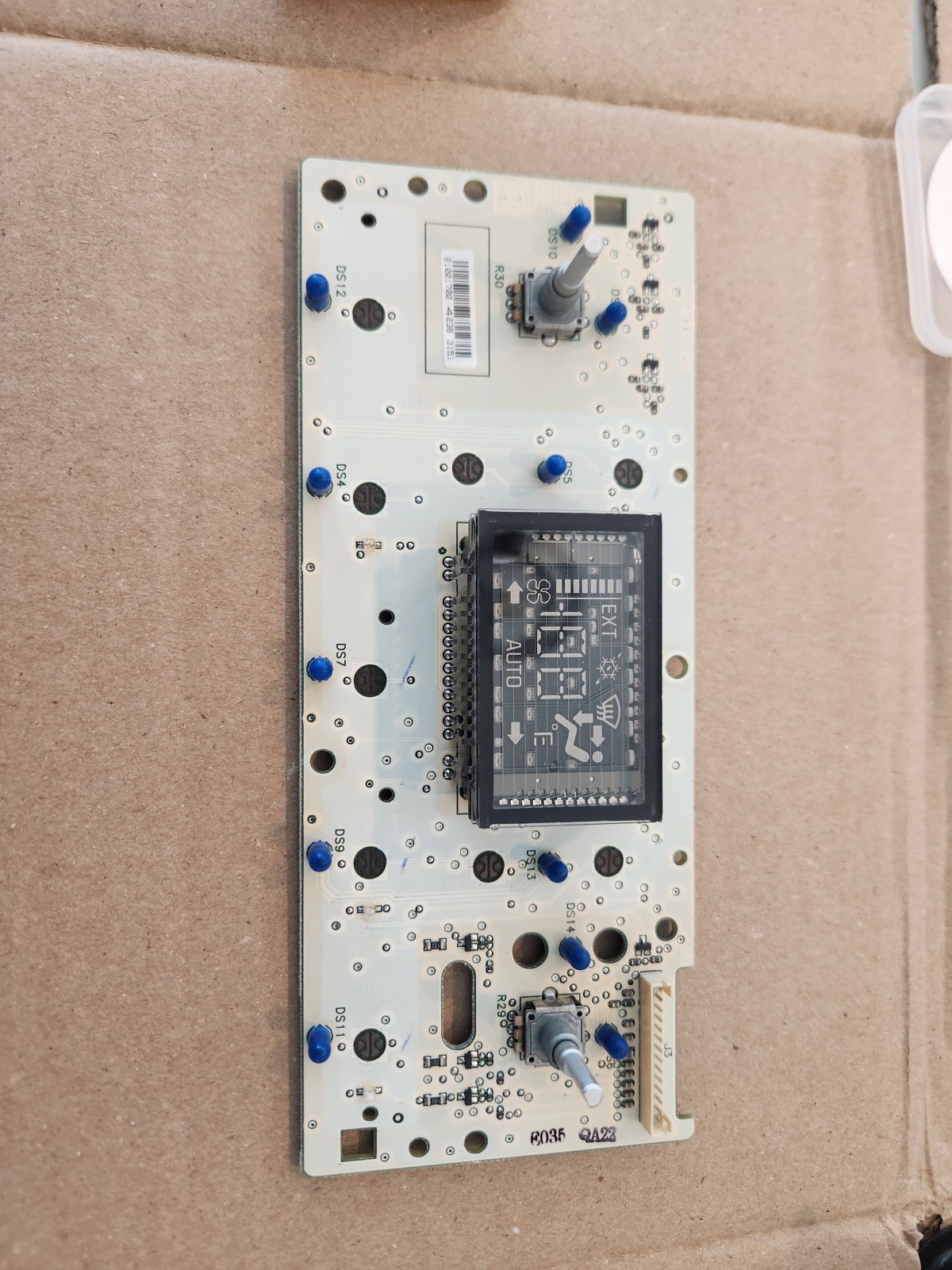

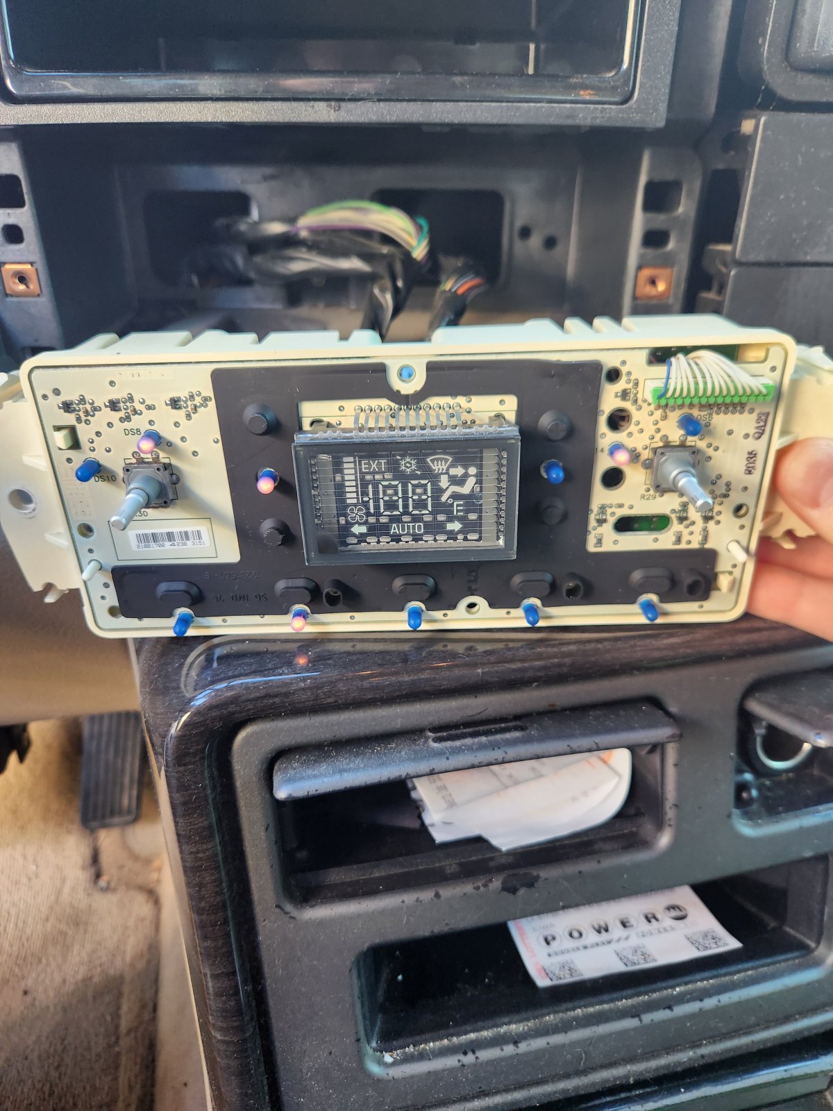

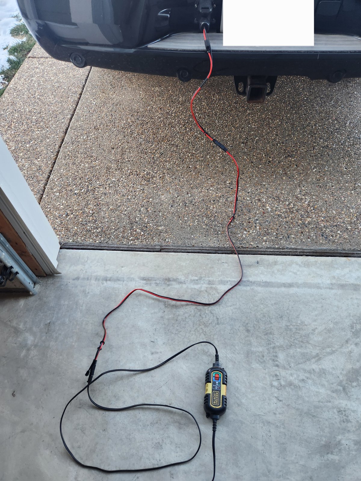

Did a couple things this morning. Finally put together a battery tender that plugs into the trailer plug. Made one for my escalade and one for my Trailblazer SS. No more poping the hood and putting on alligator clamps.

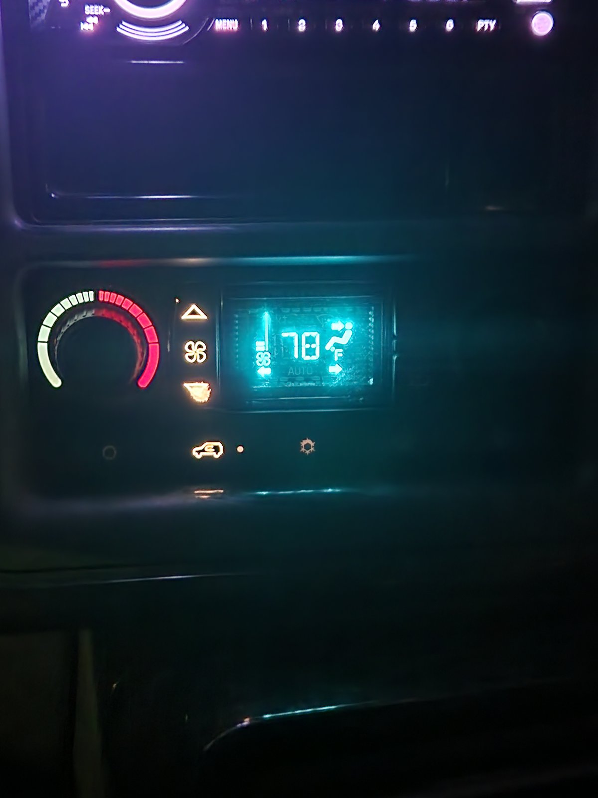

Then I replaced the bulbs in the hvac on my denali. Only 4 worked and it bugged me. Now i just have to wait for dark to really see the results. I didnt take a picture but i did test it before reassembly to make sure i didnt mess up. I ordered 2 kits, will do the escalade one here soon. Its currently only down one bulb, but at 20 years old its only a matter of time.
Did that to mine a few years back: https://www.tahoeyukonforum.com/thr...s-gmt800-tahoe-yukon-today.12502/post-1799713
The "after" pics are a few posts down from that one.

The trickler through the trailer plug is a great idea. How'd you do it?
33,336
51,819
Standard battery tender with an sae plug. Then a 10 foot sae extender and then a 7 pin to sae adapter.
My stuff stuff sits a lot so I keep everything but the daily on a battery tender.
Easy. Use a 7-pin trailer-side connector and wire the tender to the 12v and ground contacts, observing polarity. As long as the connection to the fusebox post for the trailer (hotel) power has been made (and the JCase fuse inserted), the tender current will flow to the battery. That's an "always on" circuit.
I would, however, recommend disconnecting the tender before using the key in the vehicle (on accy, run, or start).

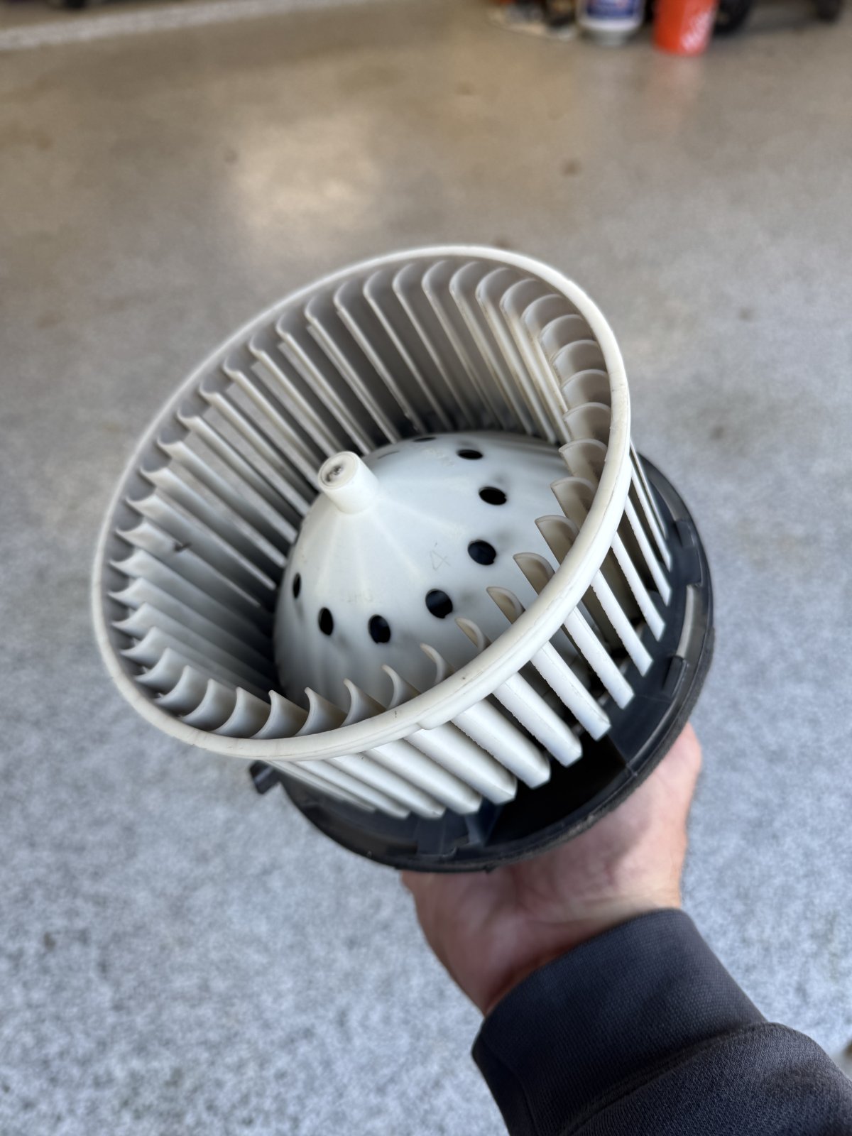

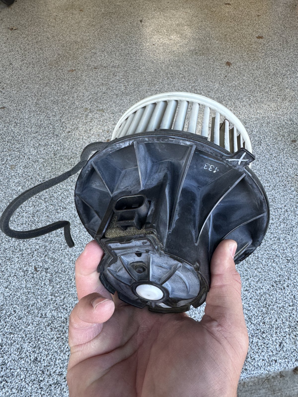

My 20 year old blower motor was occasionally chirping, I assume because the bearings were at end of life, so I changed out the assembly with an aftermarket part. We’ll see how long this one lasts. Not too bad of a project: only took about 20 minutes to swap.
