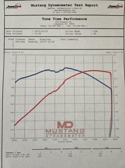

It's like a totally different truck. Even sounds different. Power is there when you need it, there's no surging of the idle--and no idle chop--which is fine with me. View attachment 411300
It was tuned using a Mustang dyno. Looks to be 345 rwhp and 355 tq. Not too bad.

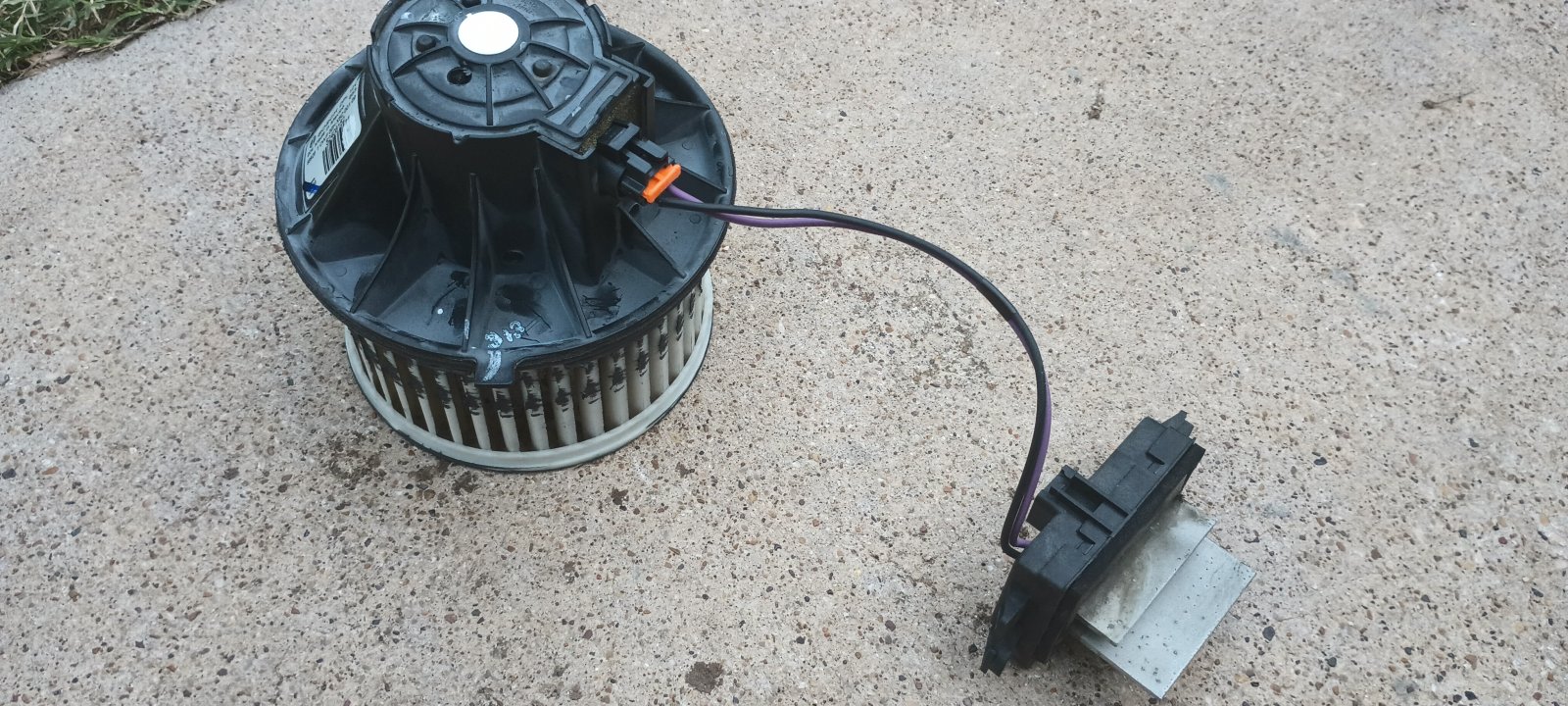

My 06 Suburban had this annoying screeching noise from the front blower when the ambient temperatures dropped, only on lower fan speeds.
I finally got fed up and pulled the motor to find a replacement. Ordered it from RA and was going to be 3-4 days. I decided to drill some holes on the old one and squirt some lubricant while I waited. When I reinstalled it, I must had not installed it correctly because it started grinding badly. By the time I removed it it was melted something off the housing and then it didn't work. Nothing.
Took me a while to find the 40A blower fuse (the ones with the clear plastic lens on top). When I replaced the fuse, the blower would come on full blast as soon as I plugged it in, even with the blower off. It was like if was connected directly to the battery. Doh! I had to unplug the fan when I parked the truck. I figured the blower motor resistor must have melted on the "ON" position internally. So I ordered a replacement from Amazon. Strangely, the ones from RA did not seem to match mine on the electrical connector.
Yesterday I finally got both in the mail. Swapped them in and everything is fixed! Just in time for our cold front.

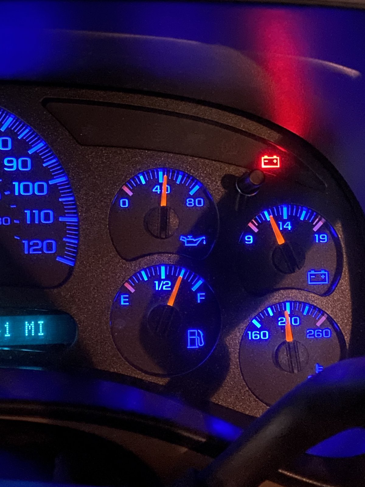

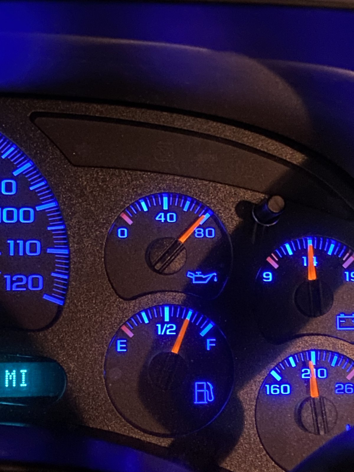

Weird with engine running it’s pegged at 80, but with Key On Engine Off, it’s sitting at 42-ish… good thing I have a backup. Now I just need to find it..

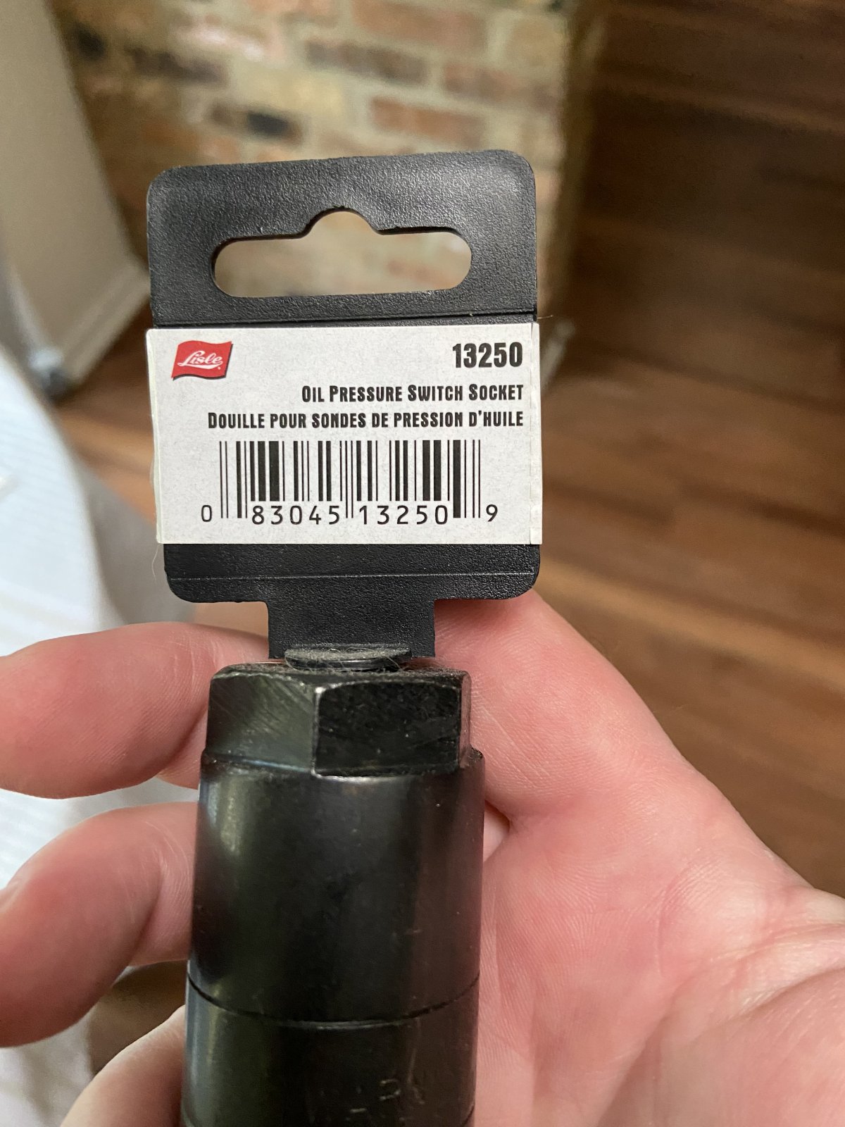

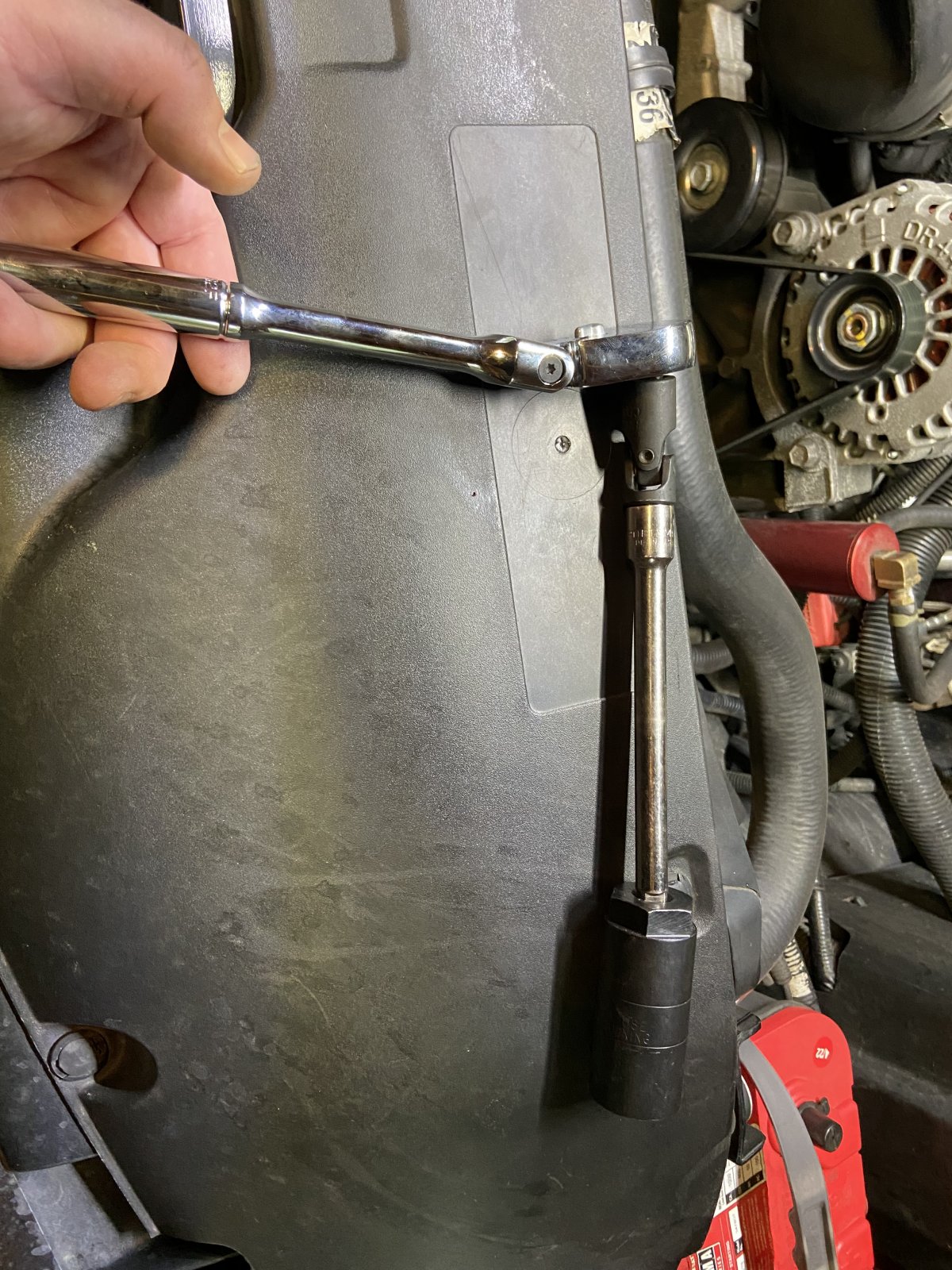

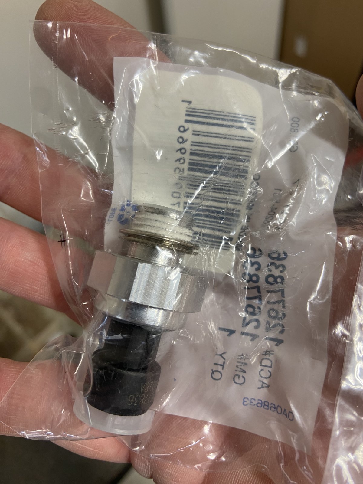

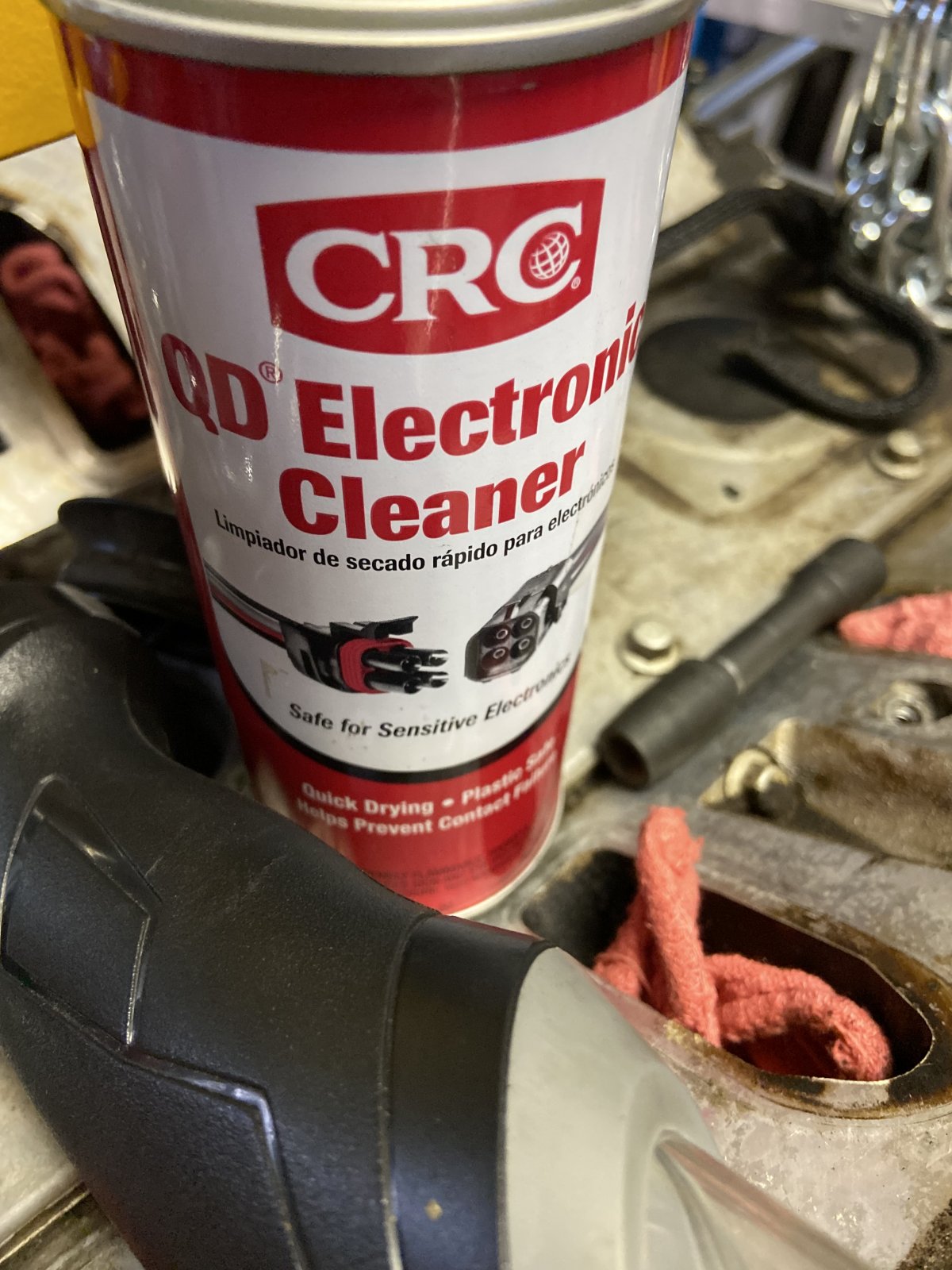

Found my spare oil pressure sensor (12677836), sensor socket, (Lisle: 13250), and after finding the needed combo of extensions and u-joints I got the old one out, and the new one in. Cleaned up the pigtail with some CRC QD electronic cleaner, at the suggestion of @Fless, and we’re back in business. Also discovered my pigtail is missing its latch, so ordered a replacement for that. (Yes, I removed and re-plugged it to test, prior to replacing the sensor). I think I may have got 2-3 years out of this Genuine GM part. I’m hoping it’s at least that long before having to do it again, and my backup is already on the way for the next time.
Have your cluster stepper motors ever been replaced? Not suggesting anything, just curious.
These oil pressure sensors are gonna be the death of us. I "hope" it's the sensor messed up in my van. At idle it goes to 0, gotta Rev it to get a little bit of pressure. The 1st sensor was pegged at 80 also. This new sensor does the opposite.
