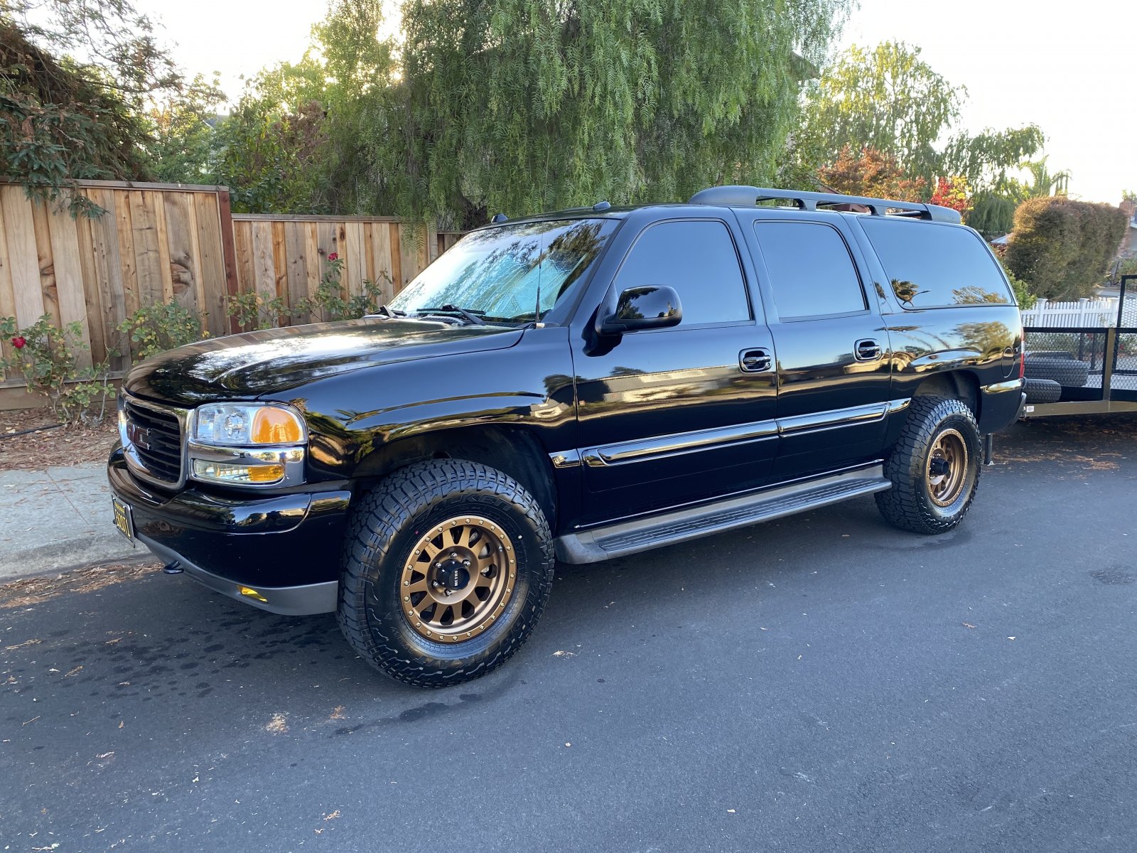

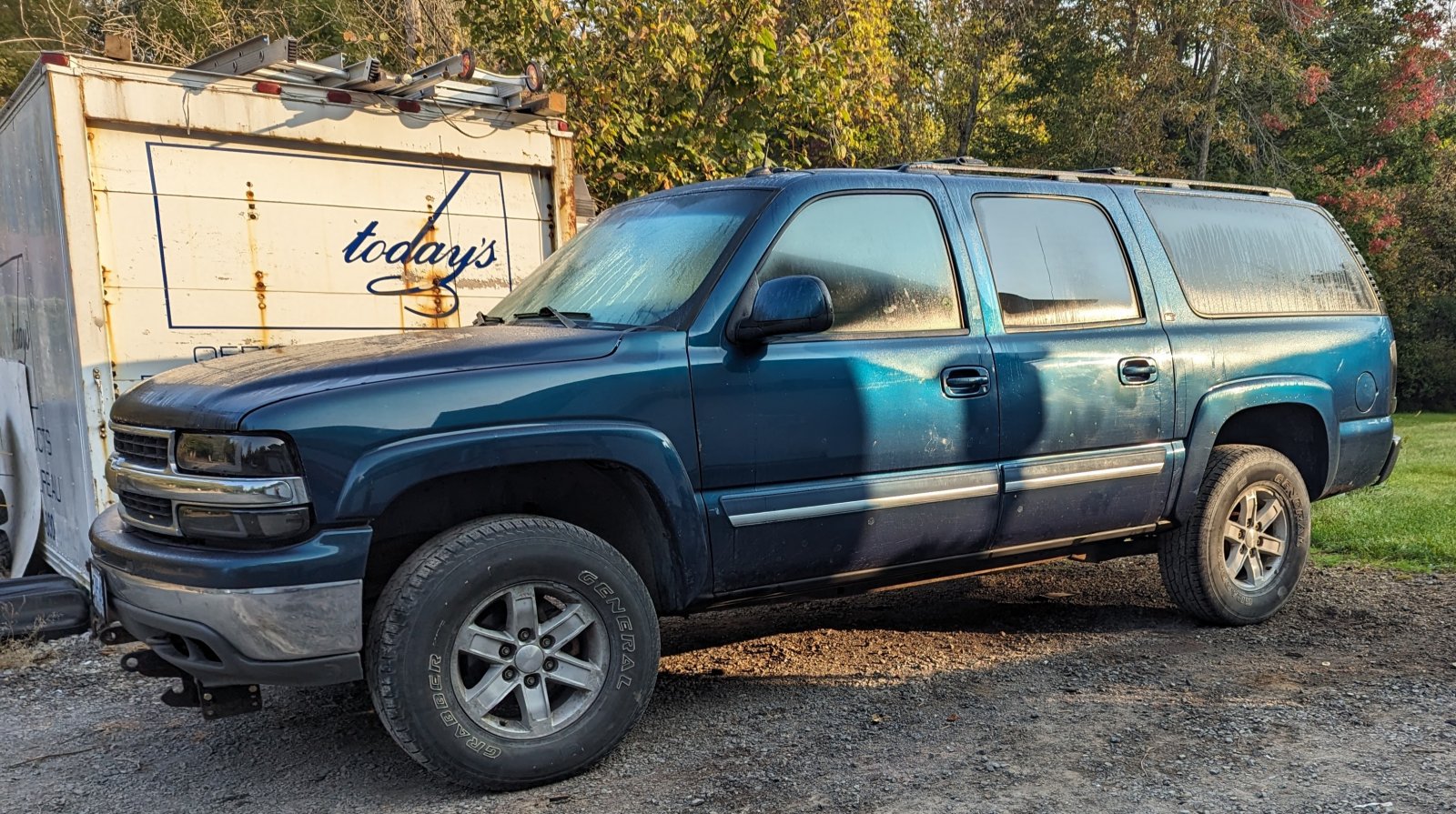

New Wheels and Tires for the Yukon this week. Went with a 17X9 Method Double Standard and Falken Wildpeak AT3/W in 285/70/17. Swapped in some Pro Comp keys and turned the bars up a bit. I wasn't able to get enough lift out of it to not rub. I'm trying to source some lower mileage torsion bars.
cooki3mnster
May 24, 2021
114
169
Weird, these measure 11.5" across the tread and are 32.8" tall. My fender to ground measurements are 36" in front and 37.5" in the rear. There's only the slightest bit of rubbing on the drivers front where the washer bottle sits.
