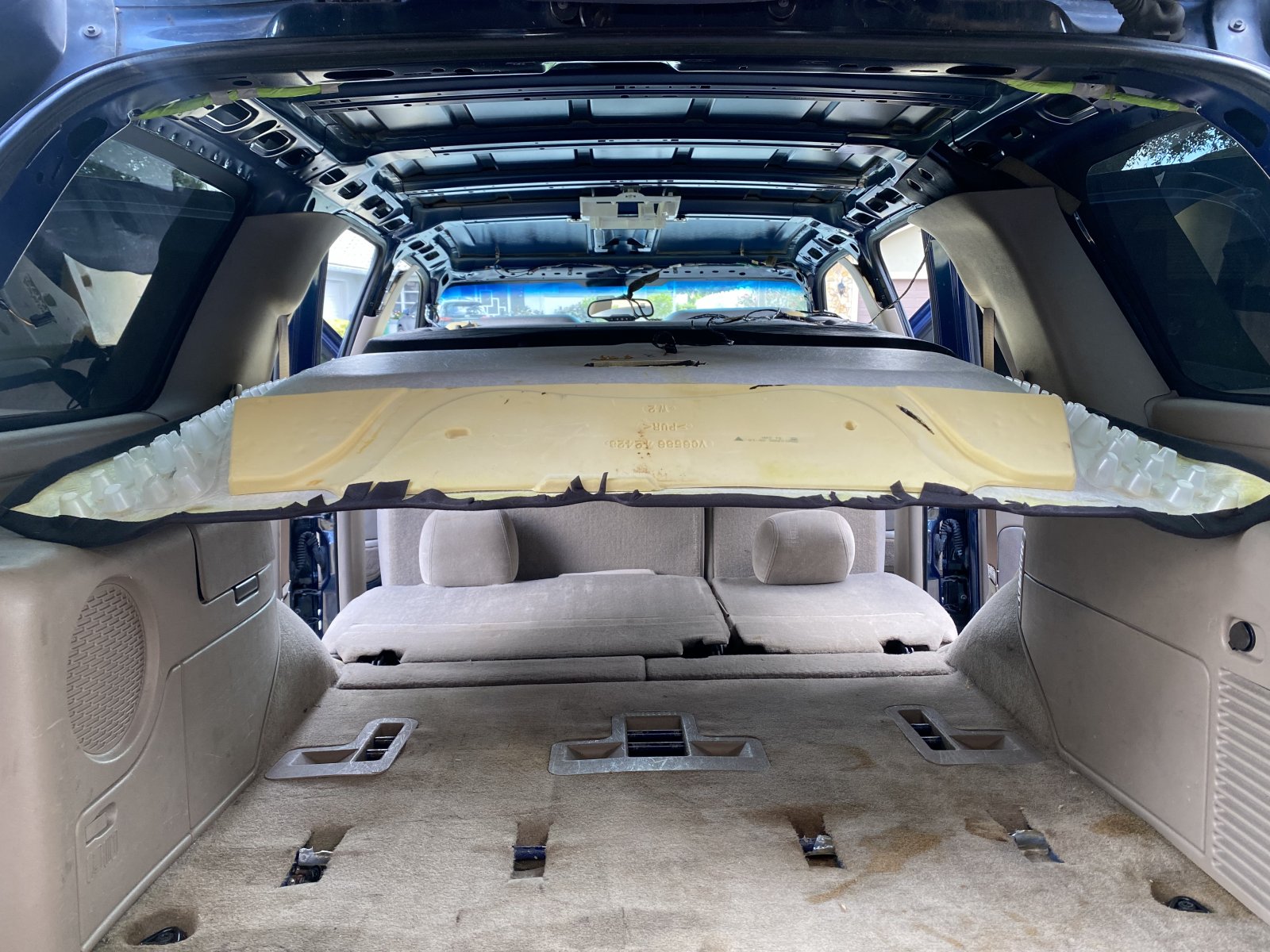

The little finger dimples in the picture smoothed out overnight. Installing alone had me finger punching the liner while installing.
Weakened suction from a vacuum cleaner hose can be used to gently pull out any remaining dents. A soft brush attachment usually works well.

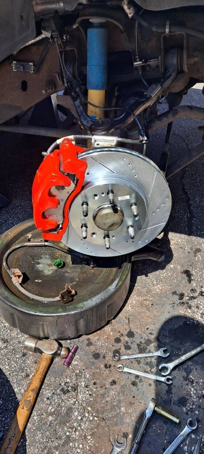

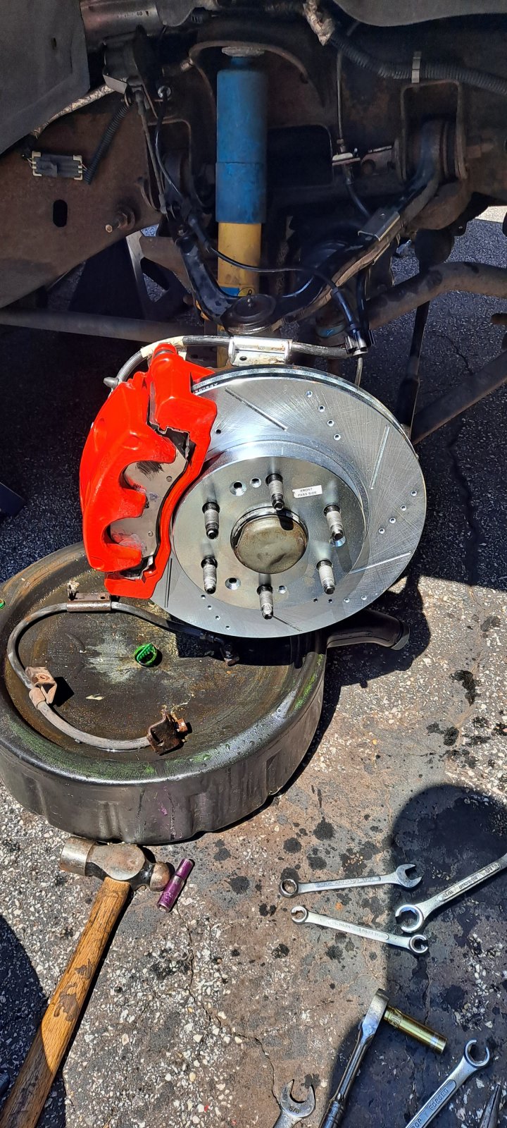

Started my Big Brake upgrade with Power Stop kit (from a 2008) and new GM OEM rubber hoses. I broke 3 bolts (2 on one side and 1 one other that hold down brake hose) and drivers side hose might be permanently rusted to hard line. So i might have to repair last few inches of the hard brake line. Ill be drilling and tapping upper control arm and both knuckles, *@$&*@×&!!! Is the control arm hold down bolt same size as the knuckle hold down bolt?
