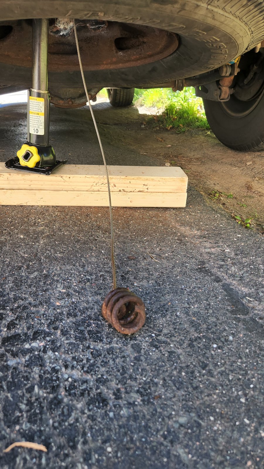

I have faith that I will be able to get the safety latch on my spare tire carrier to set itself free.
Maybe not today... Maybe not next week... But, dang-it! I know, eventually, my tire will come down without cutting something off!
I am willing to wait patiently for the oil to work its magic, so I do not have to spend money on a new spare tire carrier.
Cable looks like new. It was just the safety mechanism that was all crusty. Ok, so the spare tire rim is also a little crusty, but the tire is like new!

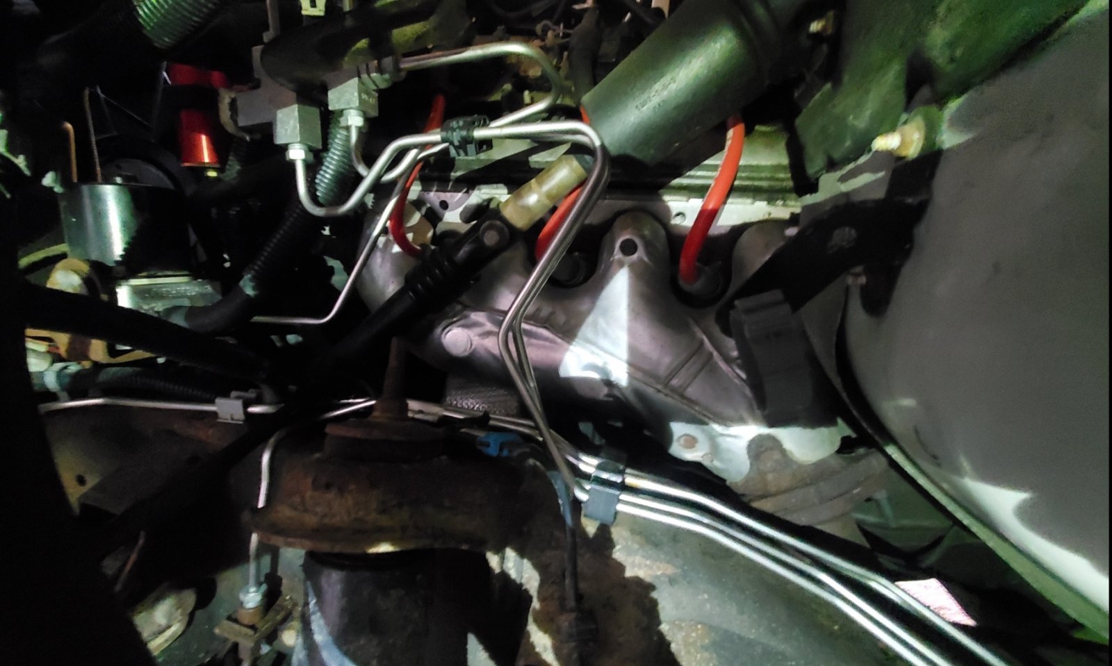

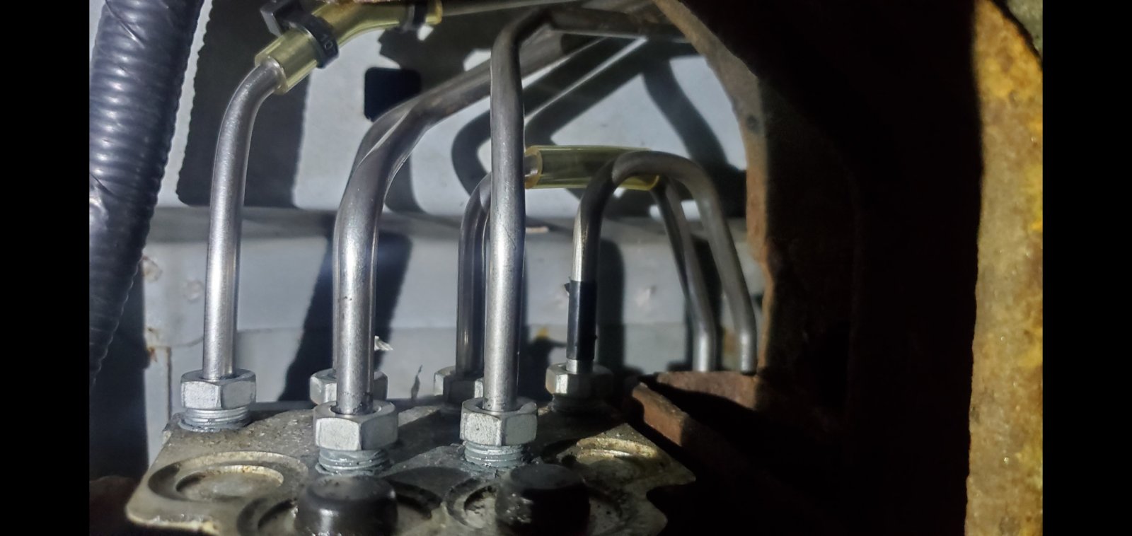

This project occupied my entire past week, but she's finally checked off the big list. Stainless brake lines (the hard ones) are installed!
A few things I learned:
1. Unbolting the 6 body mounts on the driver's side and lifting it off the frame a little is worth it. A couple inches can go a long way (or so I've been told).
2. The Dorman stainless kit is quite nice. I used #919-154 for trucks w/JL4. I would have typically chosen Inline or Classic Tube (not really a Dorman fan), but the idea that they use unions on some of the longer, hard to install lines didn't sit well with me. Pleased with my choice.
3. You can bleed these puppies from scratch without a scan tool quite successfully. I've bled the corners when I did the caliper/rotor/braided upgrade, but I thought for sure the full line redo was going to be my excuse for a Tech2, or at least calling in a favor from a buddy. Nope.
The install is pretty straightforward, but getting the lines routed was not easy. There are a couple of tricky spots where things cross over/under wire looms or each other that require going in a certain order. I took my sweet time, made it a puzzle game, and didn't force anything too hard.
Once my hands and forearms had been sufficiently bled getting all the lines into their homes, it was their turn to bleed. And what sweet revenge it was! A solid win for me on this one:
I started by filling the reservoir, cracking the 2 output lines each a few times with the pedal down to at least get the MC primed. I found that this method is actually in my GM Service Manual, as well. Then I just did an old school gravity bleed all the way around. 4 jack stands with all the wheels off and a patient assistant helps get fluid through 17 miles of brake lines. I did use the patented @iamdub "2X4 on the floor and cycle the key a bit while pumping" method.
Next, since I hadn't removed the MC to bench it and was now at the front drivers wheel anyways, I bled the MC for real by running a line from the caliper bleeder up into the reservoir and pumping the pedal until I had a full closed loop going. Worked like a charm!
The pedal was getting there by this point, but not firm by any means. I knew it had to be the ABS module now. Of course a scan tool does this, and we've all heard the "slam on the brakes on a gravel road and then bleed it all again" method. Yuck. I opted for the "Well, it's already on jack stands..." line of thought.
THIS IS NOT A RECOMMENDATION, BUT RATHER SIMPLY AN ACCOUNT OF WHAT I DID!
I put that baby in 4WD, got her up to about 20 mph and "activated" the ABS really well a few times. I did get a front left wheel speed sensor code doing this and I have a couple of ideas why, but I just cleared it when I was done and it never came back.
I then did another trip around the truck by the usual means and got quite a bit more air from each spot (along with all nice new clear fluid). Pedal firmed up at least as well as it was before I started this whole thing. I will likely see if there is any more to bleed in 5k ish next time I rotate tires just for grins.
I DID:
Be my usual self and go a little overboard on a couple of OCD items like sleeving polyurethane tube over the lines in some spots where they crossed or could possibly contact the frame or other metal, including each other. I also added a few of my own 2-line routing clips that we use in the shop on 1/4" refrigeration lines where I felt the factory support was lacking or worn.
Take my time, enjoy my music, complain alot, work hard, and do a job that I can sleep well with in the end.
I DIDN'T:
Do the jounce hoses or the two hard lines along the rear axle. I know, I know, all this and then didn't do the last 4 pieces! But before (or after) you all give me a hard time, I did have a reason. I was very busy leading up to this job and forgot to hound Goodridge for my "fixit" washers after emailing them to no avail. Is there a tried and method to obtain these? Should I just call them? This will also give me another reason to do a sway bar upgrade and clean some other stuff up back there.
Okay, here's some mandatory pics...
The Old and the New:
Before and After:
They're in!
Well, that's about it, I think! A job I knew was inevitable and avoided until it forced itself upon me! Feels good to have it (mostly) done!

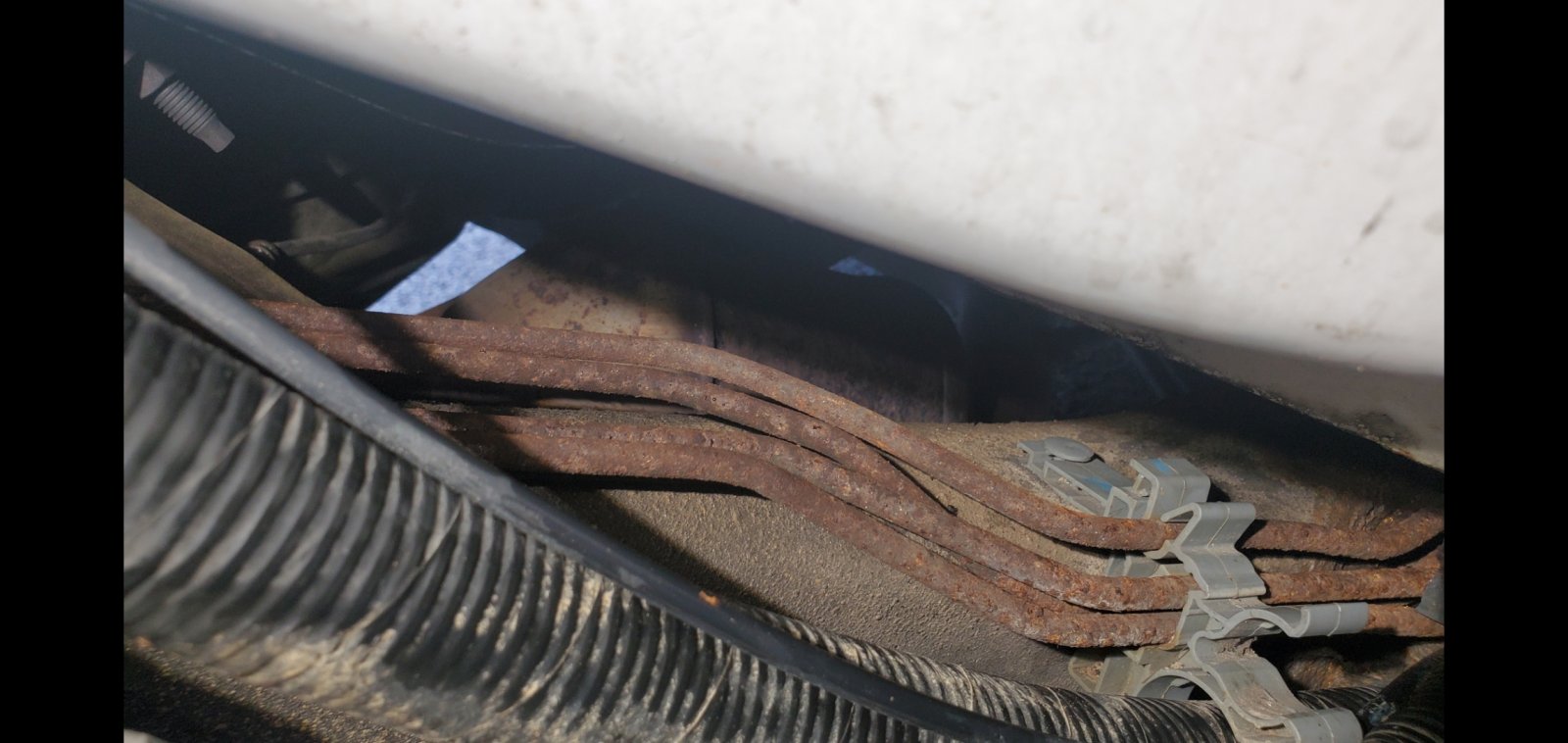

Fantastic! I see the rust. As rusted as those lines are, I am surprised that the lines are not twisted inside the fittings after breaking loose. Love them line wrench tools of any kind. Thankfully I don't have to deal with that. This brake line swap is one of the next items in my line of things to do but have had an impossible time finding a kit for the traction control rigs. Any suggestions from anyone? Be aware, if you are not already aware, I do not want just any hard line kit, I want quality for this time consuming job. Cheapest is not always best for me.
The kit I used was Dorman 919-154. It is for the JL4 trucks. I was pleasantly surprised with its quality.

Did you do anything to address the rust while you were in there? It looks good -- mostly scale, but I thought an antirust product might help out.
I did not. I need to. I plan on addressing it a bit while doing a suspension refresh. Any suggestions?

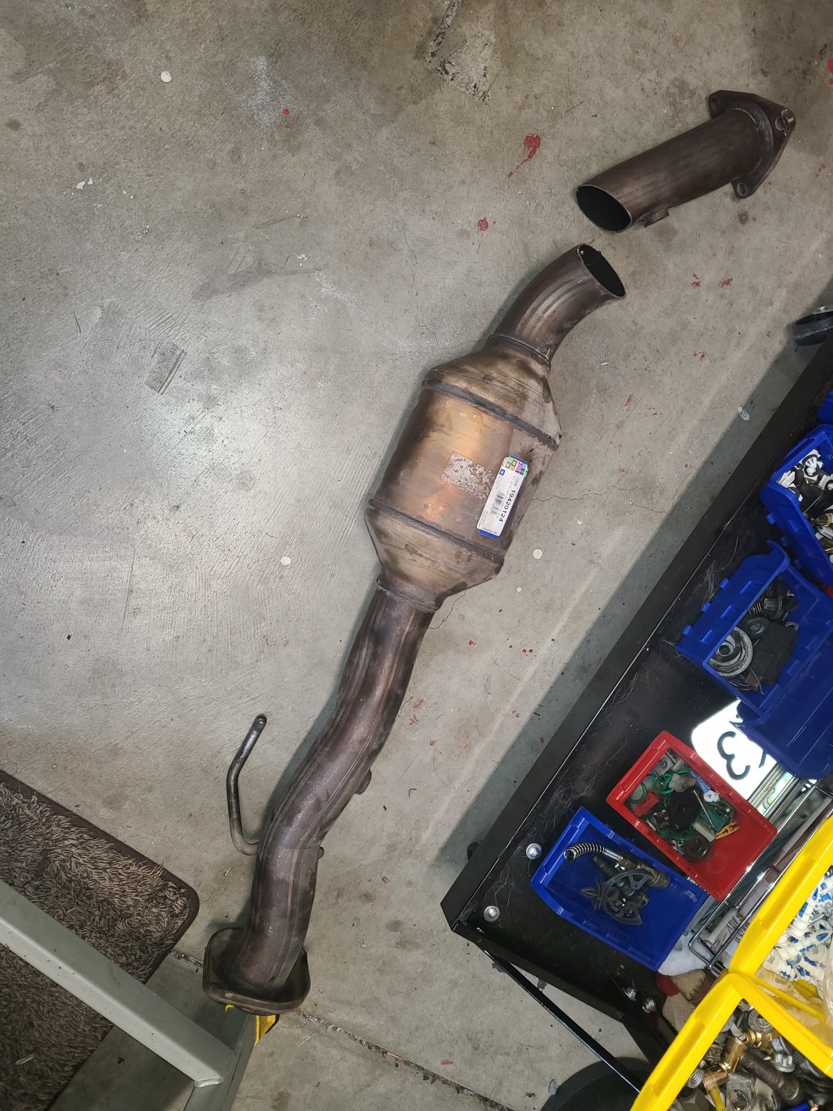

Also, 2 weeks ago the "Replace your engine" light went on. P0430. Bank 2 catalytic converter died. Downstream O2 sensor readings clearly indicated that. I replaced it with the brand new OEM converter. That was not cheap!!!
The removal of it was not too difficult, but still a PITA. Of course, one of the manifold nuts didn't want to cooperate, so I had to cut the converter and remove the exhaust manifold as well.
But to put back the new one, that was a struggle!!!
Now everything is sweet, the catalyst monitor is completed and I am happy!
