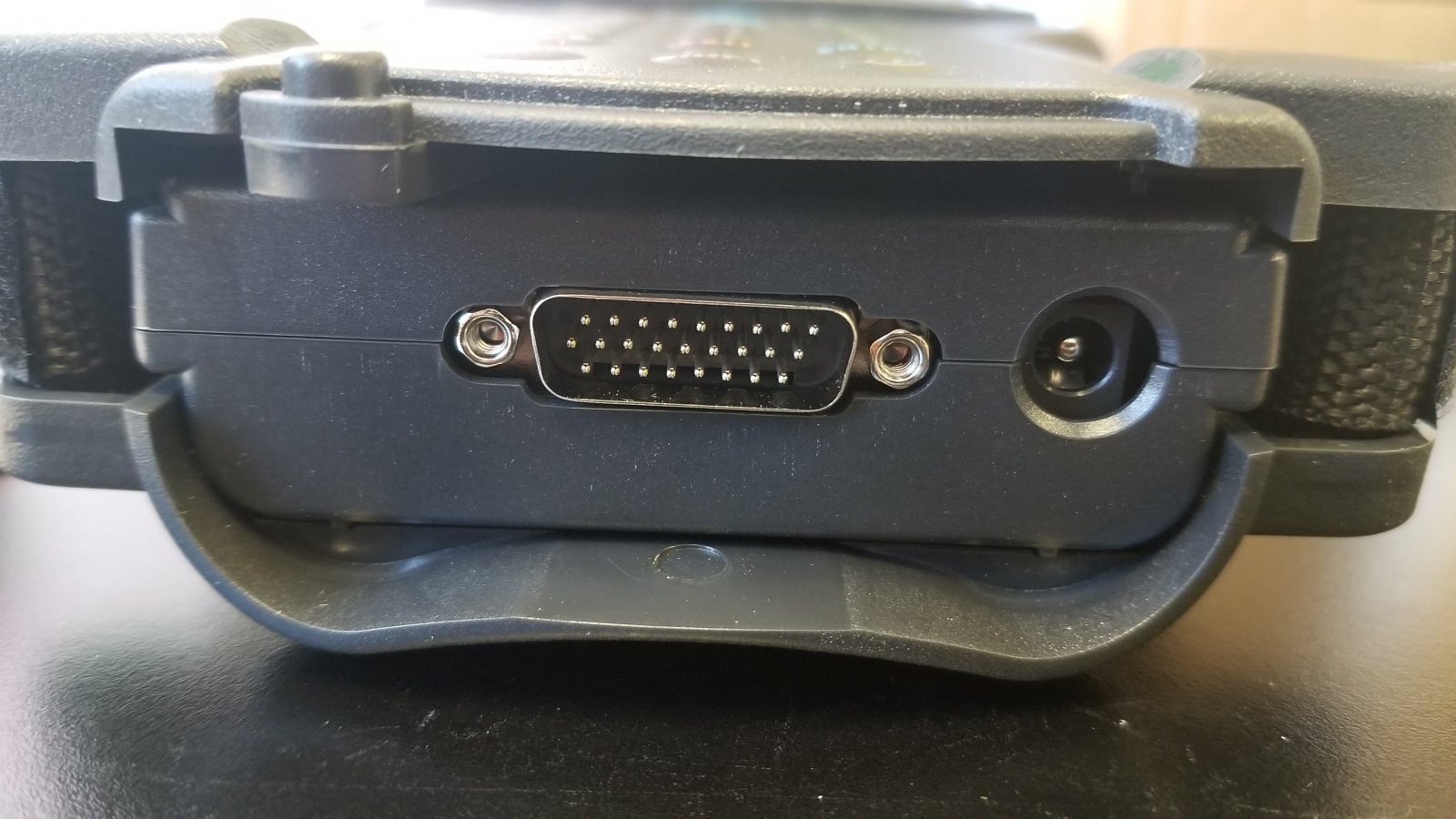

my 1st guess is the 12v supply they were using was either not enough amperage or was defective or was not plugged into the correct place.
if you look on the tech2 on the bottom edge there is a power port plug, that is where you plug in a 12v dc power supply.
when I plug 12v dc to my clone tech2 in that location it does not reboot or shut off when the key is turned off or when the engine is started. I bought mine around 3 years ago.
Thanks! You are probably onto something with this.
The guy in the video had the 12VDC supply was plugged into the port on the cable...
Not on the port on the bottom of the head unit...
If using the port on the head unit prevents the voltage drop from causing a reboot when the engine cranks, then I might have wasted $11 on the Ebay switched extender.
Maybe mention of this in our discussions will actually save people from thinking they have to buy that cable.
Anybody want to buy an unused switched OBDII extender cable? LOL
Follow-up: Vetronix instruction book says 12VDC "To ensure proper ground, power tester through the DLC power jack, NOT the power jack on the Tech 2". They are referring to the port on the cable for proper ground... However, that is showing the 12V power being fed from the 12V cigarette lighter power cord. Use of the AC to 12VDC power supply would be properly grounded (one would expect) at the wall outlet, so it can feed directly to the power port on the bottom of the Tech 2 device.
that's also assuming a properly working tech2, the clones have the voltage defect, using a dc power supply is a easy work around, you really only need it if you are programming a module or doing a evap test, etc normally just for reading codes or troubleshooting it's no dig deal.
Sorry! I didn't intend on hijacking the "What I did to my NBS today" thread and turn it into a Tech 2 discussion!
Maybe the guy on Youtube didn't actually follow the directions. He plugged the AC-DC power supply into the DLC, where the Vetronix manual shows use of that power source from the house goes direct to the port on the Tech2 instead of the port on the DLC cable.
Vetronix did want direct 12V power from the car to go into the port on the DLC, but the house one goes to the Tech 2.
At some point, I will be using it for an EVAP test. So, not rebooting will be nice. Probably good to go, if I just plug into the port on the Tech 2 instead of the one on the DLC cable.

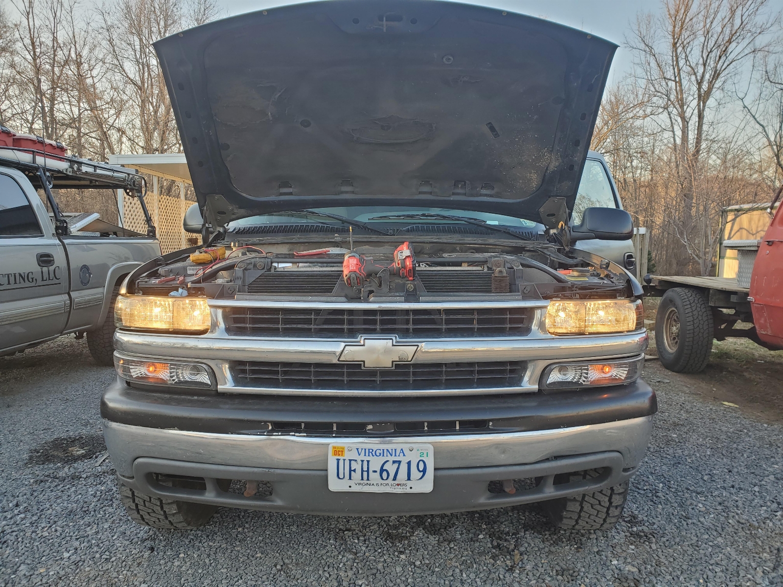

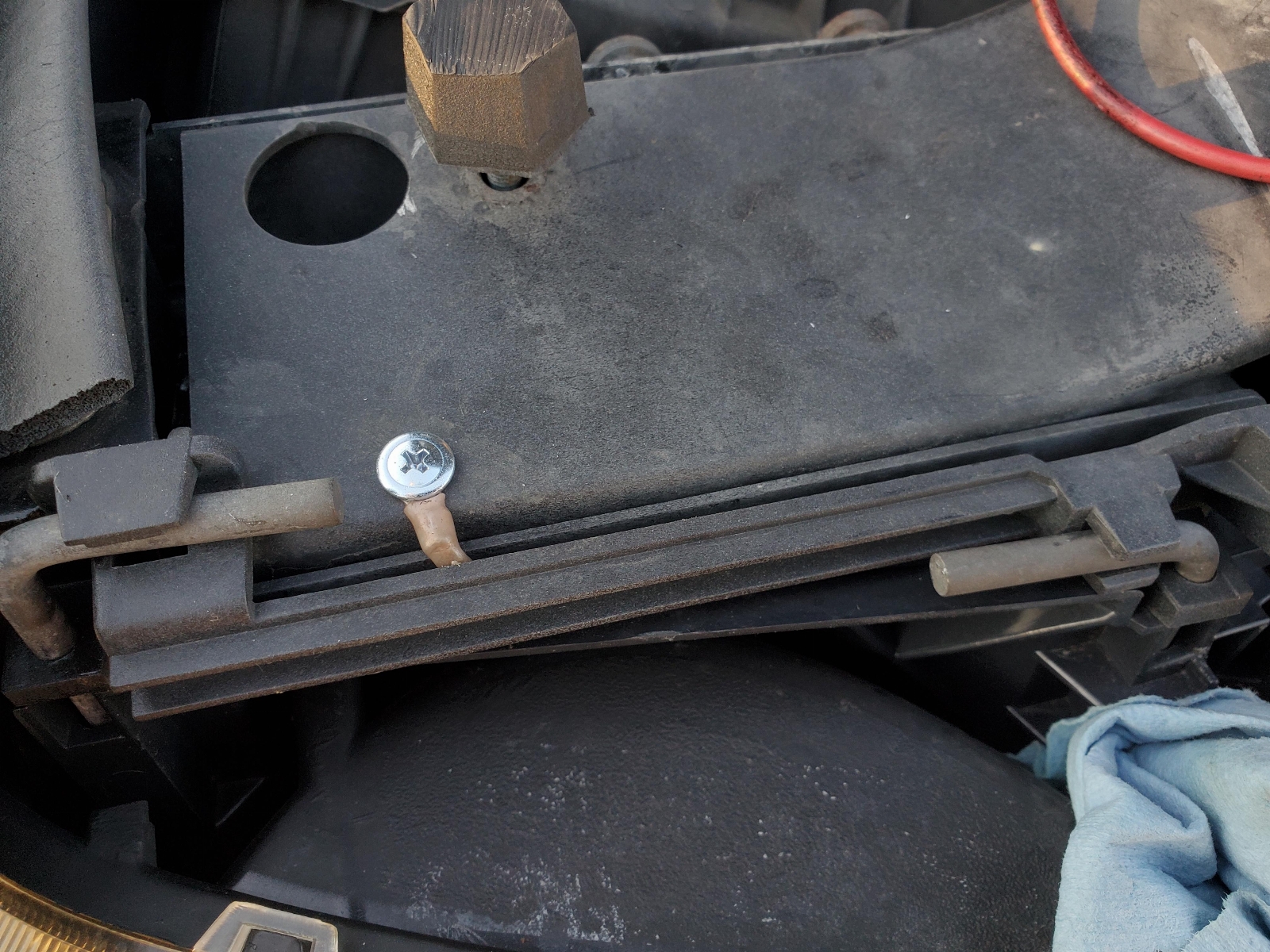

Did the high beam/low beam mod today, grounded the yellow wire on each low beam with a nice little heat shrink eyelet. That should be a major improvement.

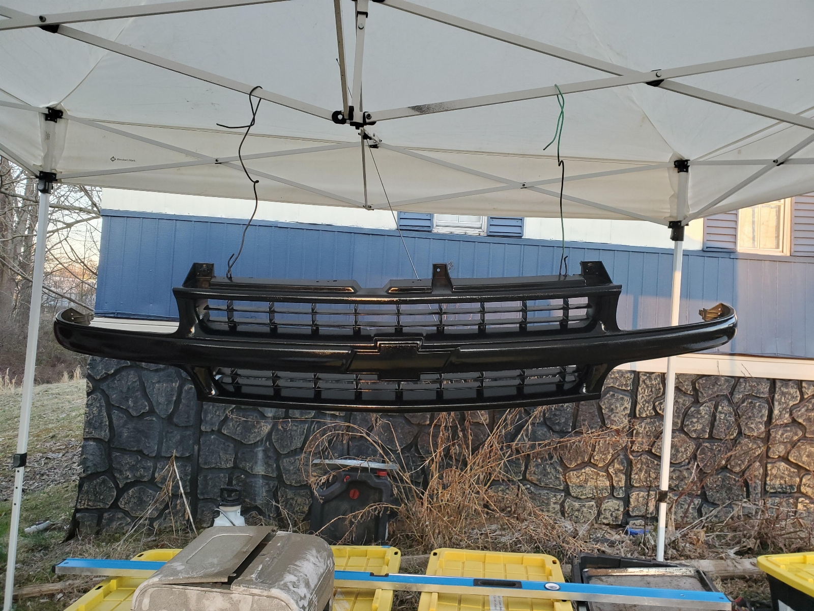

Also spray bombed a crappy spare grill I had (off a parts truck that the PO had spray bombed the whole truck.... poorly) to see if I want to switch over to the black grill. Thinking I'll like it. We'll see once it dries.

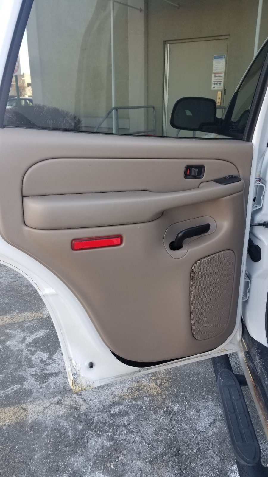

Same as mine. I want to say model year 2003 was when they ditched stuff as well as changed the communication bus for the various modules.
Mine’s a 2003, and I have the light-up markers in all 4 doors, but no footwell lights. -That was I believe my very first “mod”, after replacing some other items like broken OEM headlights.
What’s the “high beam / low beam mod”? I took the easy route, and installed a fleece all-on module, which allows lows, highs, and fogs to all be on at once when using high beams. Is that what you did?
grounding the low beam to the body allows the highs and lows to remain on when the highs are switched on, easy mod for 00-02, not sure if it works on 03-06 they made some changes. I had my 00 modded for 6 high plus 2 more fogs I added for a 8 high lol
