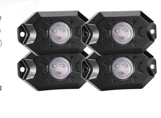

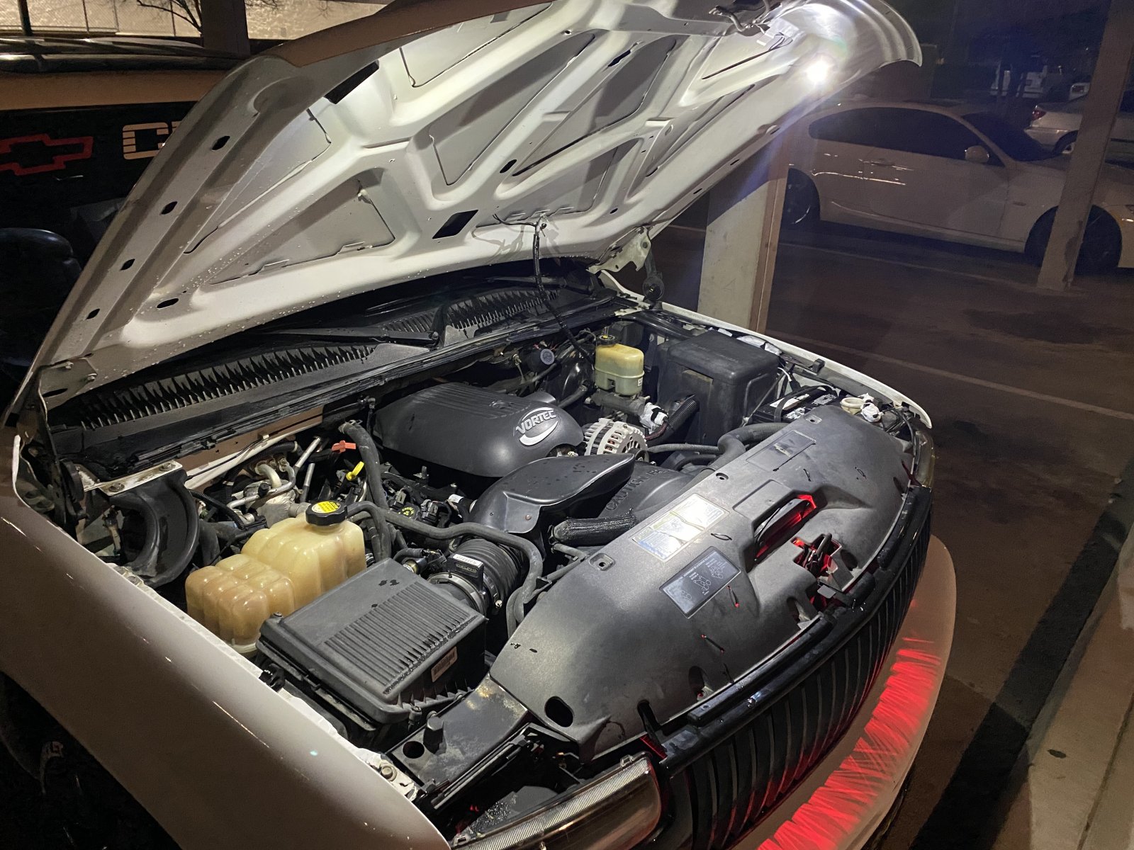

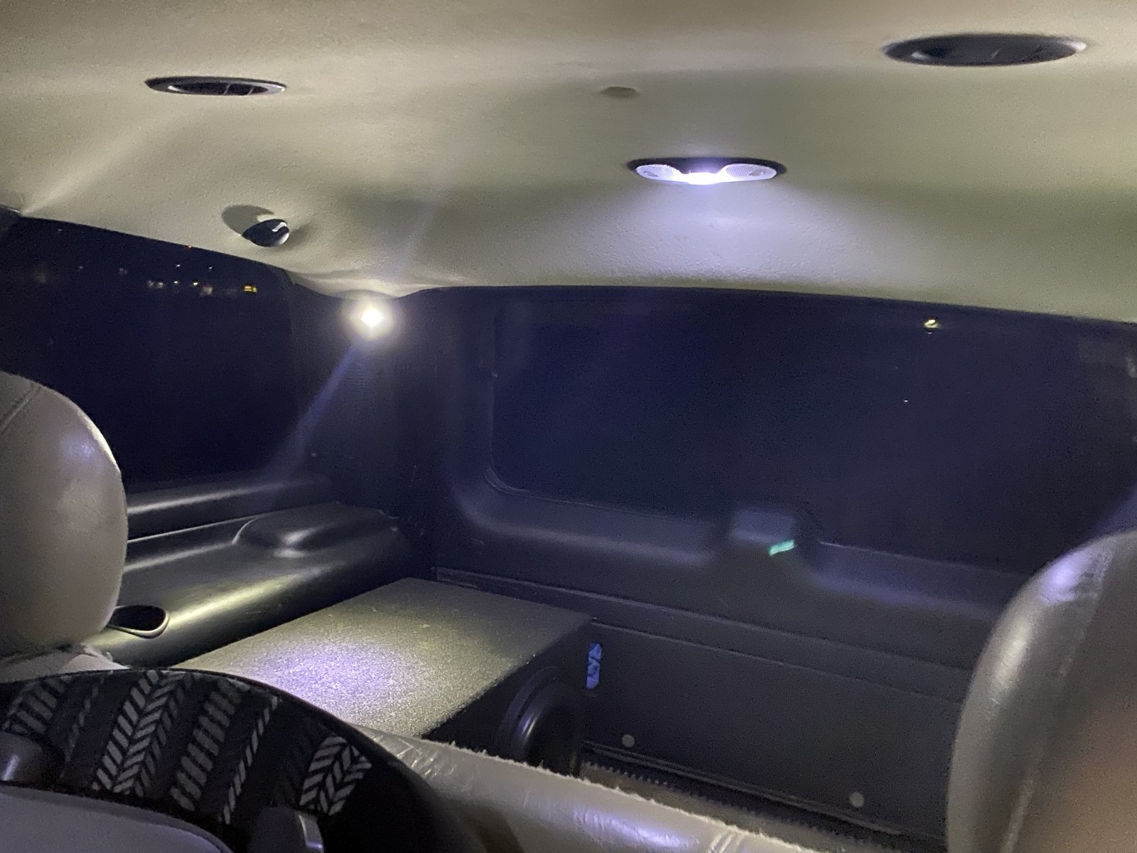

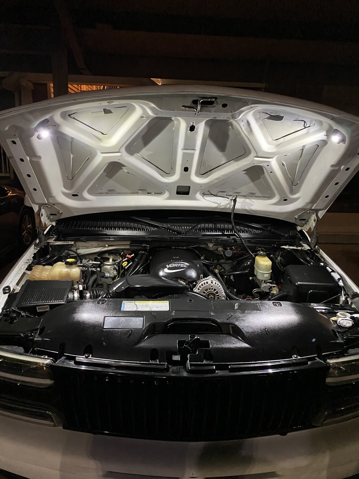

I got tired of having to pull out a drop light I figured I would just ditch The original one and reroute wiring to These LEDs… Then the interior cargo area wasn’t bright enough either so tapped into the back cargo light so they come on when doors open.
View attachment 361947View attachment 361948View attachment 361949View attachment 361950
Awesome!!! What a major improvement over stock lighting! As soon as I have an opportunity, I hope to get that upgrade done. Recently, I have had to deal with basic things like brakes...

What lights did you use for that, were they the puck style? Maybe post a link if you have it. I had done my under hood with LED strips all the way around. And also used them under my doors so when I open my doors they light up the ground, like puddle lights but way more. The ones under my hood had a hard time staying glued on due to it slamming in a downward motion. Eventually I removed those. The ones on the bottoms of my doors are still attached and working after several years.

Could apply silicone sealer in spots or applied to the back of the strip... Heat resistant, flexible, amazingly strong hold on things, but still not permanent if you change your mind. That might be an option, if you don't want to redo the whole setup you have in place.

Yeah I did that a few times in the places that the original high strength peel and stick failed. I cleaned with alcohol, and final wipe with a clean dry cloth. It became a constant issue and I decided it wasn’t worth it. Silicone started failing too. Seemed to not be so amazingly strong after all.

AutoZone has the style lights and I basically whatever I mount a damn scratched it up with some 80 grit sandpaper right underneath and use the tape that came with and also some crazy glue and I have no problem at all

I used GE silicone to hold a wood panel on the back of our kitchen stove, where it stuck up above the counter top. Couple globs on the back held it for ten years. We sold the stove and removed the wood trim piece. The silicone is still on the stove, along with bits of wood it tore from the back of the board.
But, I get it if what you had wasn't working out for you... I like the lights @MADPINTO08 used! Lights everything up like daylight!

That’s different than gluing two smooth surfaces, especially if one is painted. Plus the hood slamming closed a few hundred times shakes it loose. I’m familiar with silicones, I used them in the glass trade all my life. There are structural versions but they require a primer and there’s a list of different ones to use on different materials along with the different primers. And they’re only commercially available. I just wasn’t really into the underhood lights so much that I wanted to put that much effort into them. I figured I’d get something that I can use a mechanical fastener on. I never got around to it.

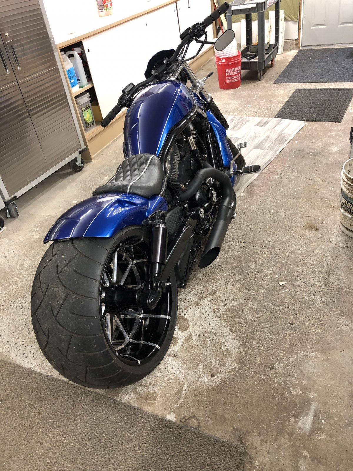

I remember a few years back in one of the games there was an appearance by a Harley-Davidson V-Rod and my friends in my riding group which were mostly V-Rods got all excited. And only owners of those bikes would even know because nobody else even knew the V-Rod existed and they are a unique looking bike design. We used to say they are the red-headed stepchildren of the Harley world. The “true” Harley riders shunned them because the engines were water-cooled 60* V-twins that revved high and Porsche helped with the design and engineering. Probably why Harley quit making them a few years ago.

Question. Did you remove the insulation from your hood or is that how you got it?
52,949
I put an HD hood and when I painted it to match I didn’t wanna transfer my old one because it was ugly so for now just not running one
And they’re not cheap. I remember back when I bought my bagged Silverado it was missing and when I went to buy a new one I was a bit shocked. I don’t remember what it was but I do remember I had to really think about it for awhile.

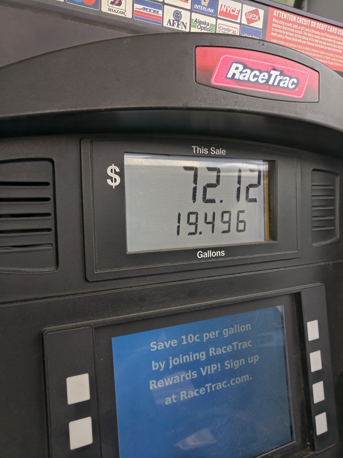

Dallas - Ft. Worth metro is likely shutting down tomorrow night due to an ice storm and temps below freezing until Saturday. Decided for the first time ever pre-weather event to fill up the tank. My parents live 25 miles away so I just want to be able to go help or get them if needed.
e85 @ $3.69. I know I shouldn't complain since you coastal guys have terrible petrol prices, but this is Texas! LOL.

Whoa!!! Here in Western MA... Only $2.94 at the local Costco.
