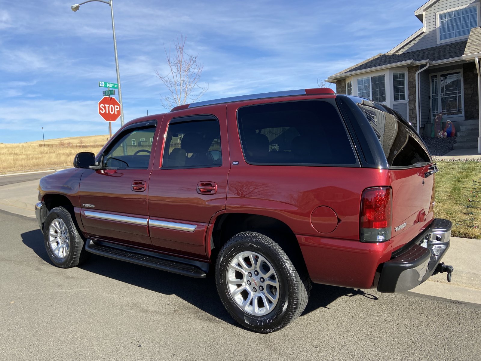

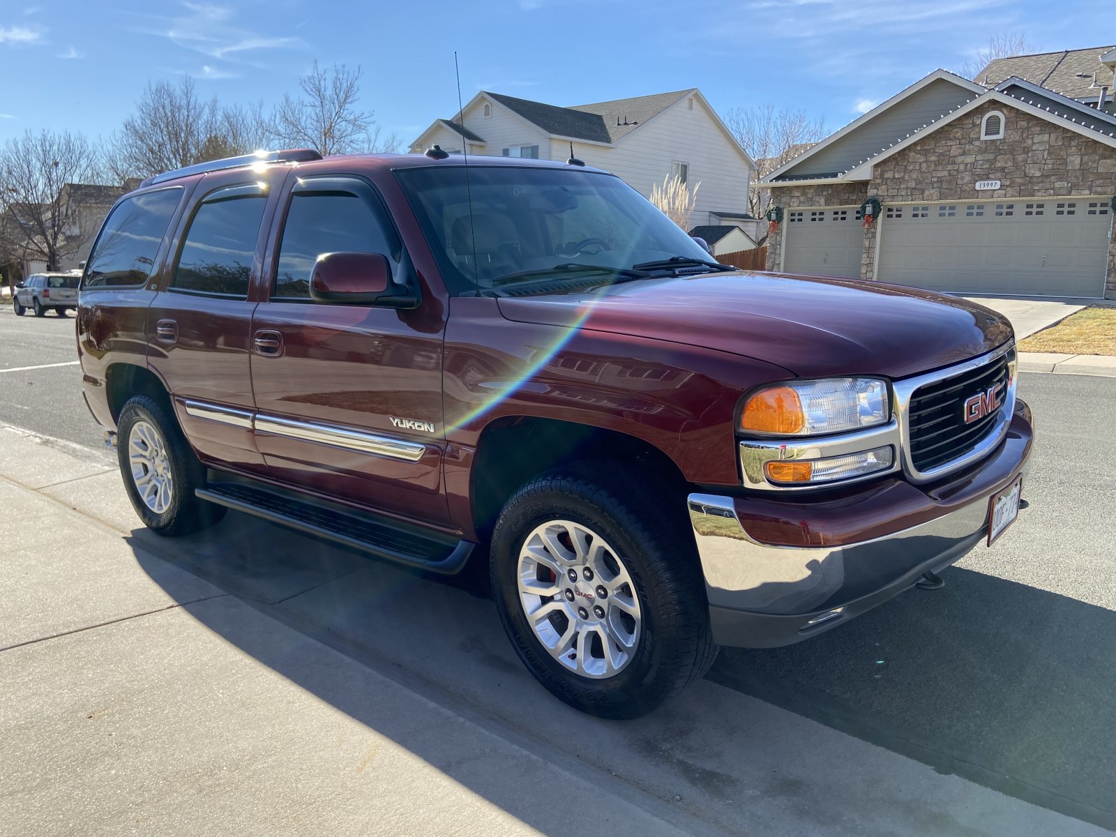

Looks great! What do you use for tire shine? I have some Armor All Gel that's a pain to work with, and I'm looking for something easier to manage.
Thanks man!!
Well, initially I thought they were too shiny, but after detailing everything else, It’s grown on me.. I buy the “Hot Shine” from Meguiars:
MEGUIAR'S G-13815 Hot Shine High Gloss Tire Coating - 15 oz. https://smile.amazon.com/dp/B000AMXQDG/ref=cm_sw_r_cp_api_glt_fabc_JYBSGXPJER75PHEWT4KB
I spray it on, let it sit for a few, and then use a foam block to wipe excess off. So definitely not a quick / simple process. I’ve been trying to decide what to change over to myself. Lol.
Still really liking the “Bare bones” for the undercarriage / wheelwells though. Once they’re cleaned up, that stuff kicks a s s and it’s easy to keep them looking clean & black, like they’re supposed to.
Though, I’m sure my neighbors laugh at me, watching me wiping down the wheelwells.. :hahano:

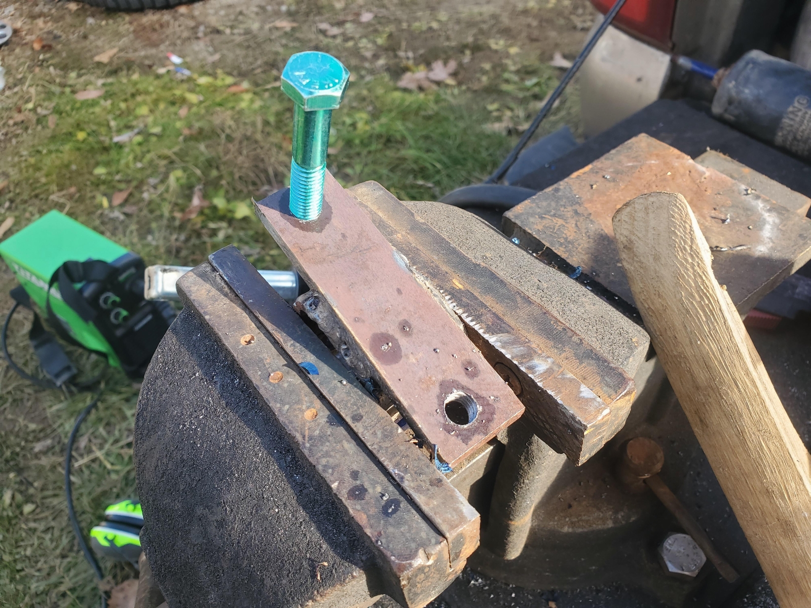

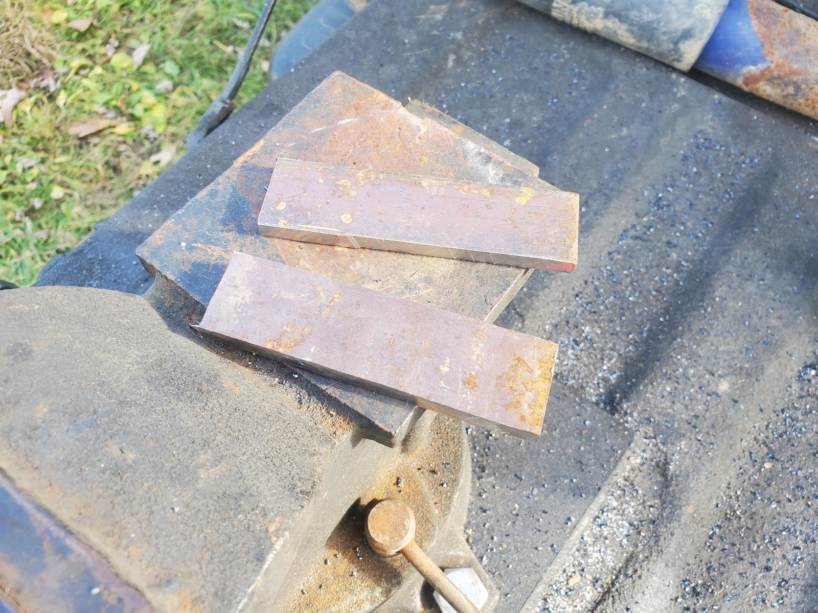

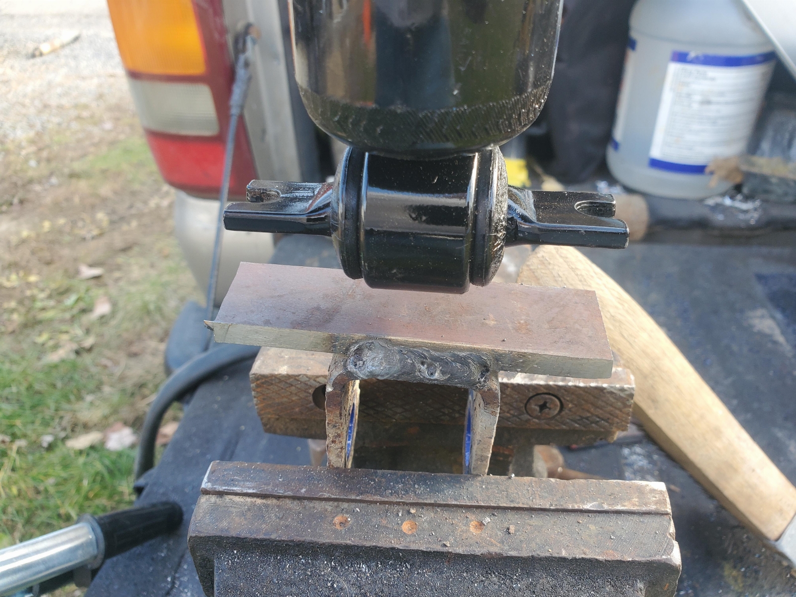

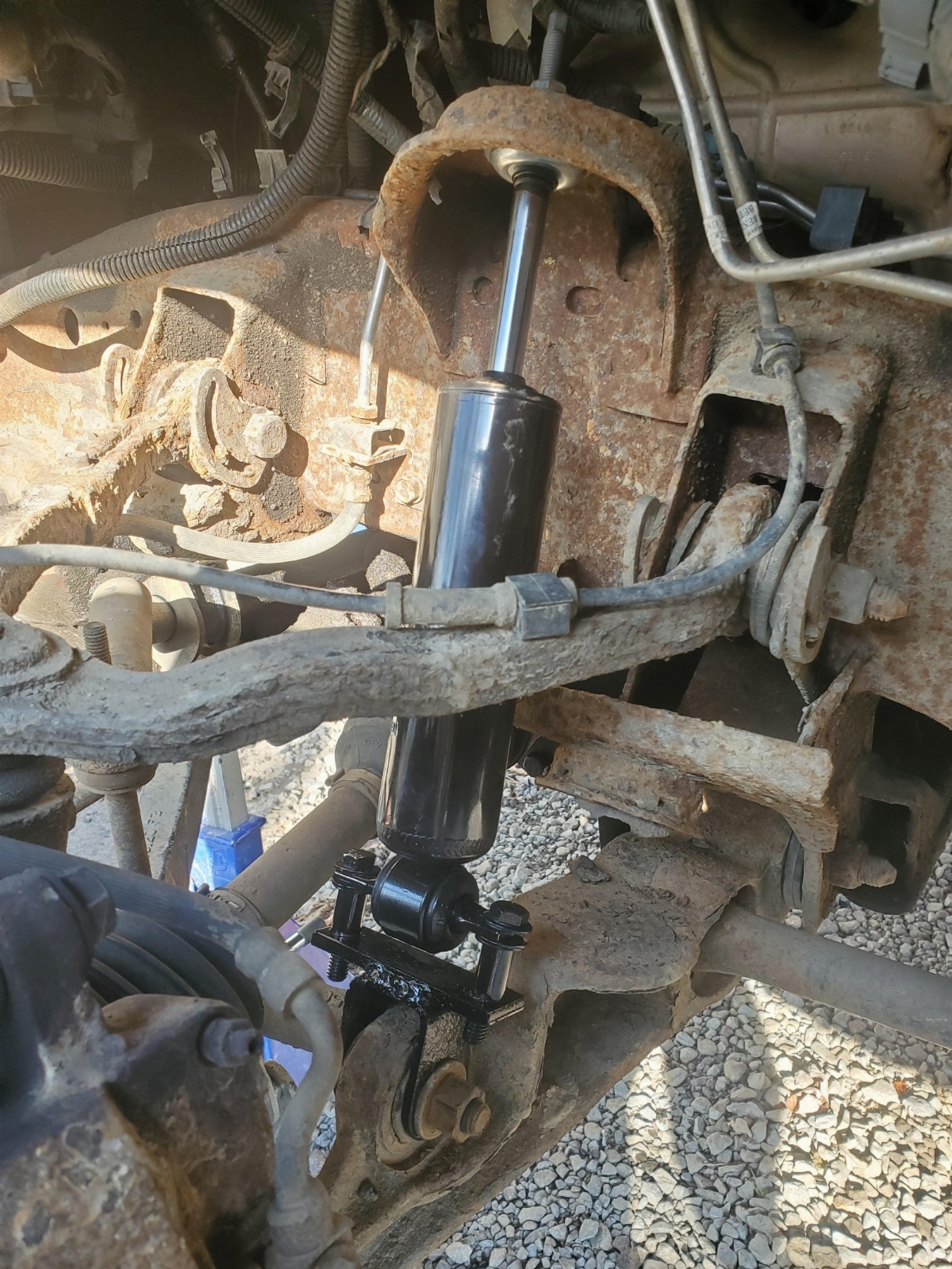

I had some new shocks laying around for an '88 Dodge D150, and my Tahoe still had the original shocks at 295k miles. I looked up the specs and they were pretty close, so I decided to make em work.
Rear was easy peasy. Bolt in, just swapped to a 1/2" bolt on the top.
Front took a little more figuring. I ended up cutting the bottom mount off the original shock. I cut a piece of 1/4” plate and welded across the mount. Tapped two 3/8 thread bolt holes. Cut some 1/2" aluminum tube into spacers for the correct height. Bolted the shocks to the adapters, painted it black, threw it all back in the truck. This actually worked out great because the front shocks were about 1" shorter than stock plus I have cranked keys. This extended the shock roughly 2" making the length about perfect.
By the way, if you all haven't seen em... Check out the Diablo Steel Demon circular saw blades. I use these a ton for metal fab any more. Saves a ton on angle grinder wheels, and it's way quicker and cleaner.
Not the prettiest job, but it works just fine for the Ugly **.

I'm diggin' the custom fabrication! This especially hits home for me as I'm rockin' Jeep TJ coils and Jeep XJ shocks in the rear for my drop.
I do have a concern about the side loads on those bolts in 1/4" plate. I see them working loose and wallowing out.
I agree. I love this kind of custom fab work and I am missing my welder and plasma right now. I was also concerned the softer aluminum spacers might deform over time.
45,012
Yup. The Grade 5 bolts themselves aren't so much the problem. It's that they're in single shear and doing double duty with keeping that fabricated lower half straight while clamping it all together. Most of the loads are linear with the shocks compressing and extending, but it's not a perfectly straight action. They're basically relying on 1/4" of thread and the aluminum to hold straight. A few sharp bumps could fold it.
A quick and easy fix would be to replace the spacers with thicker sleeves welded to those 1/4" plates and use nuts instead of the plate. I'd make the sleeves out of 1" solid round stock with a 3/8" hole through the center to maximize load plane and support for the bolt. I'd also top it off with Grade 8 hardware. Quite a similar repair/upgrade as what @Rocket Man did for his tie rod end spacers.

That's awesome, and thanks! Theoretically they won't see much side load, but this is a [relatively] short term solution anyway. I plan to swap a Dana 44 under the front of the ** and do a 4 link setup in the front eventually.
Alex_M
Sep 27, 2021
380
686
I just got a plasma for the first time a few months ago. Talk about a game changer.
The aluminum I think will be fine since there's only the load of the shock on it. I've used aluminum spacers in harsher conditions.
