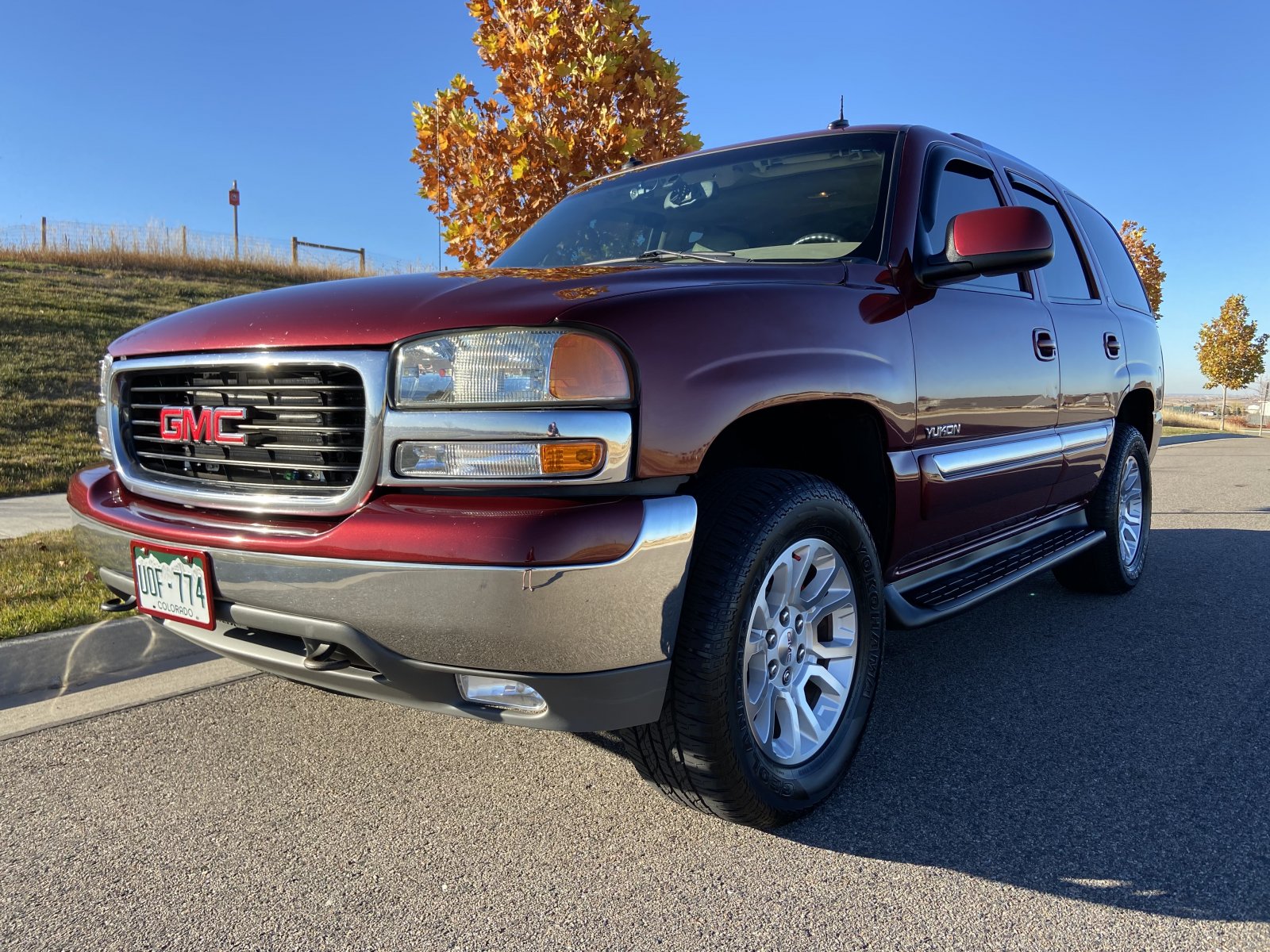

It rained Tuesday, so she got another wash and half a detail today:
