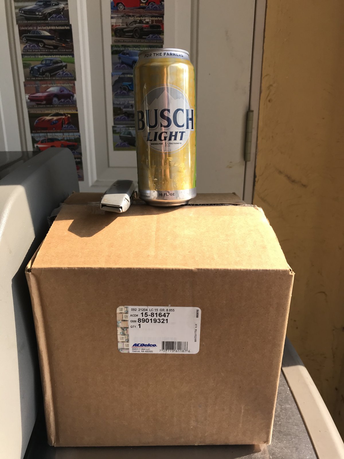

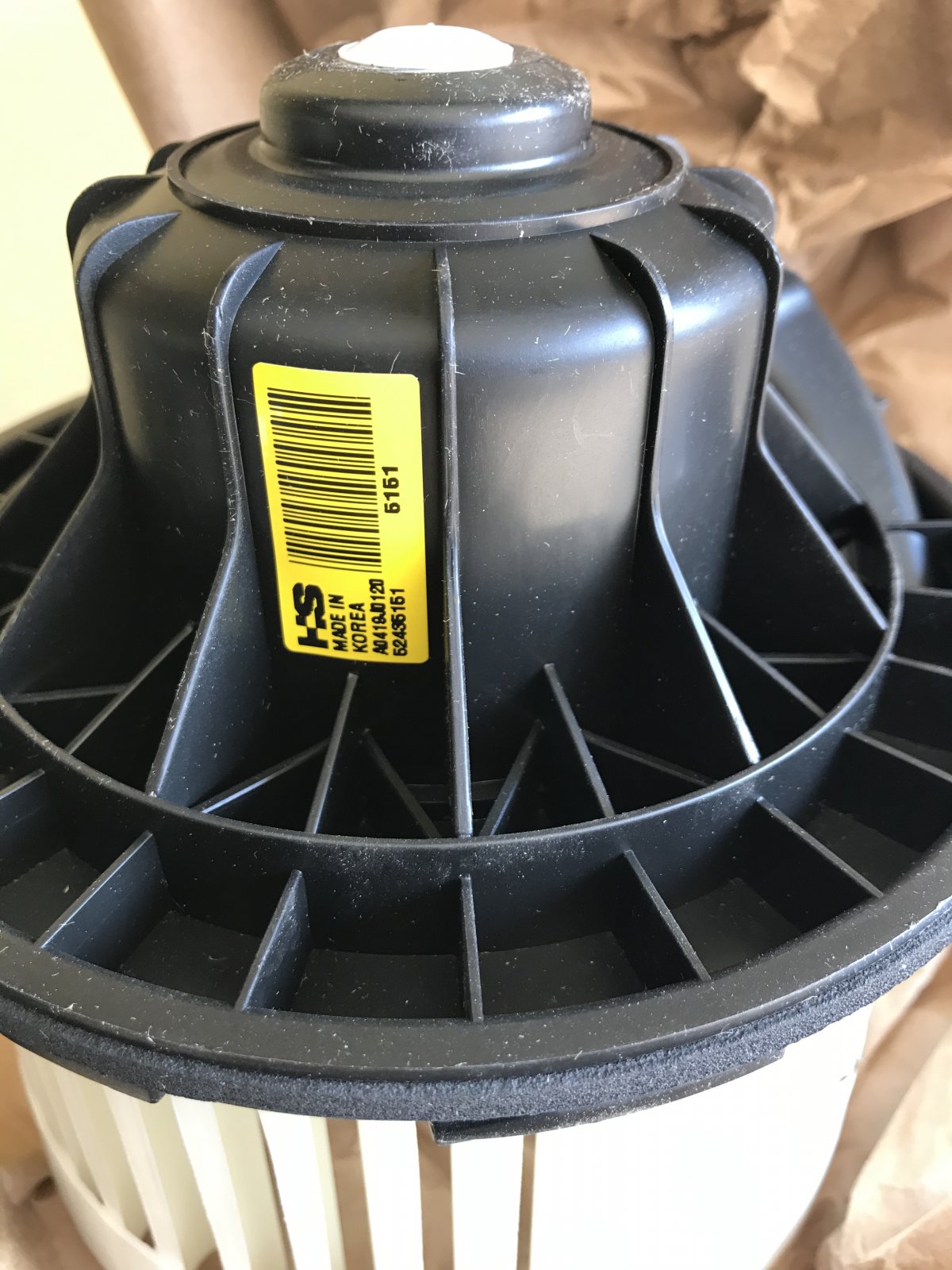

Today blower motor #4 went in the 01...GM genuine with the <3 next to it on rock auto, no harness on it resistor plugs right in, no noise, over heating, or issues at all so far. Hopefully this saga is done! Korea vs Canada x3 and Korea has won.

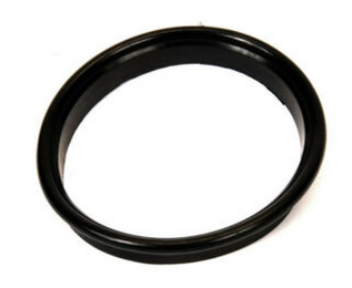

After looking at the specs its even taller than I recalled. Says 18mm. I have the new one, thanks to part number confirmation by @915_Tahoe, and a new metal ring in case the OE one is weak.
We didn't exactly pinpoint the leak with smoke, but we could tell that it was coming from the fuel pump area. We shot several short bursts of low pressure air into the vent valve line -- since the rest of the system is closed -- and Nate could feel the air from the leak hissing out right at the seal.
