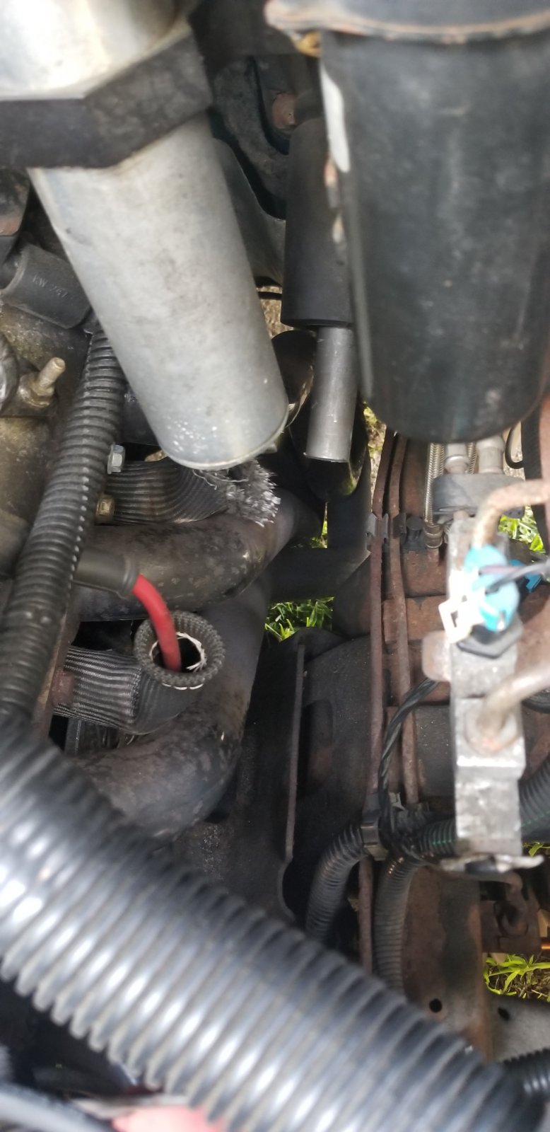

Thx Sam. In the process now. 162706398968897440935988623302.jpg16270640393606764262360479562788.jpg

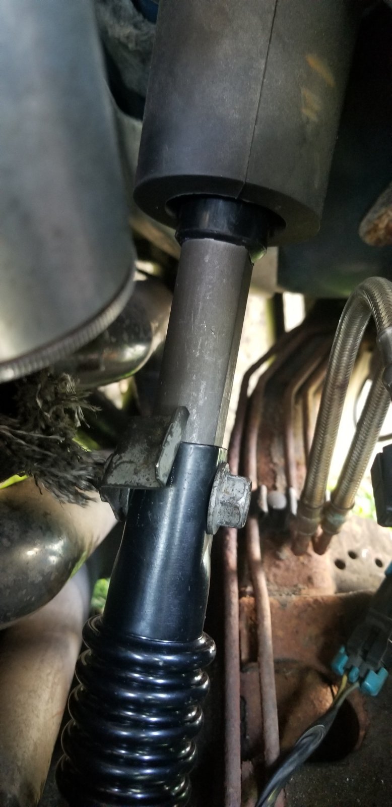

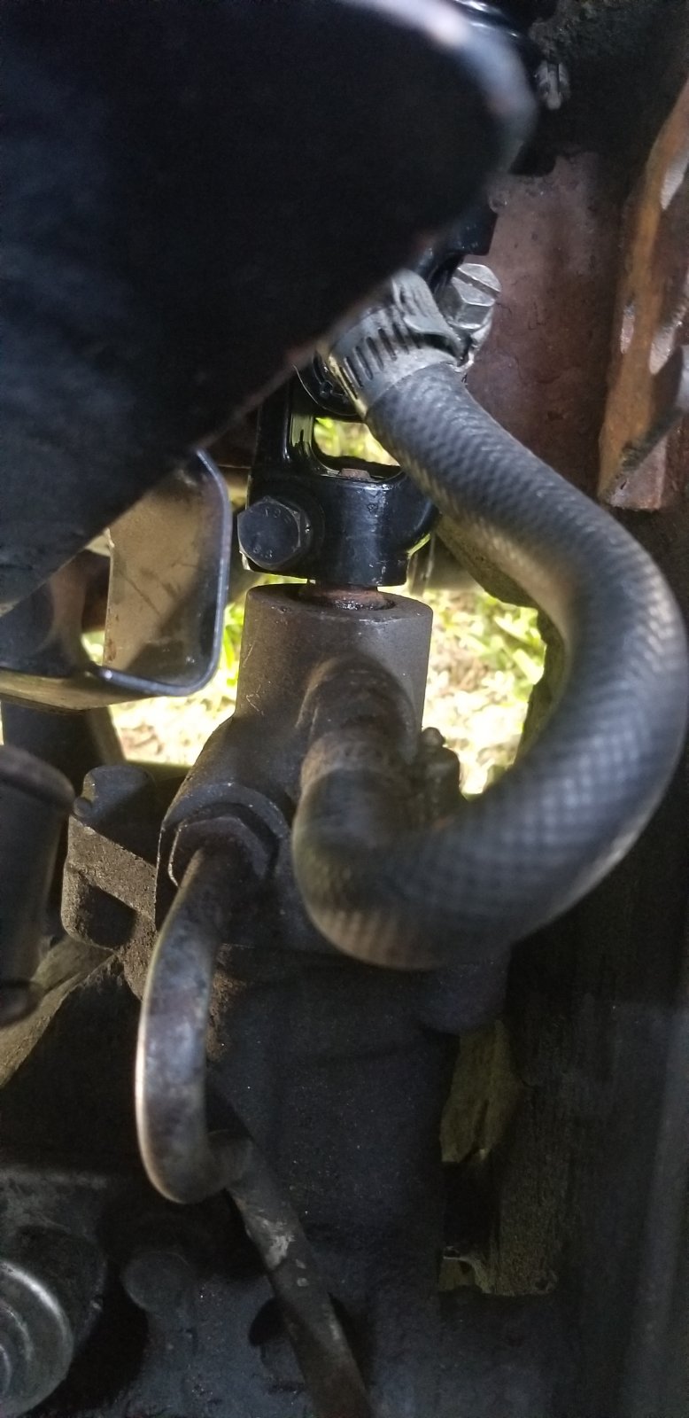

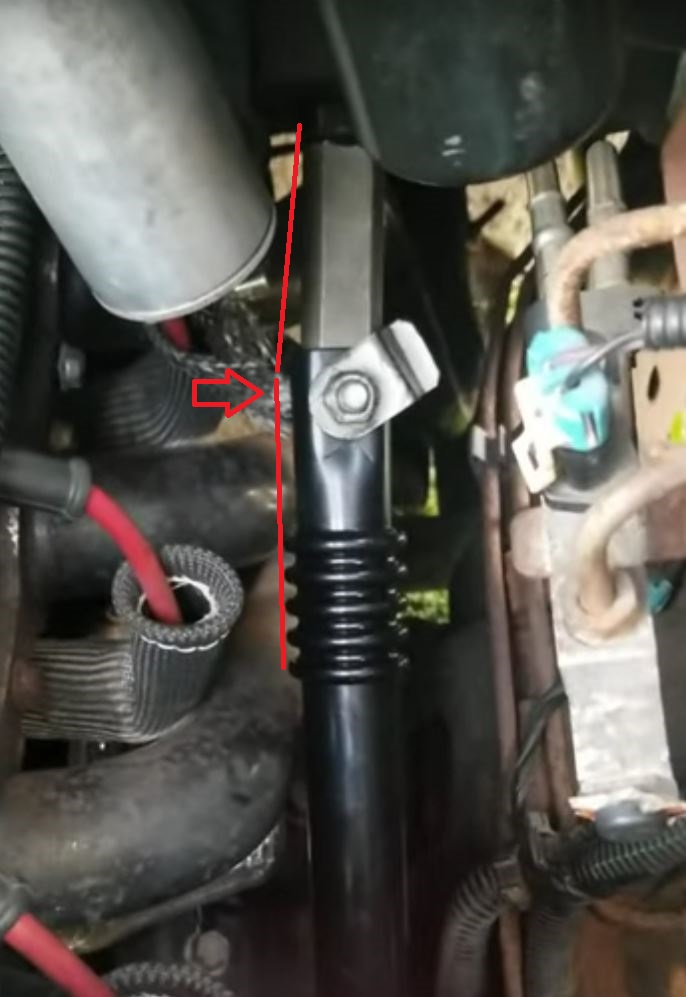

Ok, it's all put together but I've never noticed this. Had my gf turning the wheel all the way to the left, all the way to the right etc, and noticed this--
Is this "wobble " normal? Everything is tight and nothing moves that shouldn't while it's sitting still. I right have to bang the lower shaft onto the steering box--it was a tight fit. Normal?20210723_150851.jpg20210723_150902.jpg

I've never done one, but it looks like the joint (where the bolt is) is not squared up. If you rotated it so the clip on the nut side is to the right, loosened the bolt, and pushed down on the joint, you might be able to take the angle out of it. Then re-tighten.
Maybe others have suggestions.

I’ve never watched mine as the wheel is turned but thst sure doesn’t look right to me. I’m curious to see what others say.

I think I figured it out. I had to bang the new lower shaft on because it wouldn't go on, so I used the old upper shaft to bang the new into place. I inserted it correctly, but I hit it too hard. It pushed the new lower into place, but the old shaft went in too far, thereby stretching the new inlet a bit. I don't see a way to close it up some. If I took it apart I'd be facing the same issue that caused the problem in the 2st place.

Not sure what you’re thinking to close up. I wouldn’t take it apart, just loosen the bolt at that connection slightly, try to align the 2 shafts, and retighten
I did try to do that--same thing, no change. I think the wobble came from using the old shaft to bang the new lower onto the steering box shaft.

It’s probably not for the best, but I’d probably loosen the bolt a bit, rotate it where the high point / largest part of the run out was facing straight up, and gently beat it into submission.
Won't work in my situation. I just put everything together and said fu*& it!
