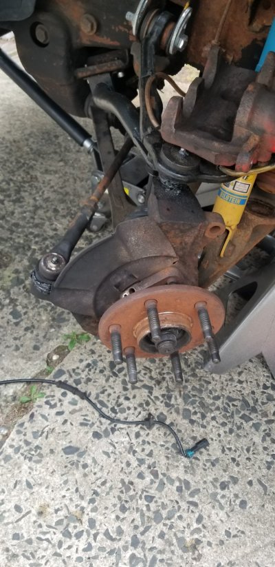

I didn't get an after pic. I cleaned off the grease on the boots, and I installed the new abs sensor. Now I'm getting an abs code for the ps! I bedded in the new brakes. Stops amazing now! Now I just need to get motivated enough to swap out the ps abs sensor.

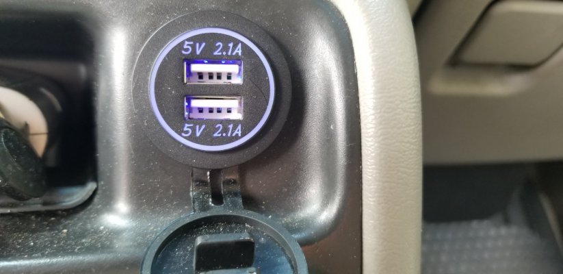

What was in the hole before?
Just a regular power port. I have a wire coming off that convenience center near the parking brake pedal. I never tested how many volts it is. I didn't tie it into the power port wires because I didn't want the led light to be lit 24/7.
Put it on a relay drawing it main power from the original charge wire and use the keyed power for the switch.

THe old power port you removed -- did it say on the lid what the current limit was for the socket? I'd bet that your new device doesn't pull all that much power at 12v. Got a spec for the USB thing, or a link?

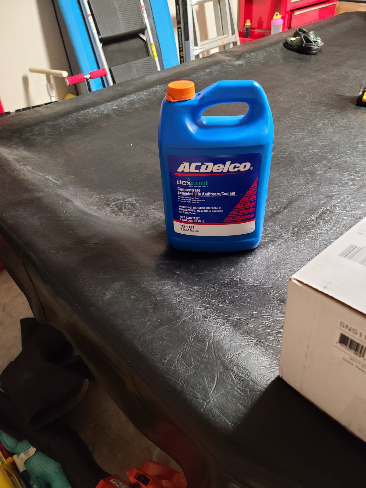

Noticed some moisture on driver side of rad. All hoses are new so I'm thinking the rad gave out. Got this for it's replacement today and a new ambient air temp sensor as well. Going to install it Saturday morning
