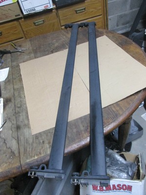

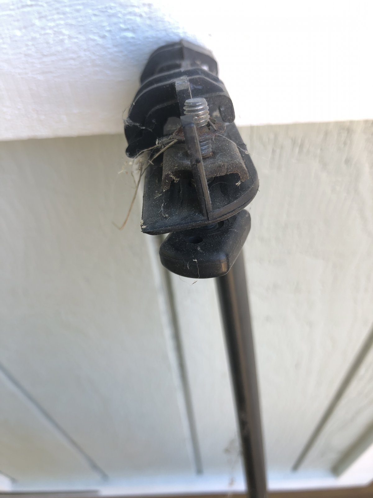

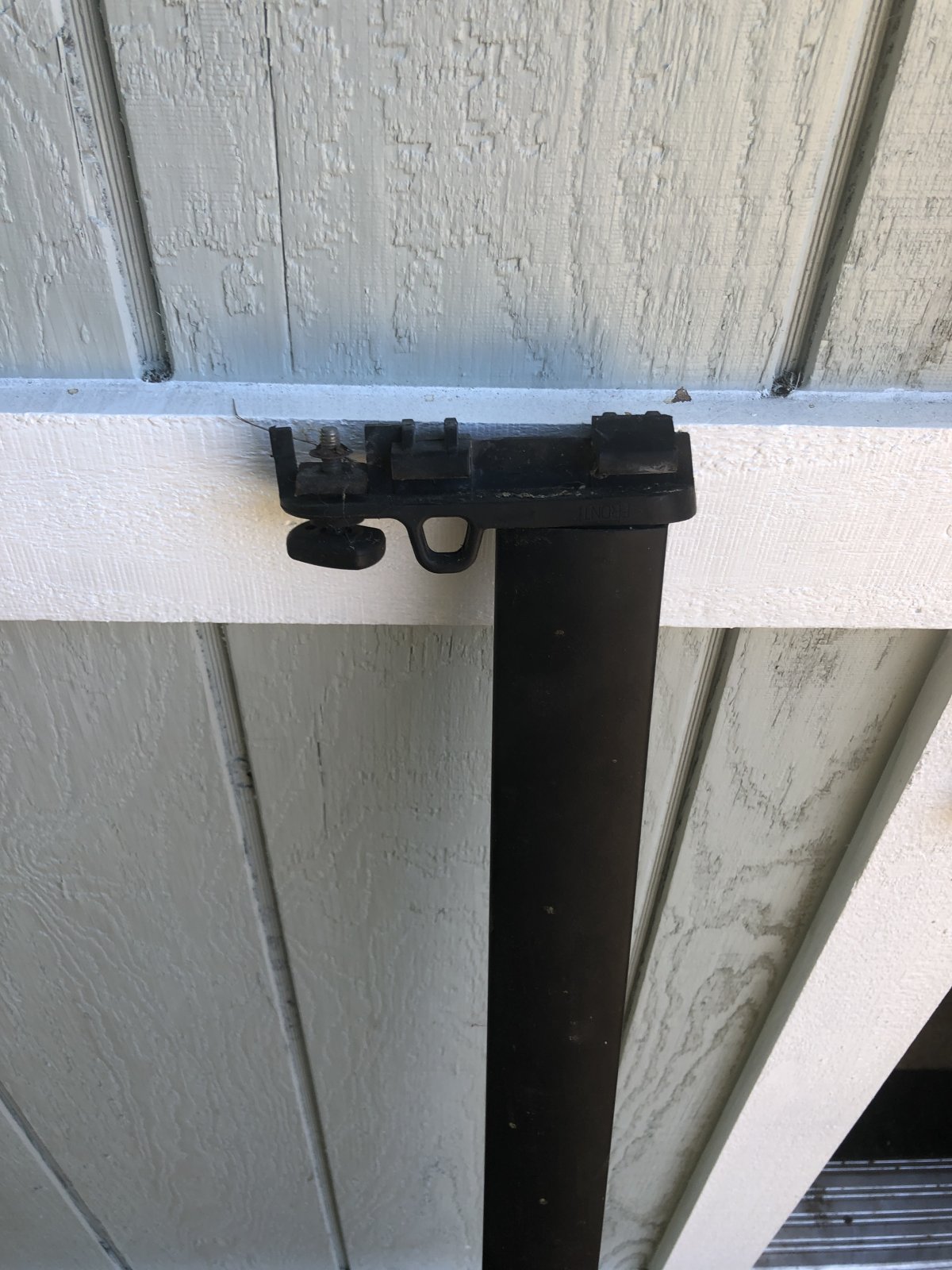

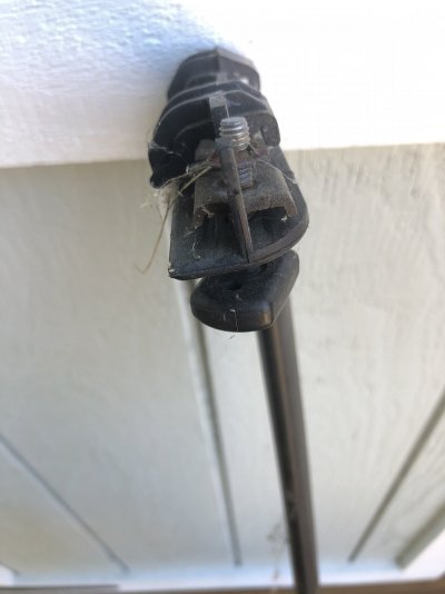

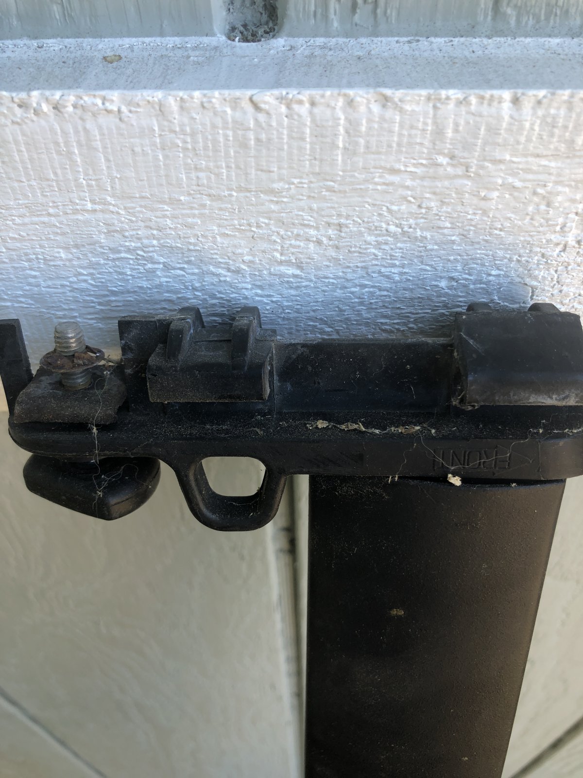

I am looking at cross bars for the roof rack on the esky. Do these look like the right style?
These are listed for NNBS but appear the same.
Wife booked us for camping in a few weeks and I've got to find a way to get the old thule cargo carrier up on the roof.
52,949
Here pics of the Esky crossbars off my 02. Hope it helps.

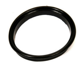

@915_Tahoe when you have a chance, would you please look up a fuel pump gasket (tank seal) and pricing for me?
It's for my '04 Tahoe, 5.3 Flex Fuel, last 8 of VIN 4R199261.
I see a couple of numbers online so I'm a little confused about what's the correct one. G52 (19337980) and G39 (15103734). If G52 is correct, does it supersede G39?
Thanks, I appreciate it!
Fuel pump seal
GM#15103734 $56.66
Delco# G39
