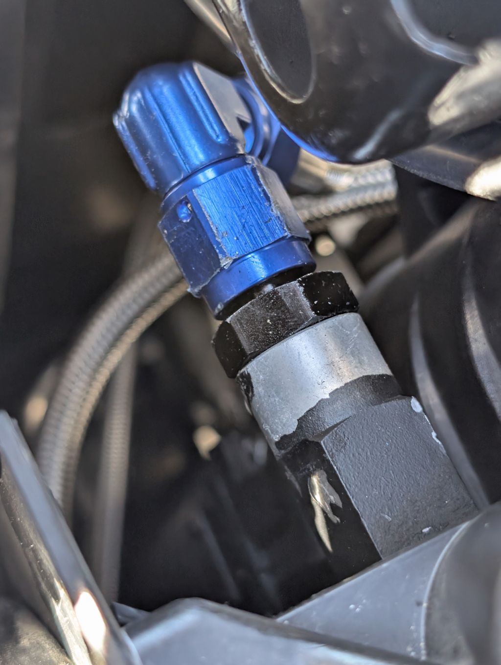

I had to make the holes to feed the lines thru a little bigger because of the 6an fitting, but all went as planned, it makes it all leak
go back a page to post 4343, I did end up having to order a longer 6an line for one side the 36" was not long enough I bought a 54" which was more than enough but a 48" would have worked fine
Looks great hell yea !
30,570
48,055

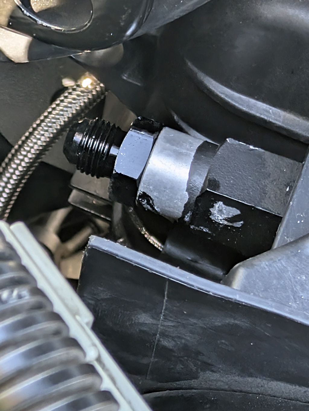

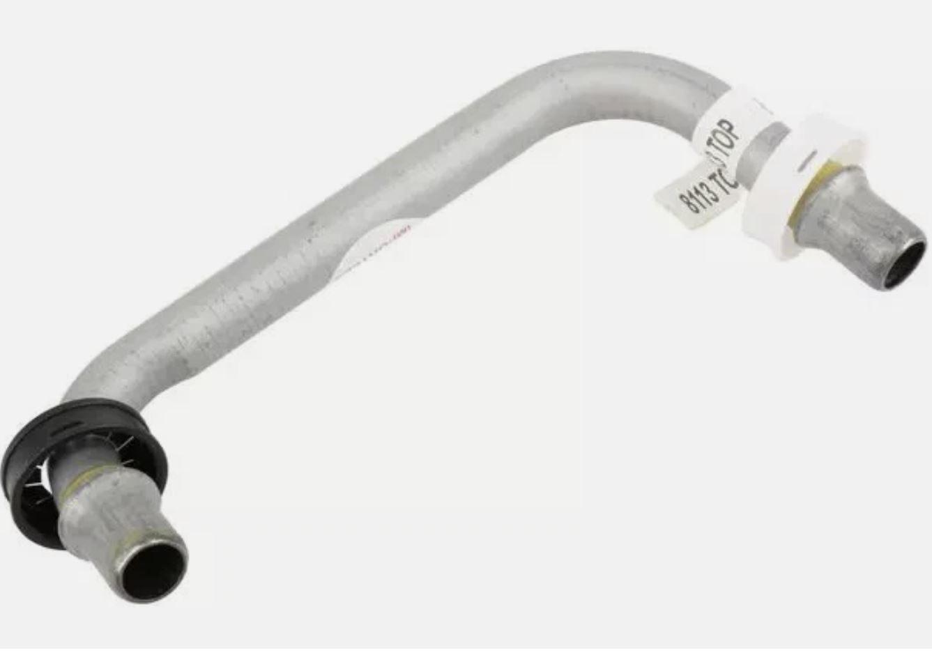

I am not happy with that ICT billet male 3/8 to 6an adapter, it's sweating at the quick connect, ordered another one from a different place to see if maybe it's just not 100% to spec,
also going to see if the quick connect fitting unscrews from the factory transmission cooler I gave it a couple ugga ugga's to see if it would come off but it didn't budge. I am going to check with the dealer tomorrow to see if it is a separate piece or not, if it is a separate piece then I can just remove it and go 3/8" to 6an and bypass the quick connect.
the ict billet one appears to be the only one on the market, all the rest are made for fuel lines which is a different design
or brain fart kicking in I can order a line like the one that I cut off and just adapt it like I did the male end on the return line

checked with the dealer and they said the quick connects on the upper part of the ac condenser (which is the factory transmission cooler) ARE replaceable so
I should be able to just remove the quick connect and put in a 3/8" to 6an adapter, presuming 3/8" is the oem thread size
**ordered a couple 3/8" npt to 6an fittings hopefully one of them works
well it's def not npt, I pulled one out at the junkyard that "should" be the right size and that one turns out to be 14x1.5 (metric) so I ordered a couple 6an to 14X1.5 should be here next week sometime...

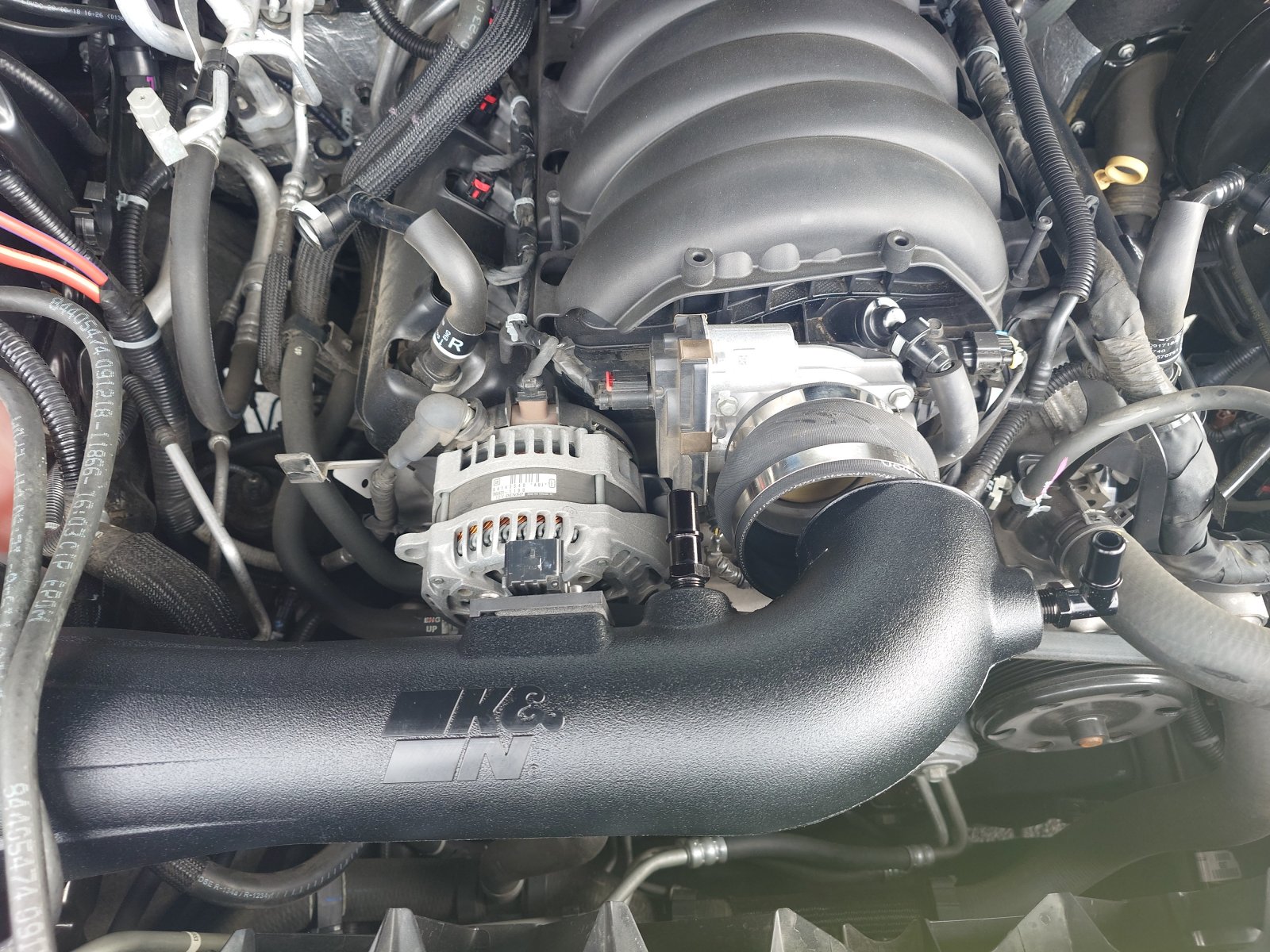

Finally got my car sold, yesterday, so, I immediately bought everything I'd had my Amazon cart. Summit was gonna take too long for the same stuff..
KN NextGen intake
J&L AOS (Corsa was actually $20 cheaper at Summit, and in stock!)
Phillips HIDs (stock box of light is cool, but, I NEED flicker, again!)
AVS window.. Things
GDIOMGWTFBBQ cleaner (which I still need to figure out how to do correctly)
I'm a lot of things - a Dog Dad, a Gym Rat, White Collar CryptoBro, Iron Chef.. One thing I'm not, though, is patient. I'm very hashtag Blessed, but, I'll pray in Thanks before I ever ask for Patience . . I know better.
Today, I installed that intake, since it arrived about an hour before I was off work.
Ugh. Supposed to be straightforward, right?
Wrong.
What should have been an hour job turned into three.
How, you ask?

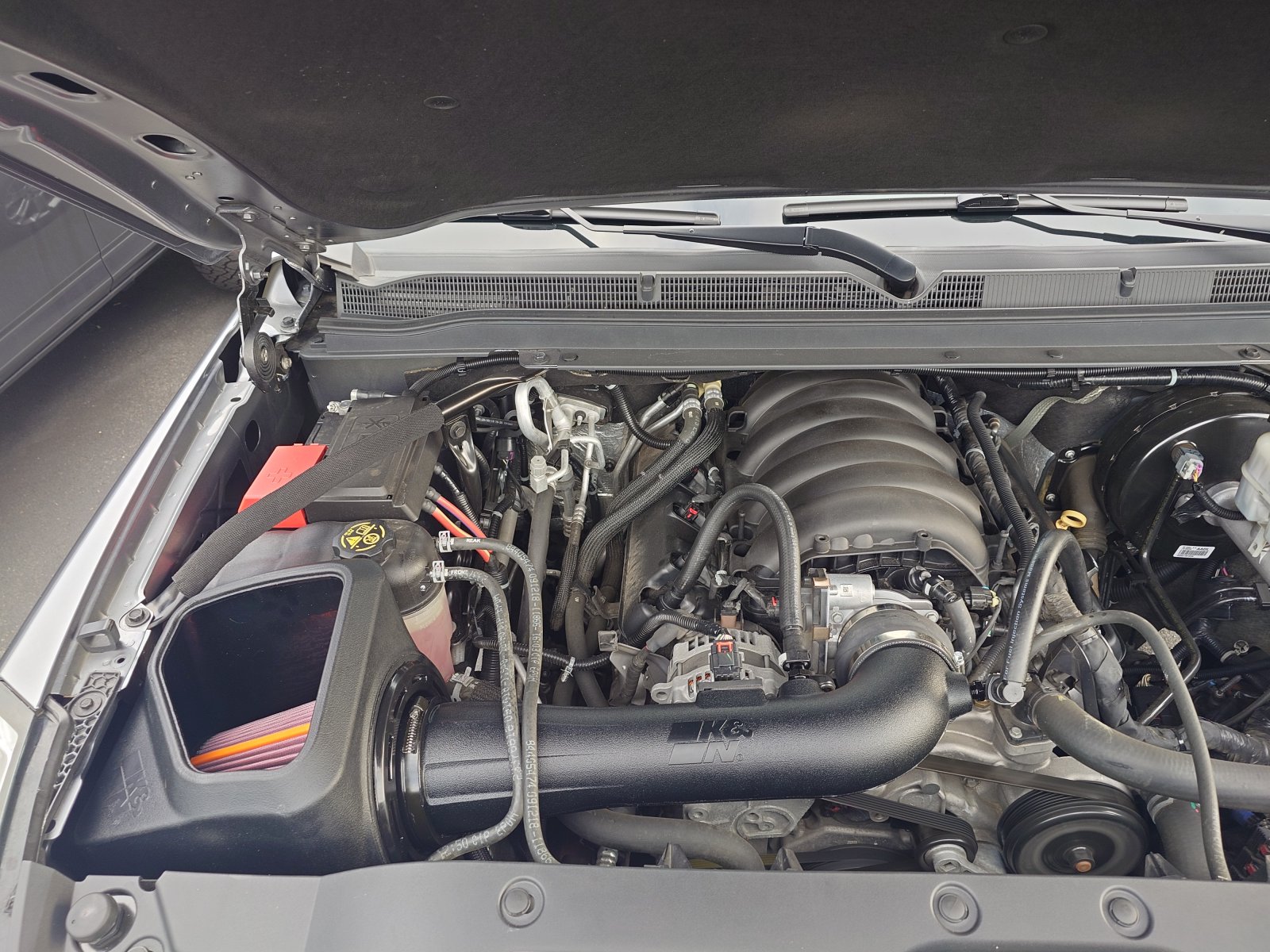

Lemme tell ya, the cone sits in the box, right? It's supposed to sit flush. It wasn't until the second time I pulled it back out, that I inspected the sealing area - it was unevenly . . Cast, I guess? Take pocketknife, start, "clearancing" the hole, to get the filter to sit flush with the box. Test fit, it works. Pull it out, put box back in the chassis. Slide filter in. No Go. Apply hella pressure. Newp. Pull it back out . . Repeat. Was finally able to get the cone in, but, only if I have it in BEFORE it goes in the engine bay. This means there's only the two anterior bolts holding it down because the large end of the filter is blocking the one bolt hole on the opposite side. It'll have to do, for now.
The core support brace comes out, but, the other, larger chassis brace does need to come off the fender, just temporarily, as it impinges on the corner of the airbox. Once I got the box in, obviously, it didn't feel very seated, but, once I applied pressure to it with the chassis brace to bolt that back in, it stiffened up a bit. With everything in place, it doesn't move a whole heck of a lot.
All this and the PCV lines were actually the easiest part. I finally got it to sit correctly, clocked the tube into the filter, tightened down the clamp, got everything all squared away.. Now it sits solid.
Got everything back together, no job is complete without, "Where the fсk did my ten go?!" trying to put the negative terminal back on..
We sat and idled while I cleaned up, no codes (Thank God; the time I had, I was actually expecting that!)
Drove around the block - Meh. Didn't feel faster. Just louder, and I think I lost some low-end grunt.
Went back home, fed the dogs (their dinner was late because of all this) and washed up, decided I'd take the stock parts to storage. Threw 'em in the back, let the Fiancé know I might get stranded (She's away on a work trip, lol) and off I went.
Given a little bit more time, less traffic, I got to playing around with it - I don't recall the speedo skipping numbers, before, but it does, now. While it doesn't FEEL like it's accelerating faster, by the numbers, it appears to be. We'll see. It's certainly loud on acceleration. Sounds alot like the exhaust. If I'm just taking 'er easy, no change in sound, from stock. Shifting does feel a little.. Different. Jerkier? It probably needs more time and milage to learn.
Gas mileage is noticeably improved. I know what I used to burn on this trip, and as I drove, tank estimate went up and the gas gauge didn't move, so, that was actually a plus.
Remember what I said about patience and ordering new bulbs? Three guesses what I'm doing, tomorrow..

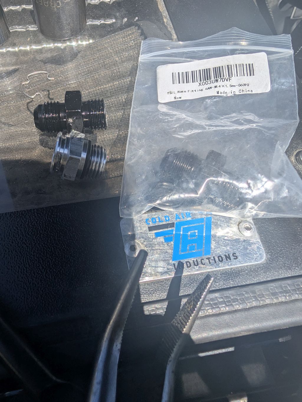

the m14X1.5 fitting worked, I had to cut the (m14) oem cooler side thread about 3/8" shorter so it would fully seat with the o-ring
no more sweating on that connection, the ICT billet quick connect just wasn't sealing up right

if your oem cooler is like mine it's a tight fit in there a small tilting head ratchet adapter and a large socket worked I think 3/4" and a breaker bar to get it loose, then a 18mm box end worked for tightening up the 6an fitting a 1/4 turn at a time lol.
keep in mind the oem cooler is also the ac condenser so I used a big wrench wedged in the gap to keep from flexing the cooler while loosening/tightening.

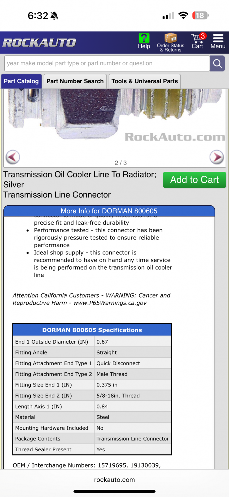

Well it’s going in my van so I’m sure it’s tight lol.
And good catch. Looks like mine are 5/8s based off rock auto
