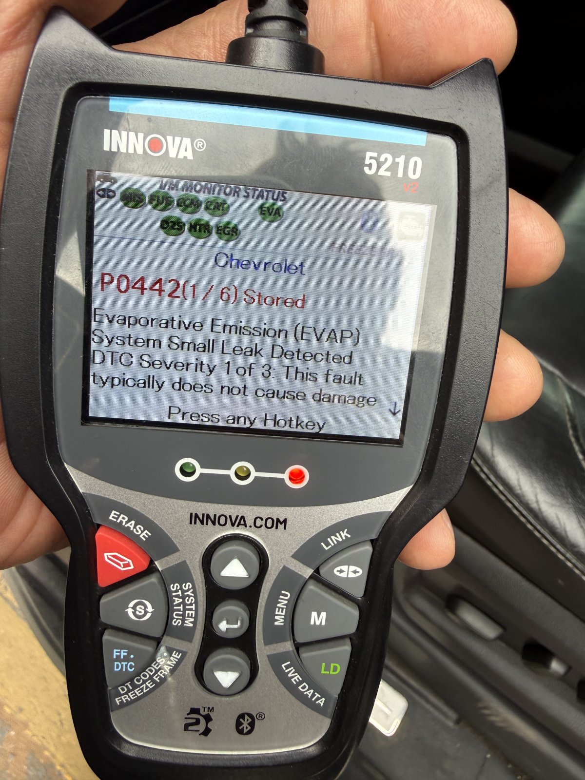

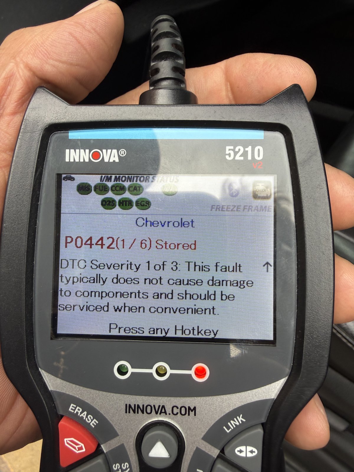

My check engine light is on on my 2015 Tahoe so I had my local parts store scan my car and I got the following codes:
What defect are these describing? How do I fix this? How can I get the check engine light off? Thanks for any help you can give.

that indicates a small vacuum leak, if yours still has the gas cap, you can try a new cap or I have rolled the dice and have it be the vent valve solenoid up by the engine..
this code can be tricky

the code has set 6 times, so pretty unlikely it is just going to go away...... all disconnecting the battery does is make it disappear for a minute
normally if the fix is not one of the 2 I already noted then it's usually the most cost effective approach is to just shot gun it.
vent solenoid (vent valve)
purge solenoid (purge valve)
canister
I recommend only using oem parts for these. aftermarket ones tend to fail in a short period
total parts cost is usually just under $200, presuming you shop around online, dealer or parts store is going to be more.
if you take it to a shop there going to charge you a diagnostic fee and then tell you it's one of the above. so :shrug:

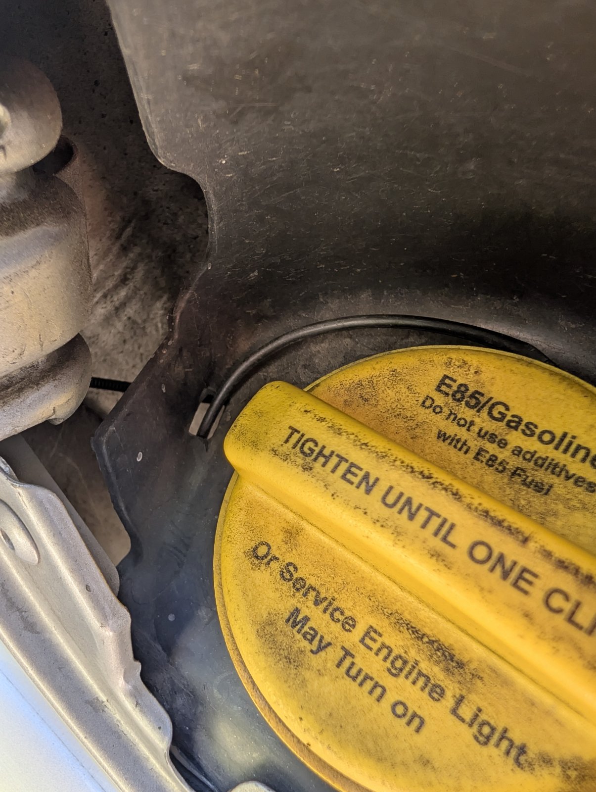

You mentioned gas cap. What about the gas cap is an issue? Mine is tethered which I like (keeps me from forgetting it at a gas station lol) but if it needs to be replaced then I can. If I order an OEM cap will it be tethered? To install a new tethered cap is it a big job? I’m not with the car and can’t remember how it’s tethered.

well the tether is usually one of two things
either it is a plastic T thru a hole, in which case you can just cut the old one off and stick the new one in and your done.
if it is a clip, then you can pry the clip off with a small flathead screw driver, then put the clip back on with the new cap.
the new cap will come with a new tether. presuming you get a oem one.
both of our k2's are capless, so not sure what type they used on the 2015, if it is like my 2012 you can just cut it off and stick the new one in

It wouldn't hurt to clean the fill tube's sealing surface when you change the cap. Maybe use a little sil-glyde or other lubricant on the o-ring or the fill tube.
