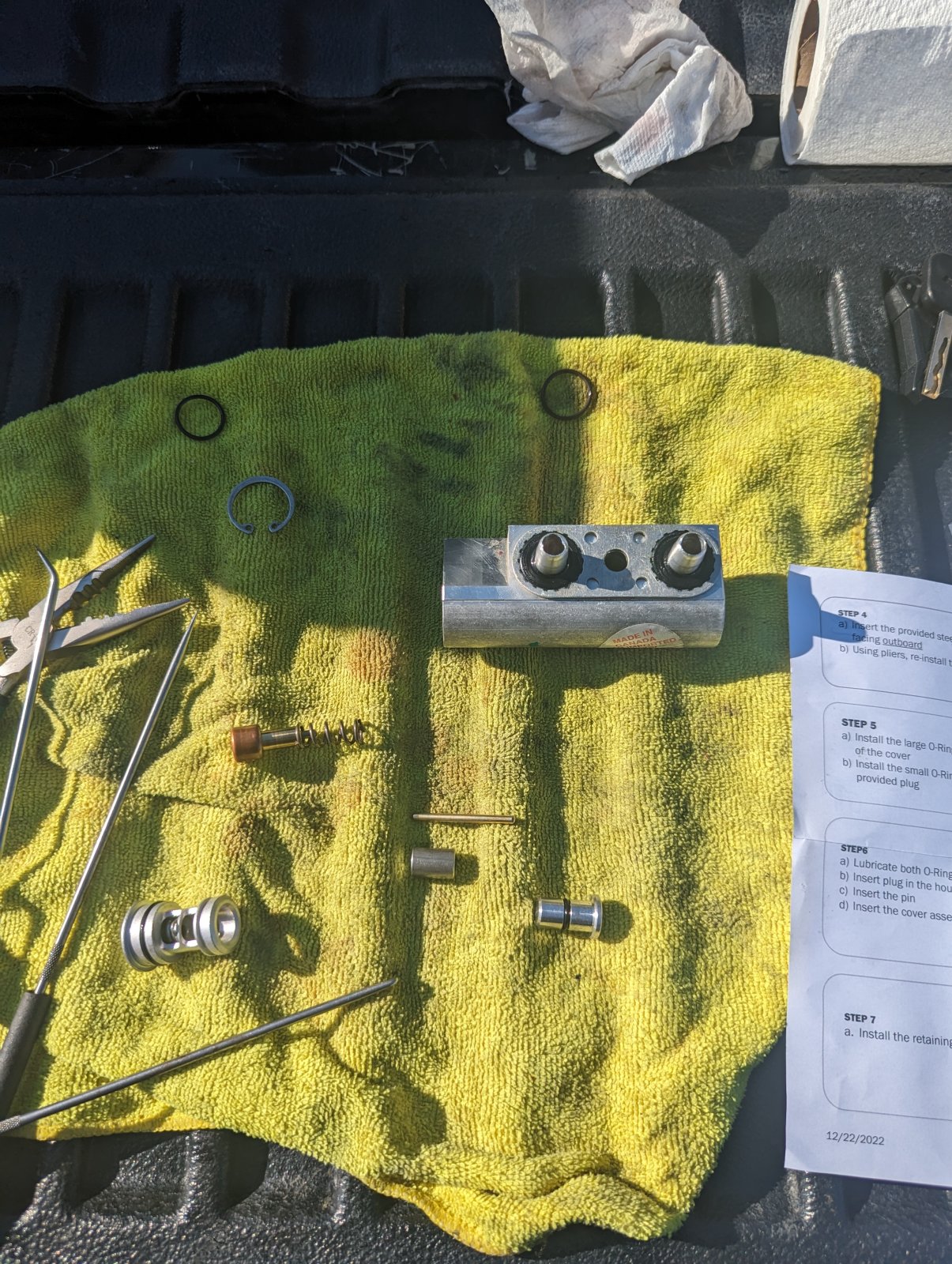

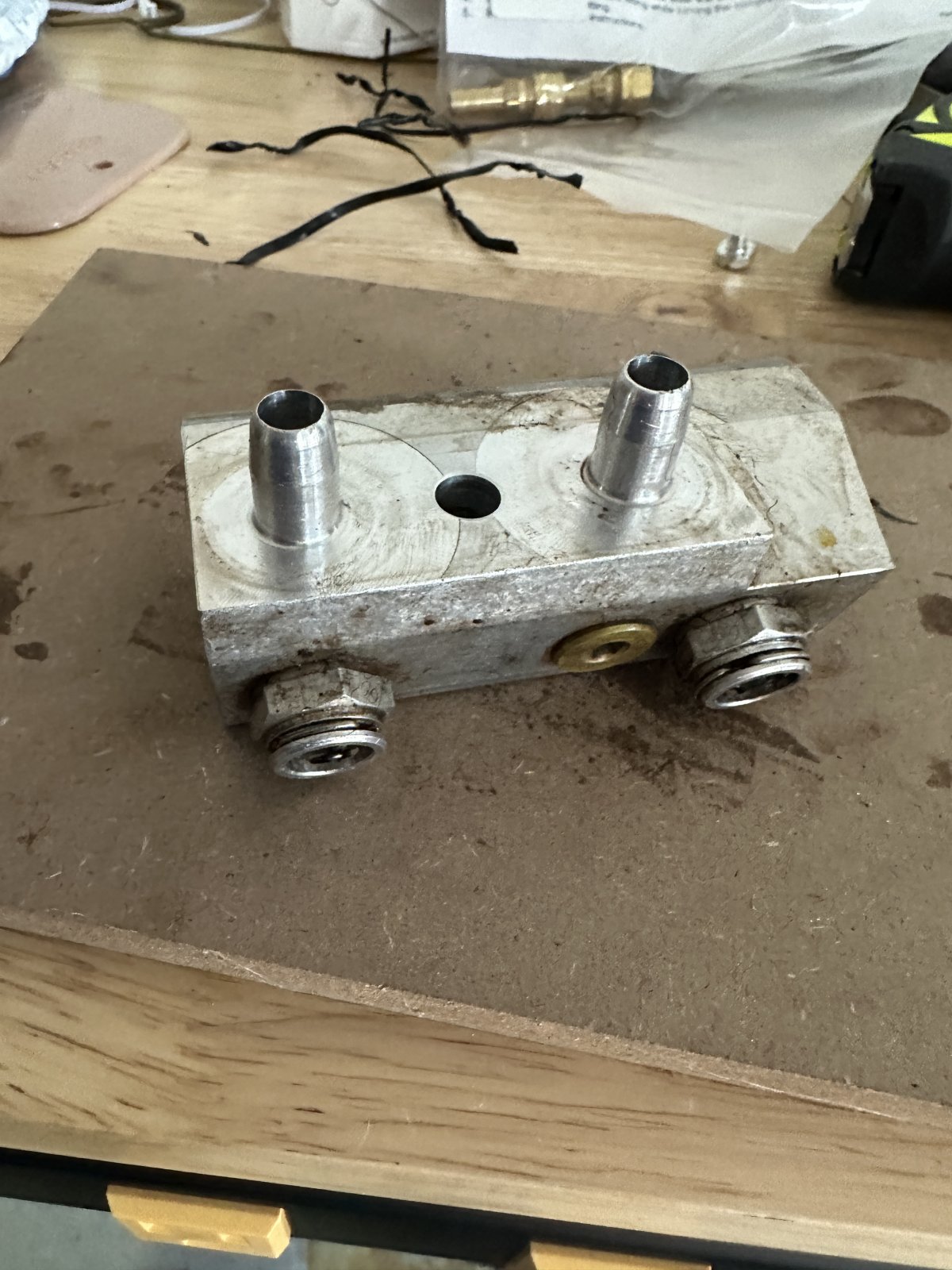

Installed the thermostat bypass for the transmission View attachment 407102
Did mine this morning. I hate these quick connections. I thought everything was peachy. Idled until it started warming. Went for a test drive, and the one toward the top popped loose. F#$&&king mess. Deputy pulled up thinking it was on fire.
Got under and the line snapped in. Audibly and by touch. Had some fluid with me so added it. Started limping home. Almost there and that connector popped again.
you have to be sure those lines are inserted properly all the way, you can do it by putting the clip on first then snapping the line in or push the line in and then put the clip back on

I did. I tried to reuse the old ones. Apparently the snap rings got distorted so wouldn’t keep the line in place.
I found replacements for the entire connection, then reassembled the mess. It’s holding now.
ya if the snap ring looks out of shape or bent at all I toss them out as they can't be relied on to work properly, over time I have collected a few spares I keep in my tool box

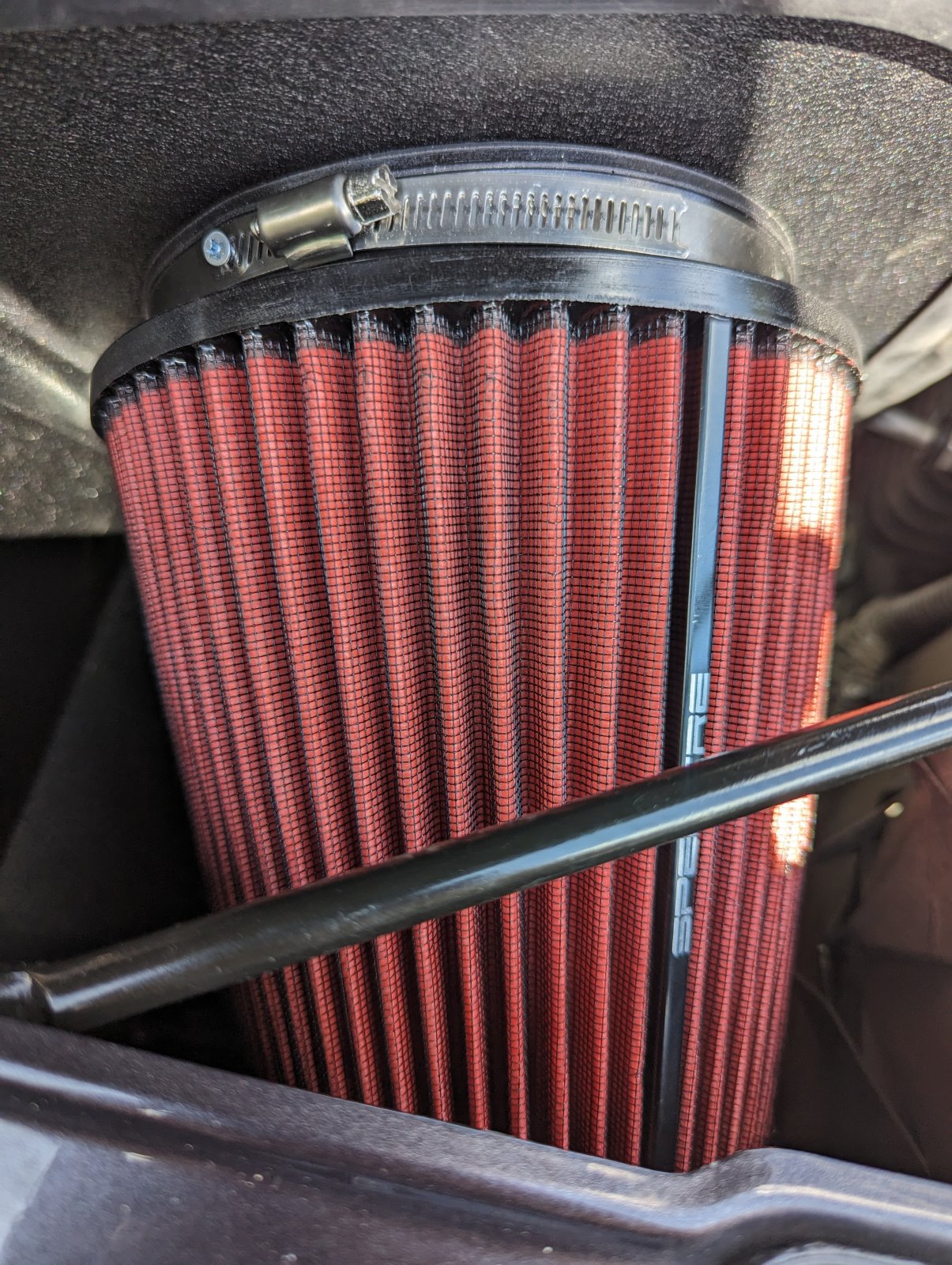

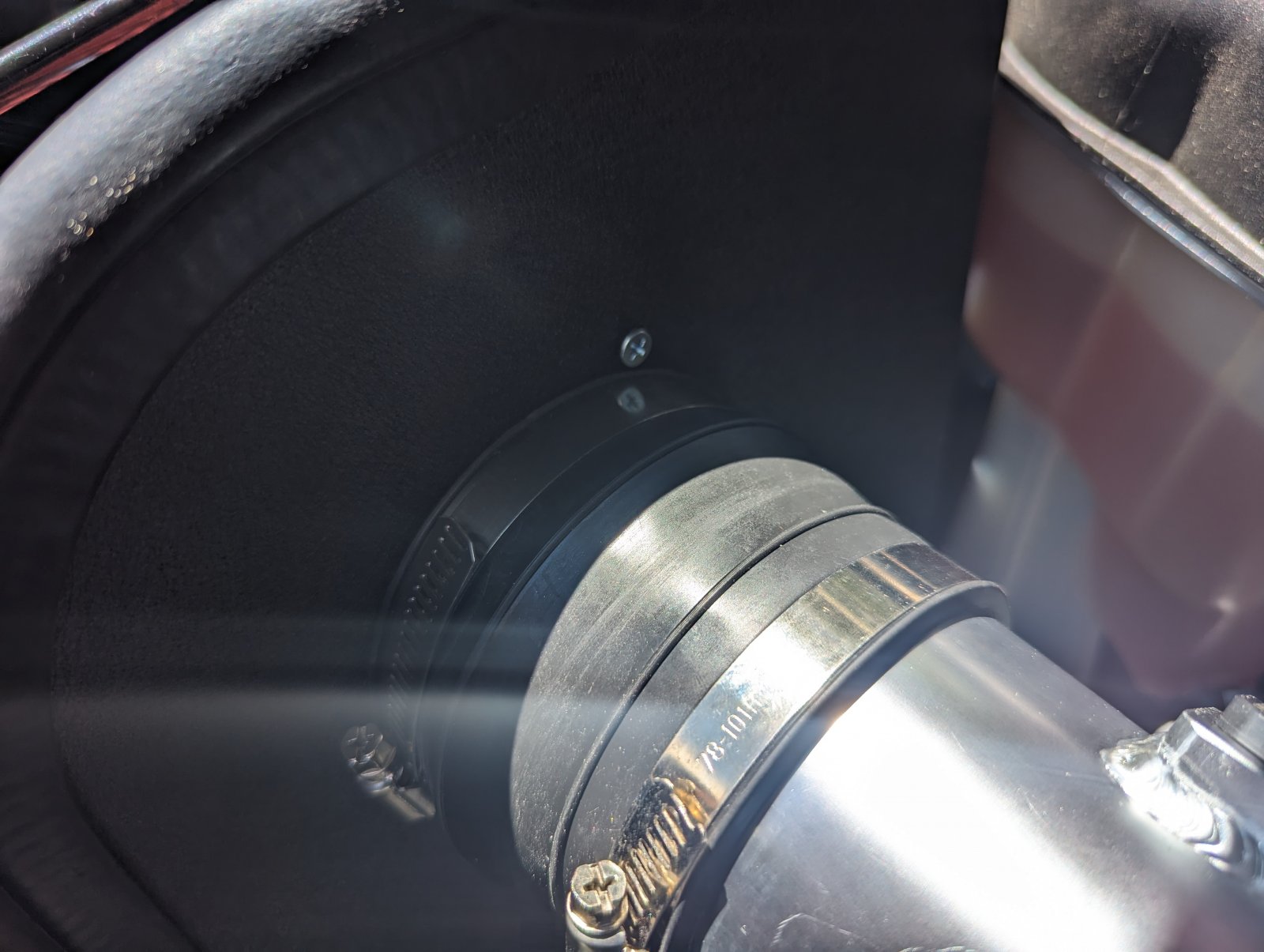

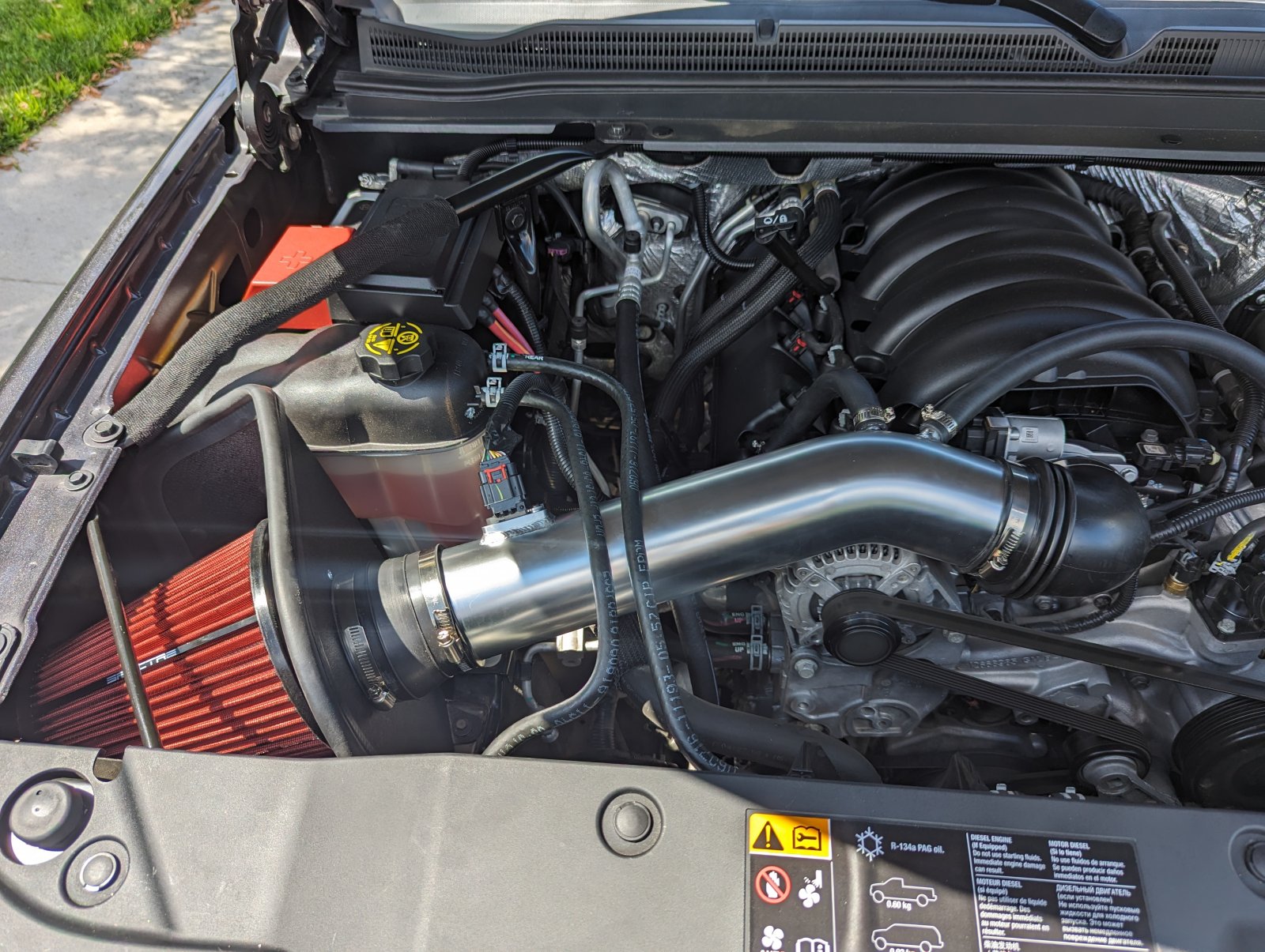

Threw a cheapy $200 cai on it the spectre 9006 made by k&n but it's the bottom of the barrel brand, lol and it shows in the engineering. Reviews say the filter falls off so put a set screw in it and found that the adapter that goes thru the heat shield would be a problem also so I put a couple screws in it to mount it to the shield like the better built cai's are designed, all said and done it seems to be ok. I will have to pop the hood after putting some miles on it and double check everything
