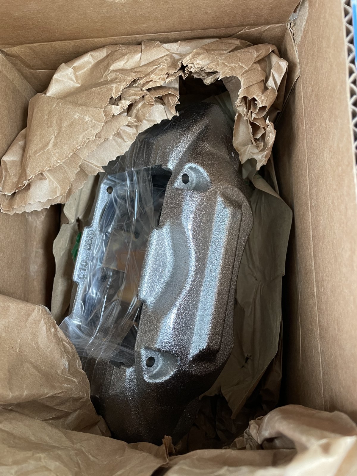

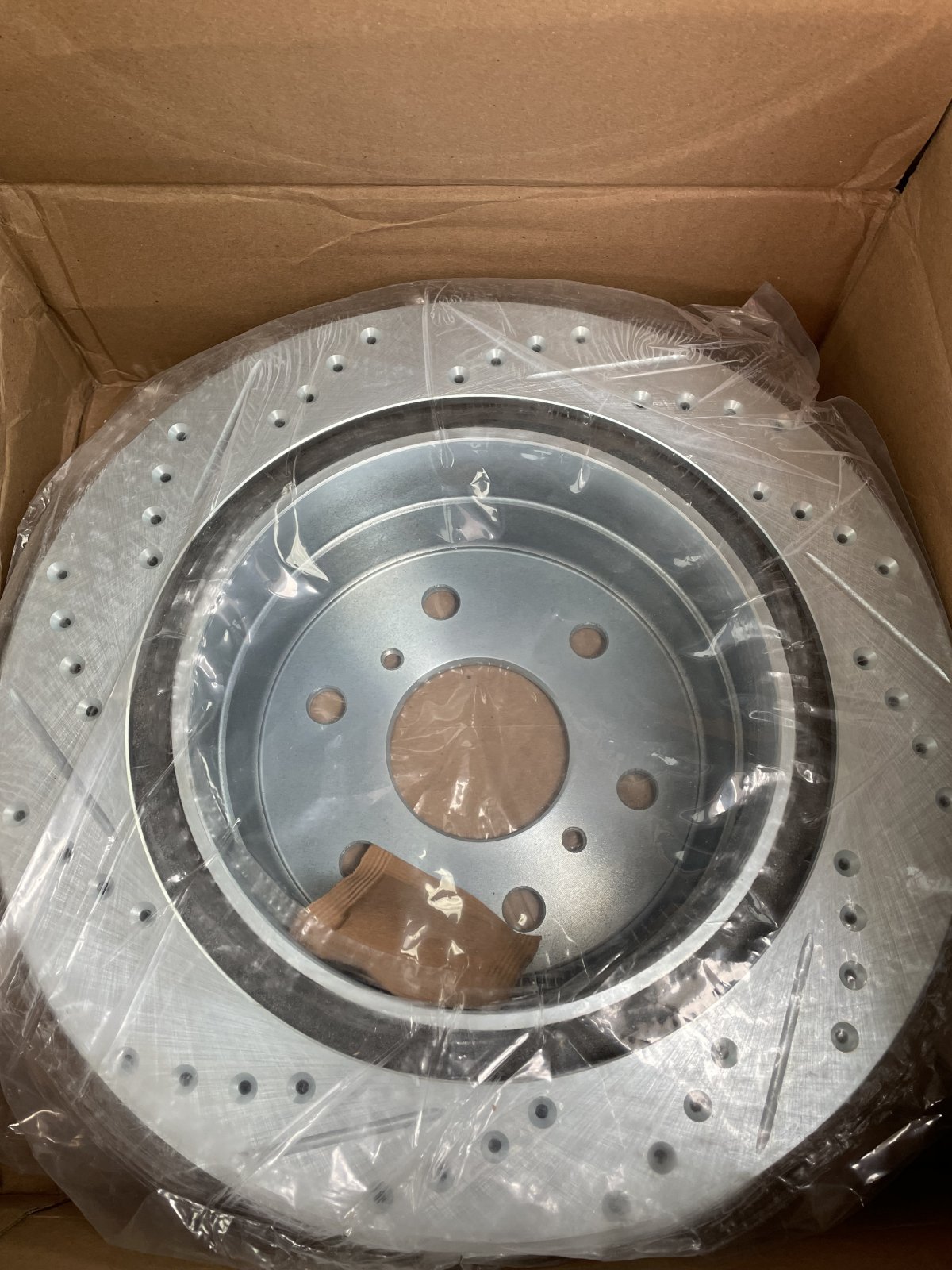

Not yet, in about a 2 weeks will do the install

I am interested in doing the same when my truck needs new pads in the front. Are you upgrading the front calipers & rotors with the pads from the current generation? Please keep us posted because allot of us want the same.

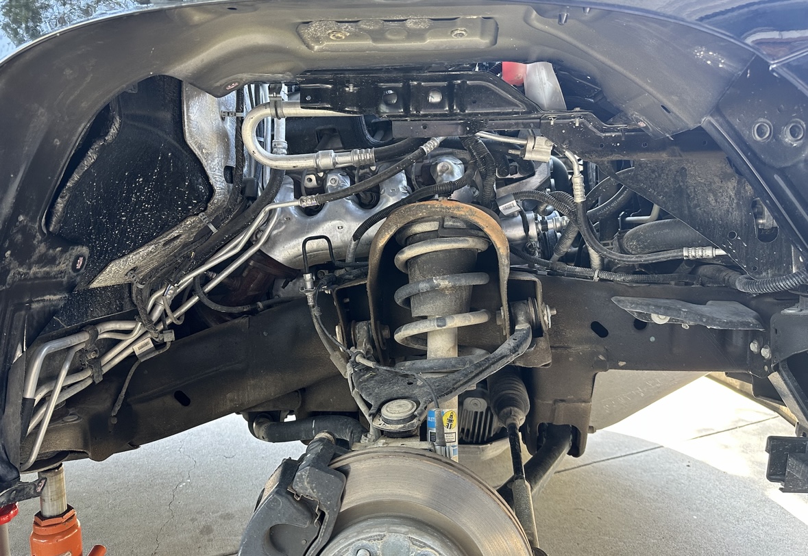

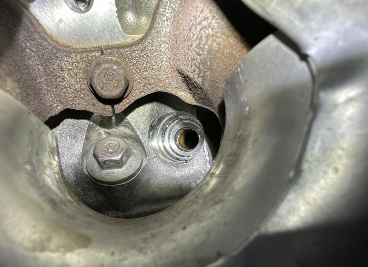

Went to change spark plugs as well since they're the originals with 92k miles on them now.
Driver side 1, 3, 5, 7 was easy enough from the top when I did that a little while ago.
Tackled the passenger side 2, 4, 6, 8 today and since it was a pain I took the wheel off and the fender liner off.

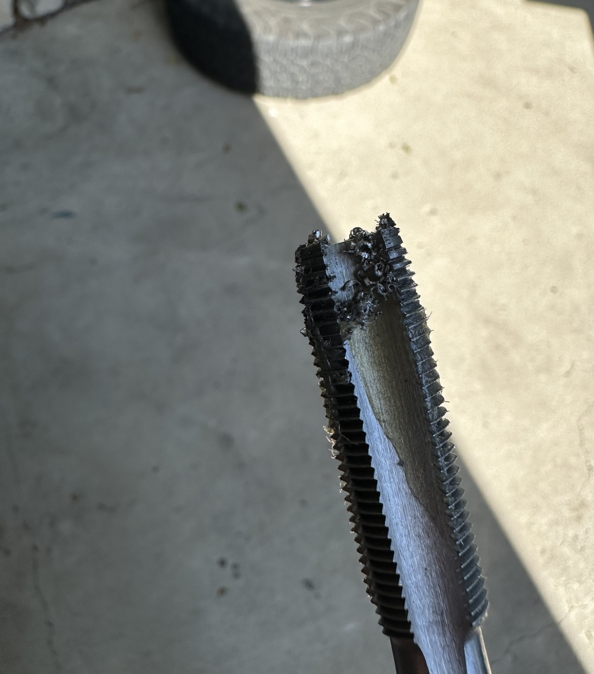

Number 6 was a pain in the ass coming out, turns out whatever moron put the plug in at chevy, cross-threaded it.
New plug wouldn't go in without cross threading.
Had to really work at cleaning and fixing (chasing) the threads to get a new plug back in.
