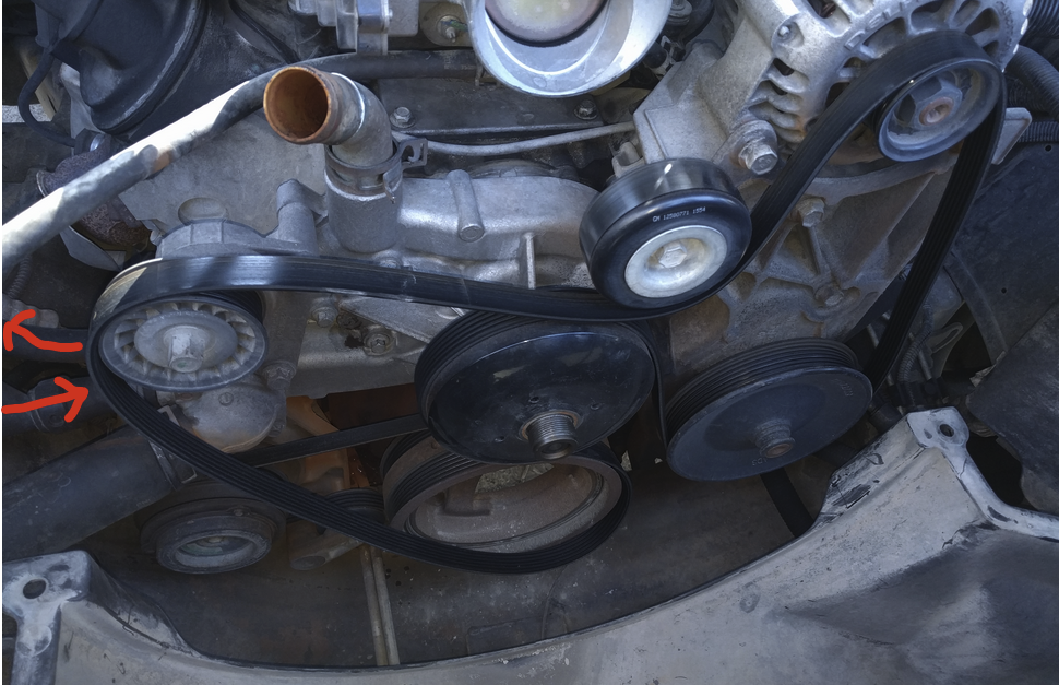

it's honestly easier just to remove the lower radiator hose. If you disconnect the heater core lines too, you'll get maybe an extra 3oz out of the system by removing the tstat. Meh, not worth it.
The heater core lines are the ones coming out of the passenger side of the water pump. Best done at the water pump that the firewall fitting, IMO.
These ones.
Follow them up to the firewall, and see if they go straight in, or have another set of metal lines that carry them down towards the lower-passenger side of the car. If you have the extra metal lines on there, it's 15.8qts
These ones.
It looks like 7.9qts which seems to convert to 1.975 gal. So that's around 2 gallons of straight dexcool.
These ones.
