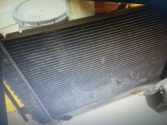

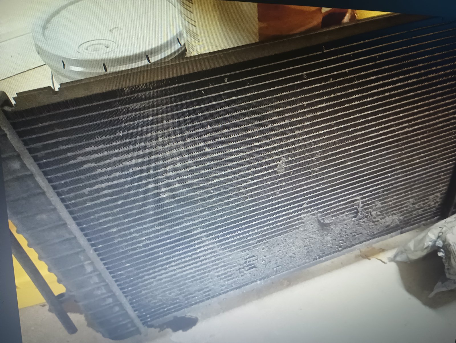

Ditto on checking your radiator. This is what the radiator looked like on 99 Silverado truck when I swapped the engine. The radiator was okay, but I replaced it only get the wider version. Truck had 260k and the radiator was original. A pressure wash at minimum is something I would have done to clean out all of that gunk...
