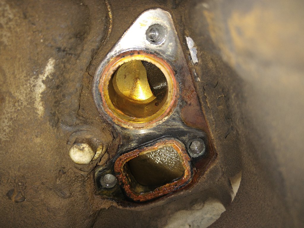

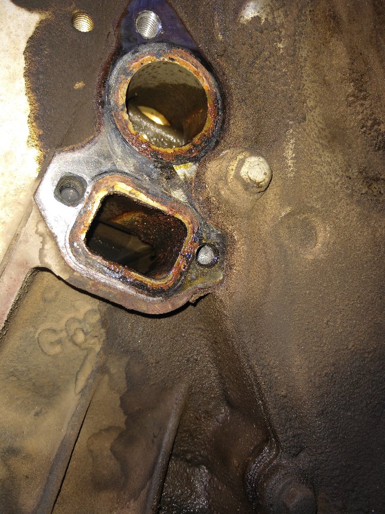

Here are pics of the driver and pass side head coolant openings also.

Looks about par for coolant that's been run longer than the service interval
Take a brillo pad and, by hand, clean it up.
I also feel that as we post more and more, there's quite a bit of info missing from this post.
From a removed water pump, to concerns about water out the exhaust
What's going on chief?
