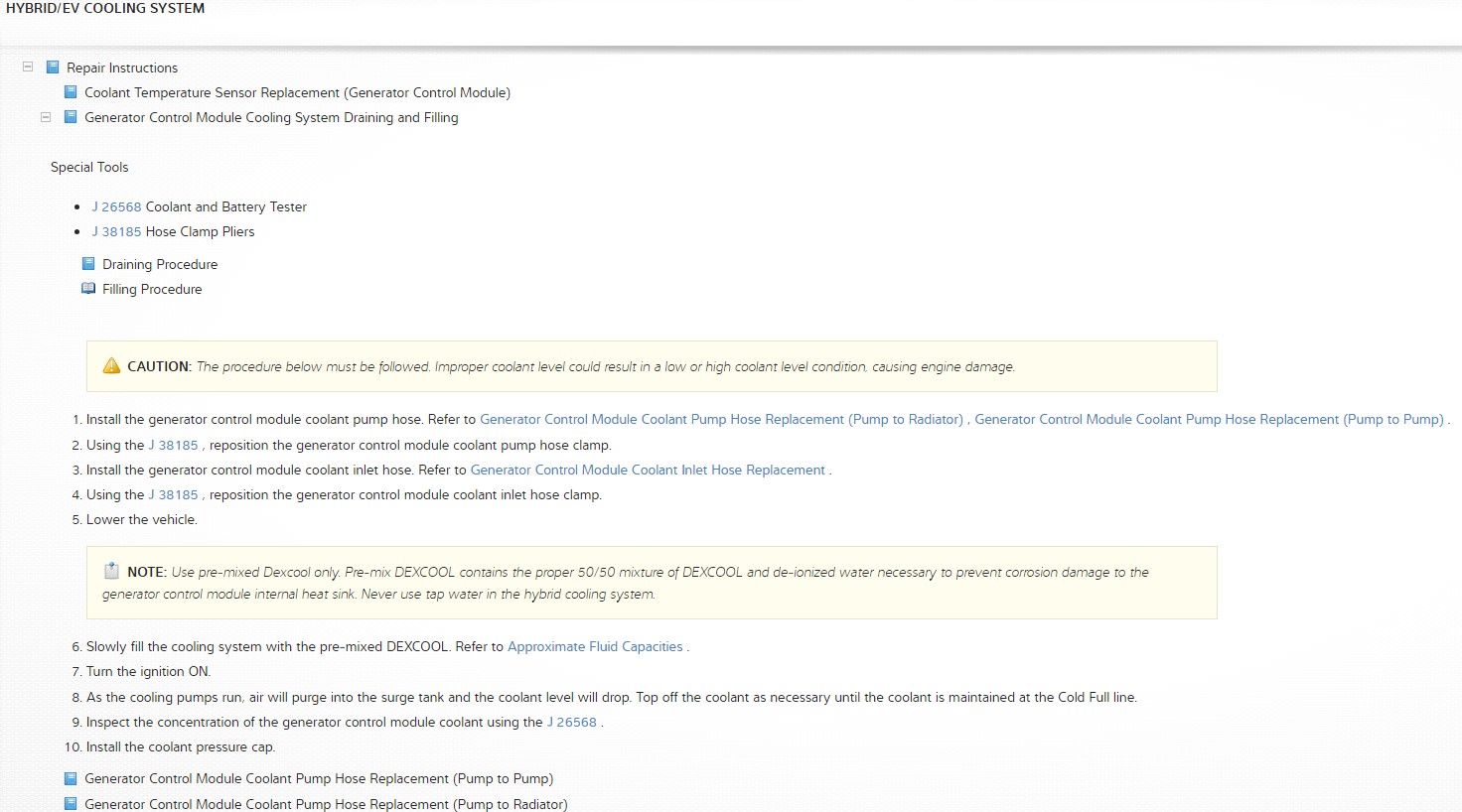

here's what my software says.
should be fine, just run the pump to work the air put before starting.
