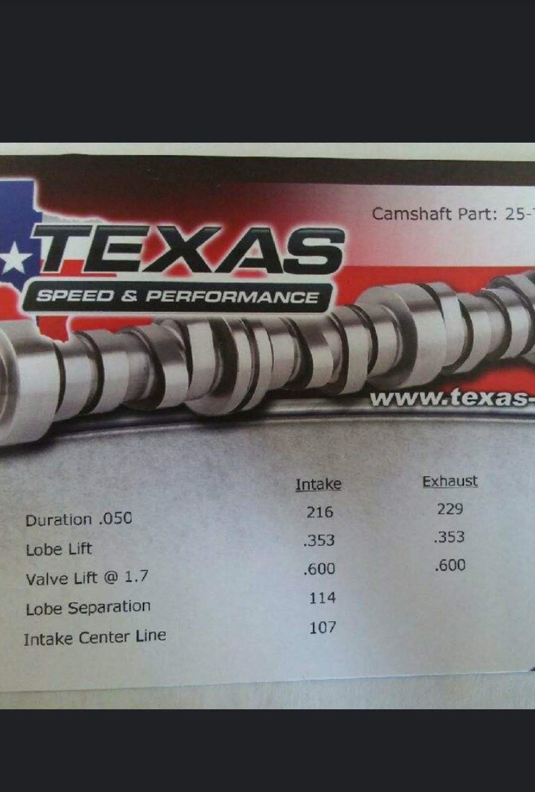

I went with TSP VVT-1 cam and I absolutely love it. There is torque all through the powerband, and after 4500 RPM it feels like the front end gets light. All I need are flaps and I could probably fly! Also, driving in the Rockies with this cam, almost makes my 6.2 feel like a diesel pulling.
Can you link your product webpage here? Whenever I search for my year/make/model the TSP website directs for Godzilla 7.3 cams.
I was just checking the site out, and it looks like Texas Speed doesn't offer VVT cams anymore. I bought mine about 3 years ago, maybe the demand wasn't high enough for them to keep making them.
Or perhaps the problems they were having with people installing them caused them to pull back.
