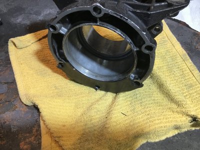

What brand was the new extension housing @YukonCrazy ? I’m wondering if it came with a cheap seal of it was aftermarket. Might just buy a new ACDelco seal and install it in that extension.
Pretty sure it was ACDelco.
Pretty sure it was an ACDelco. I will see if I can get a pic of the number on it. Also ran my VIN through the ac delco parts catalog and came up with the same part.
Auto Trans Extension Housing
Part Number: 24241496
Product Notes:
All; VIN: 0, RWD, Auto Trans, Eng Code: LMG, 4L60-E, 4 Speed Trans, Transmission*; VIN: J, RWD, Auto Trans, Eng Code: LY5, 4L60-E, 4 Speed Trans, Transmission*
Per Vehicle: 1; Years: 2007-2008
