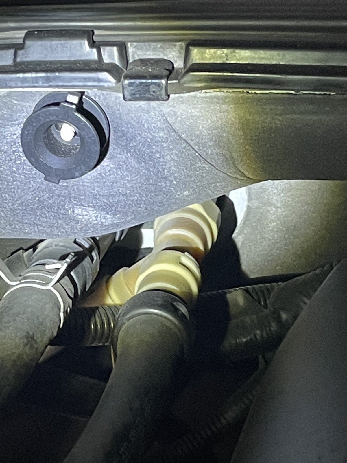

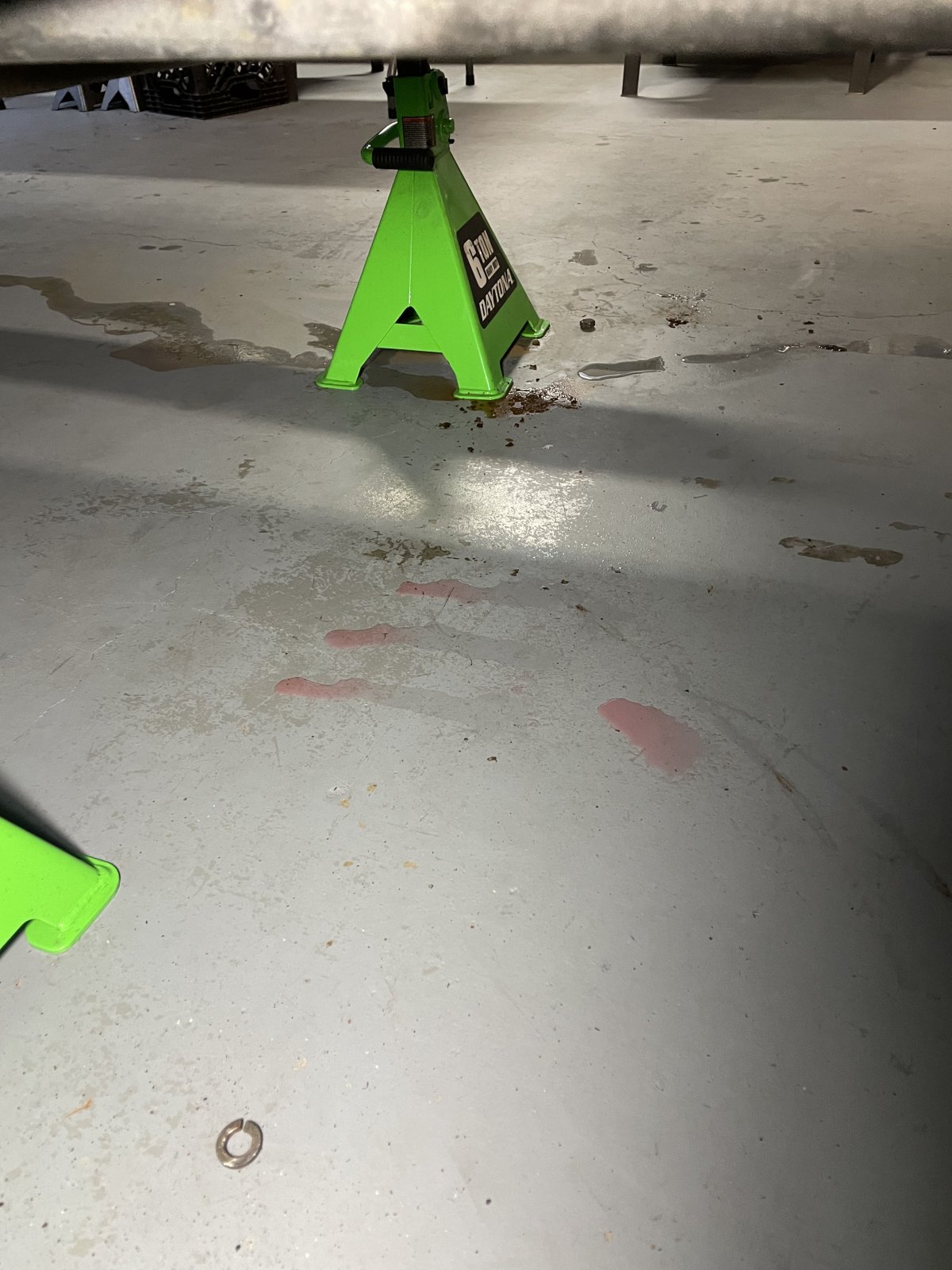

While working on my suspension leveling kit this weekend, I noticed a pool of water underneath the tranny. After a closer look, it appears to be coming from above and draining down alongside the tranny dipstick, hence the pinkish water in the photo. It seems to be intermittent, but today is seems steady. After reading a few threads, sounds like it could be heater core hoses at the quick connect or pump. I checked, but don’t see water coming from there. Any thoughts? It’s not coolant because that is orange color. This seems like water coming from above and running down transmission pan.

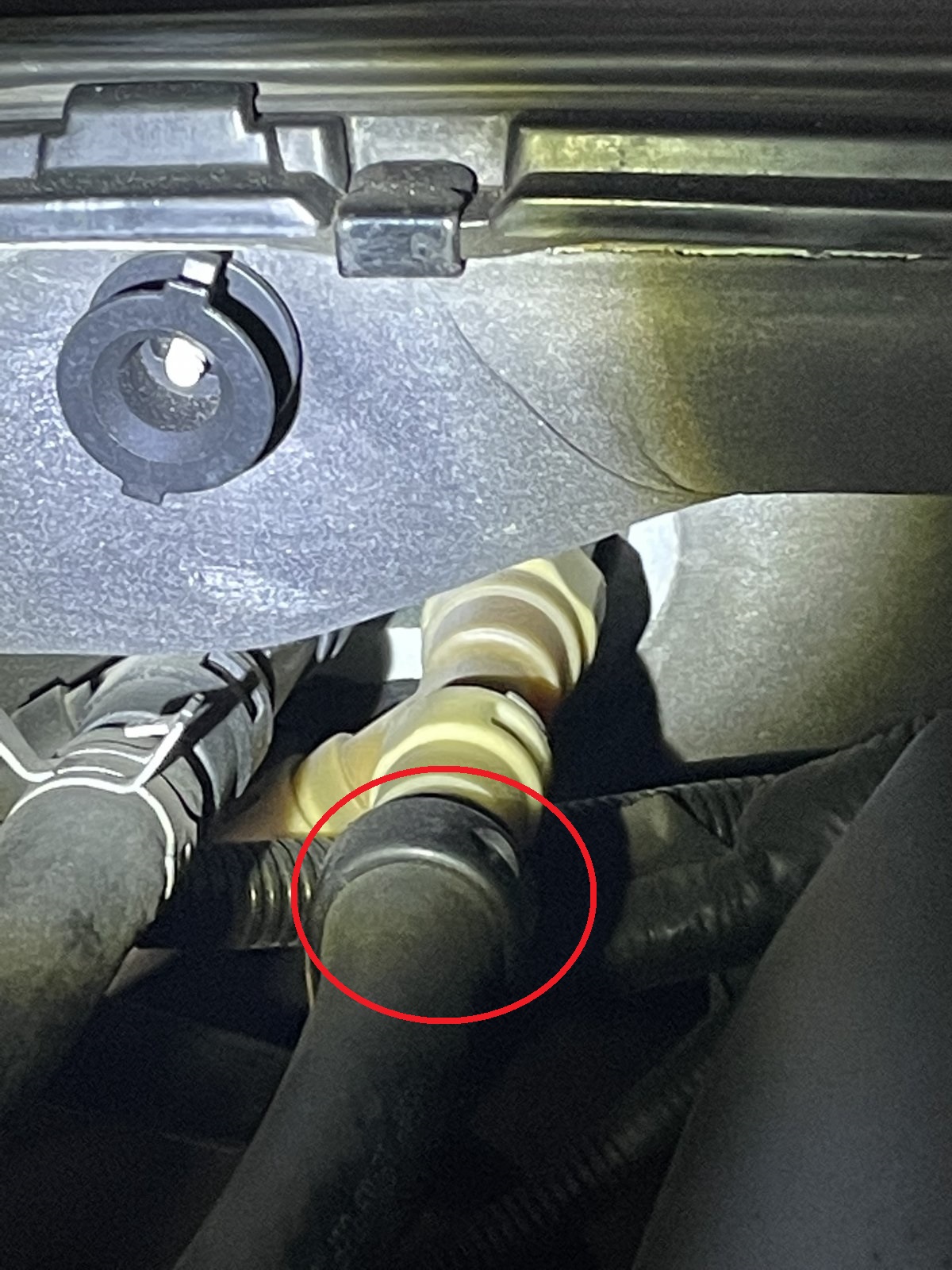

Found it. The heater hose Tee. Dripping right down the transmission dip stick.
Odds were in favor of the heater T's.
Much easier fix than a heater core! Pretty cheap too.
Members have said that rotating the T while pressing in on the lock tabs will hold the tabs in and allow you to slip the T off.
I did not know that when mine snapped at the hose.
I snipped at the the strip of plastic behind the tabs with small wire snips and busted the plastic with a flat screwdriver to release the fitting. Made removal easy-peasy.
If you do that...Just make sure you are busting the right fitting, if you are not replacing both at the same time.
I crawled out to get tools and when I got back under the hood, I found myself with hands on the wrong fitting! Glad I did not bust the wrong one by mistake!!
