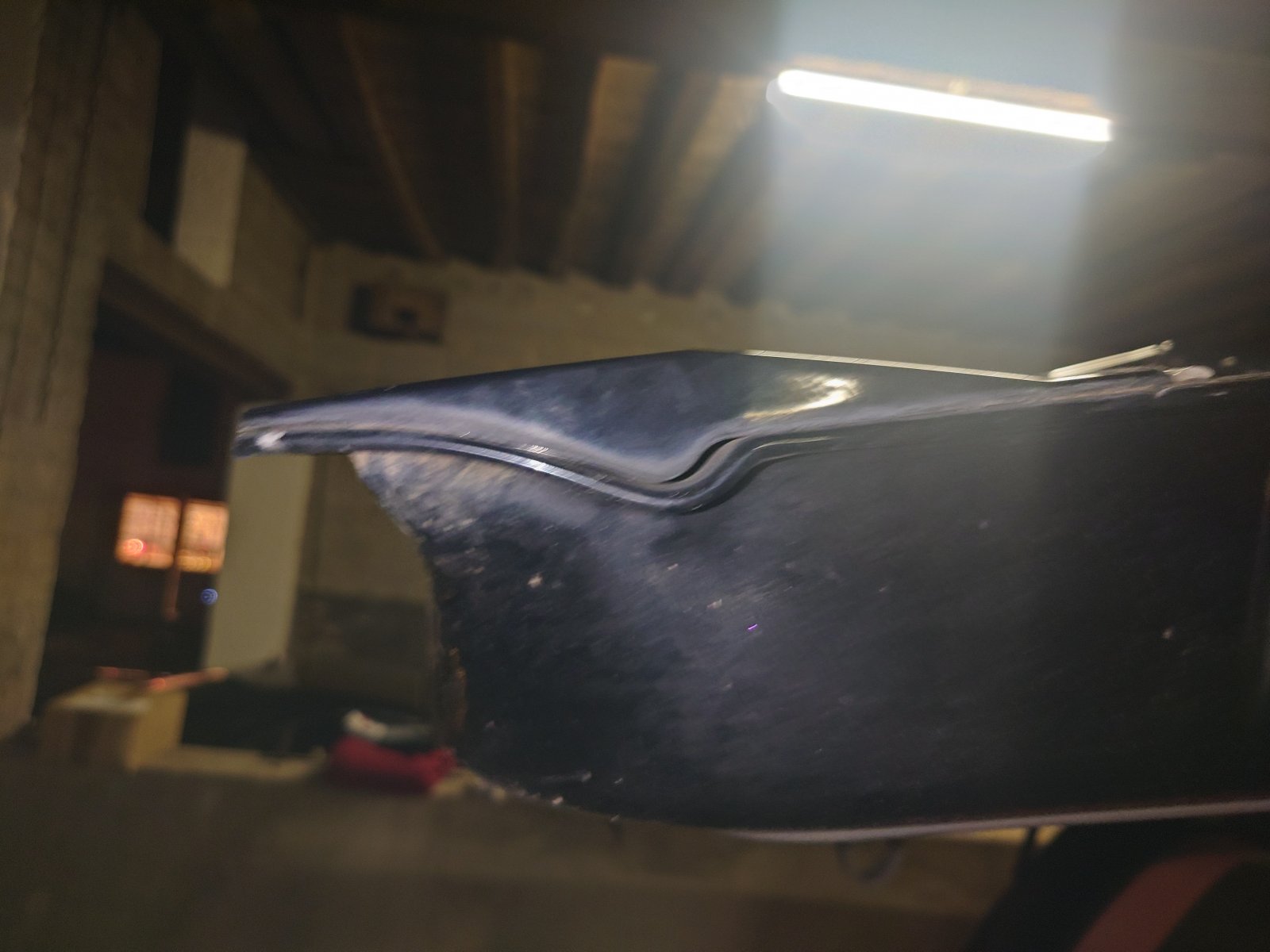

When I open my hatchback on my 2006 Escalade after washing the car, or a downpour water runs out on the sides of the plastic cover on the hatchback. That one at the bottom. There must be more than a liter of water in it.
This cannot be good and is certainly not intended to be so. Or do I have the camping model with integrated shower? :Big Laugh:
Are there usually drain holes that can be cleared? My tailgate also has efflorescence at the bottom of the edge. Is that where it comes from?

I am having difficulty picturing the exact are of concern. Post a few photos, if you have the chance. Point out where water collects or pours out. That would be helpful. Thanks!

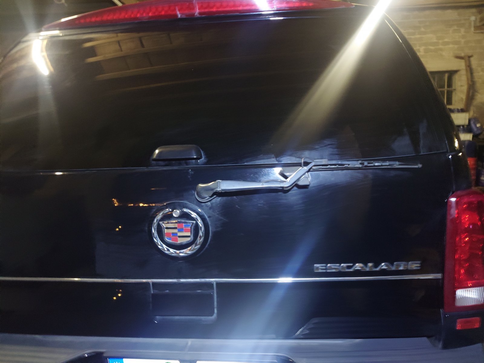

You are right. I'm talking about the plastic below the Escalade Sign and on the side you see a wave and on the picture on the right side so to speak, above the wave the water comes out. So the water find's it way into the plastic cover, but can not drain.
And when I open my hatchback, it comes out of the side....

That liftgate looks damaged, if I'm not imagining that. If that's true then there could be a tweaked or damaged seal or joint up higher, letting in water.
No that is only a light reflection. The Liftgate is absolute ok.. I think it must be a closed Drain hole.. But i didnt find one yet..
Yeah... You might be right on the seal.
If I had to guess, I would think GM might have used something between the plastic trim and the metal hatch to possibly keep water out, but at a minimum prevent squeaks and rattles. Can't allow squeaks and rattles on the premium truck line...
Maybe, there is a 3M gasket or seal on that piece that has failed. See what Esky owners or maybe someone who has done body work on these that knows what to look for and how it should be.
I agree the bottom of the tailgate in the second photo looks like it’s not lined up properly, like maybe it was hit hard with something.
There’s never that much water draining out of my tailgate after a wash or heavy rain so there’s definitely a leaky seal somewhere.
I have a hatch glass and third tail light off a 2005 Escalade ESV. And you’re correct there’s a rubber gasket glued to the leading edge of the base that mounts the third tail light to the Escalade glass. That gasket is mounted at the very top of the plastic base and covers the top of the lift gate and glass where it meets the roof of the truck. I believe that’s what keeps the water out. Maybe the OP should check that gasket.
There’s never that much water draining out of my tailgate after a wash or heavy rain so there’s definitely a leaky seal somewhe.
I don't think that there is something wrong with the structure of my Liftgate.
It has no deforming, but your text contents a very valuable hint.
Because my that third break light has a small crack and I am still looking for a good used one. So maybe it's worse that I thought.
Maybe the water comes in by the third Break light, run down inside of the hatchback and find it's way into the cover.
I think I will open up the inside cover of the hatchback next, to look whats inside of the hatchback.

Wait, do you mean water is accumulating at the top near the center brake light or the bottom cladding that's near the bottom when closed? I thought you meant in the bottom cladding, which I think is attached with double sided tape.
It sounds like water is leaking into the inner guts of the tail gate somewhere and then draining out when he opens it up.

I guess that's where I'm confused. If it's coming out of the hole shown in the second picture he posted on page 1, that kinda looks like the water is trapped behind the Escalade cladding at the bottom of the hatch. If it's inside the actual hatch structure, that's way different
Yeah a little confusing for sure. Hopefully OP will clarify. In the 10 years and the many NBS escalades I’ve detailed for my clients I’ve never seen water pool in the outer part of the lift gate in between the lower caddy cladding and gate itself. Especially not enough to drain out buckets and buckets of water when the lift gate is opened up. Lol. That doesn’t mean it’s not a possibility though.
