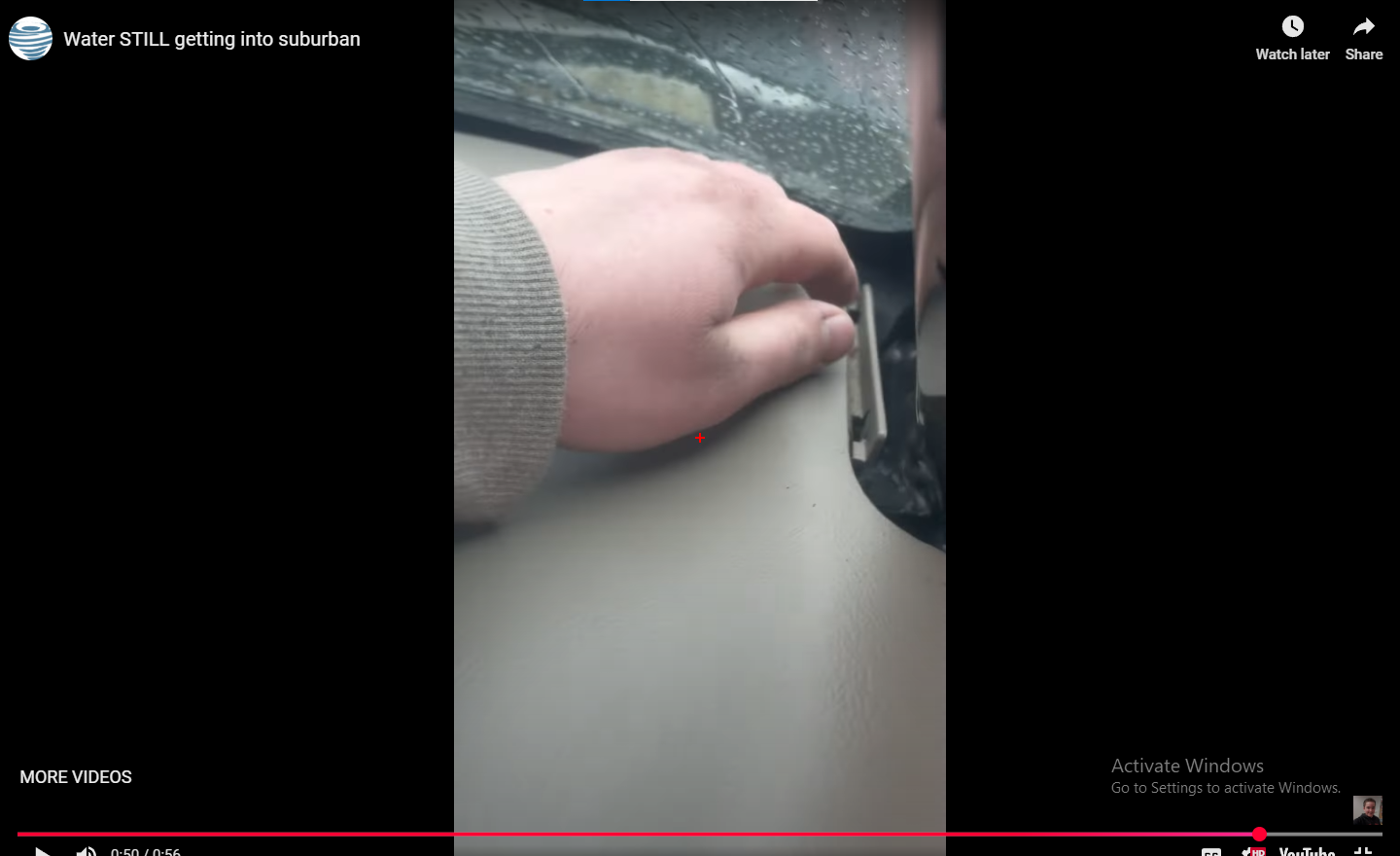

Not sure how the resistor is looking, but everything is working fine. But not good news, water is STILL finding its way inside the stupid thing, so this is not totally solved today. Antenna seal has RTV all over it, put the permatex on top of the windshield, and it's not getting all over the dash and everything anymore. Cowl panel looked fine but I still put RTV around the sides to be extra sure, and I put RTV around the door boot seal to be sure. I have no idea where this water is coming from. It is coming from higher up and dripping down onto the floor and all over the wiring for the door.
What haven't I checked? No sunroof or anything on this one. AC doesn't work so I dont think the drain would be a problem.
Heres a video.

Thank you! Not sure if my leak is the same as yours though. Took a hose today and sprayed the whole cowl area with water, not a drop of water. Sprayed all around the windshield, and thats where I saw a drop of water streaming down on the side by the foam I showed in the video. I'm sure that'd get into the blower motor! I think I find myself and needing a windshield again.
Heres the pic to where Im talking about, right where my hands going:
I have read all of this and several posts back, your testing and results made me think the w/s reseal/replacement is needed. If you have comprehensive coverage, crack it and send in to insurance. I would get any seals that are with it, on each side or above, and have them done at the same time. Do not count on the seals being part of the w/s install.
