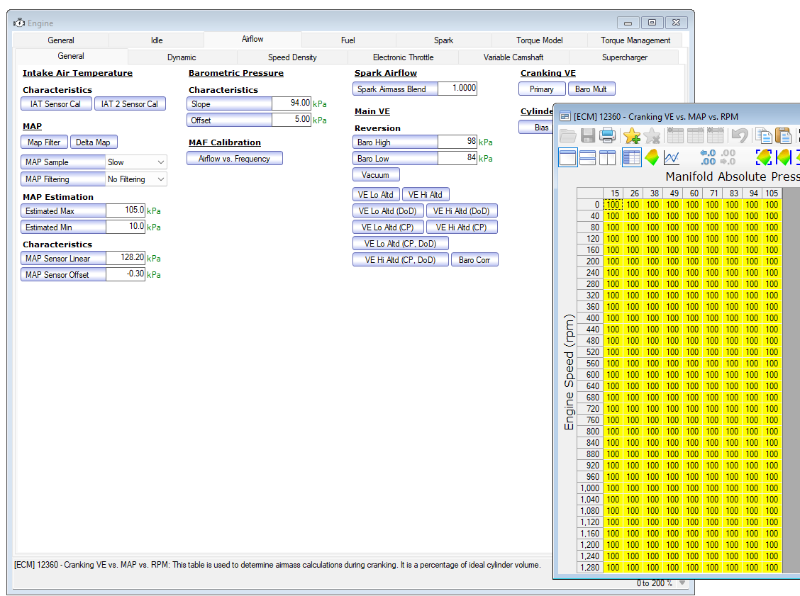

Did your tuner reply back? I have been a tuner for 20 years, and it is mega common to need to tweak the hot start with a cam. You generally have a guessed base adjustment on cranking VE to compensate for the change in cranking efficiency from a cam. You start with a rough learned value based on the application, then it sometimes needs slight adjustment to dial in. It's never an issue when cold because all the extra air density has no problem lighting too much cranking fuel.. it becomes a problem when the engine temp is up.
It could be adjusted too much, or too little, just takes a quick couple changes to nail down.
Hagar! Long time no talk (since I had that KR issue)
Is this the adjustment, or somewhere else?

See if 85 helps. If it gets better but still struggles, go to 82. If it gets better at 82 and still struggles, go to 80. Go until it stops getting better and starts getting worse, then back up to the best point. If it isn't starting perfect at that point when hot, let me know and we can go into the throttle opening tables. The modern stuff is all about balancing the throttle opening with crank fuel, and then how it comes down from the points you find that get it started. The ve cranking should fix it with the small cam, but not all small cams act the same. Sometimes things just stack up weird with cams and air intakes and exhausts and stuff. Normally straight forward, but can once in a while need a little more attention. I am sure this is the case with your tuner. Just one of those ones that normally works well, but things in your combo are creating an abnormality.

He will know how to fix it. No need to tell him what to do, it's super common knowledge for someone that tunes as much as him. I was giving some DIY advice if it was changeable on your end, if he has it locked down, all you can do is wait.
Locking tunes is a choice some make, I have personally never locked a tune in my life. You either know what you are doing or you don't. I have done tunes for people while knowing they fully intend to try and reverse engineer it, it has never once created a competition for me. The numbers are useless if you don't fully understand what they all mean, you can't just input numbers from one tune into another, unless you want just a generic tune like a handheld store bought, for a near stock vehicle. I think some people do it also so it doesn't make them look bad if someone messes with things and breaks something, but as far as I am concerned, you paid me, it's yours to do what you want with. I of course tell people to not mess with it, but it's their vehicle to do what they want. I bet 50 percent of the stuff i tune these days has its own hp tuners because people thought they wanted to learn how to tune, but couldn't figure it out. Lots of them have the training books and everything. If you know how to tune, and read those books, it's comical the info they give you. It's like giving a mechanic a single screw driver, and telling him to rebuild an engine.

"adjust cranking VE" (Volumetric Efficiency) ... @hagar said.

Read of some other changes to help startup. Dialing in VVE being the base of it..
But there is a startup airflow (idle) map as well...
I wonder if multiplying those values by .85 would be the same as adjusting cranking VE to 85? However this map references temperature, unlike cranking VE map.
Or does this affect transition after starting to idle speed only?
(Does engine run time include cranking time?)
I know BBP will fix it, just posting for our(my!) own curiosity..

Read of another method to help startup...
There is a startup airflow (idle) map as well...
I know BBP will fix it, just posting for our(my) own curiosity..
View attachment 446241..
I use that table as well. Some big cams have a hard time finding idle, so I will often use that table in conjunction with initial idle rpm adder vs time at start up to give the engine a crack of the throttle at start up, then bring the idle down over a short time gradually. As a bonus it sounds cool. Lots of exotics start like that.. quick rev after start, hold for a few seconds, then they come down to idle.
