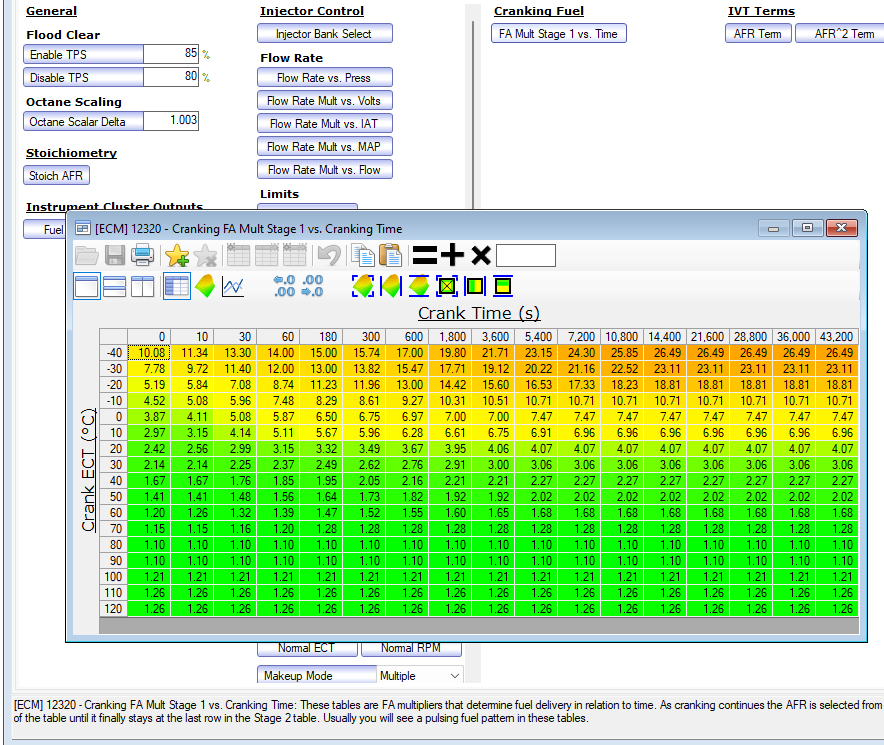

Also notice this table, I have NO IDEA if it's related to your issue or not.. And I don't see the stage 2 table anywhere either..

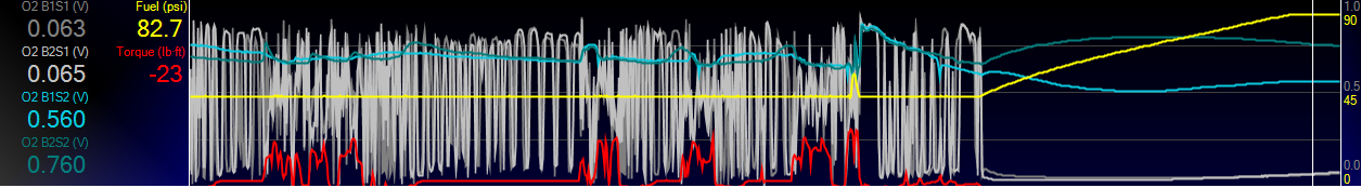

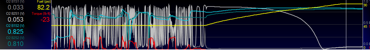

I may have exaggerated. I only find a couple logs where it climbs to 82psi..
That was only a a 60 degree day, but the pressure does seem to plateau right there.
Perhaps the fuel is leaking past the pump, or some pressure relief valve, back to the tank?
Took about 2 to 2.5 minutes from shutdown.. ECT was 194 degF on shutdown for both.
(sorry the 2 graphs are zoomed different amounts, top one took 2.5 minutes, bottom was 2 minutes)
