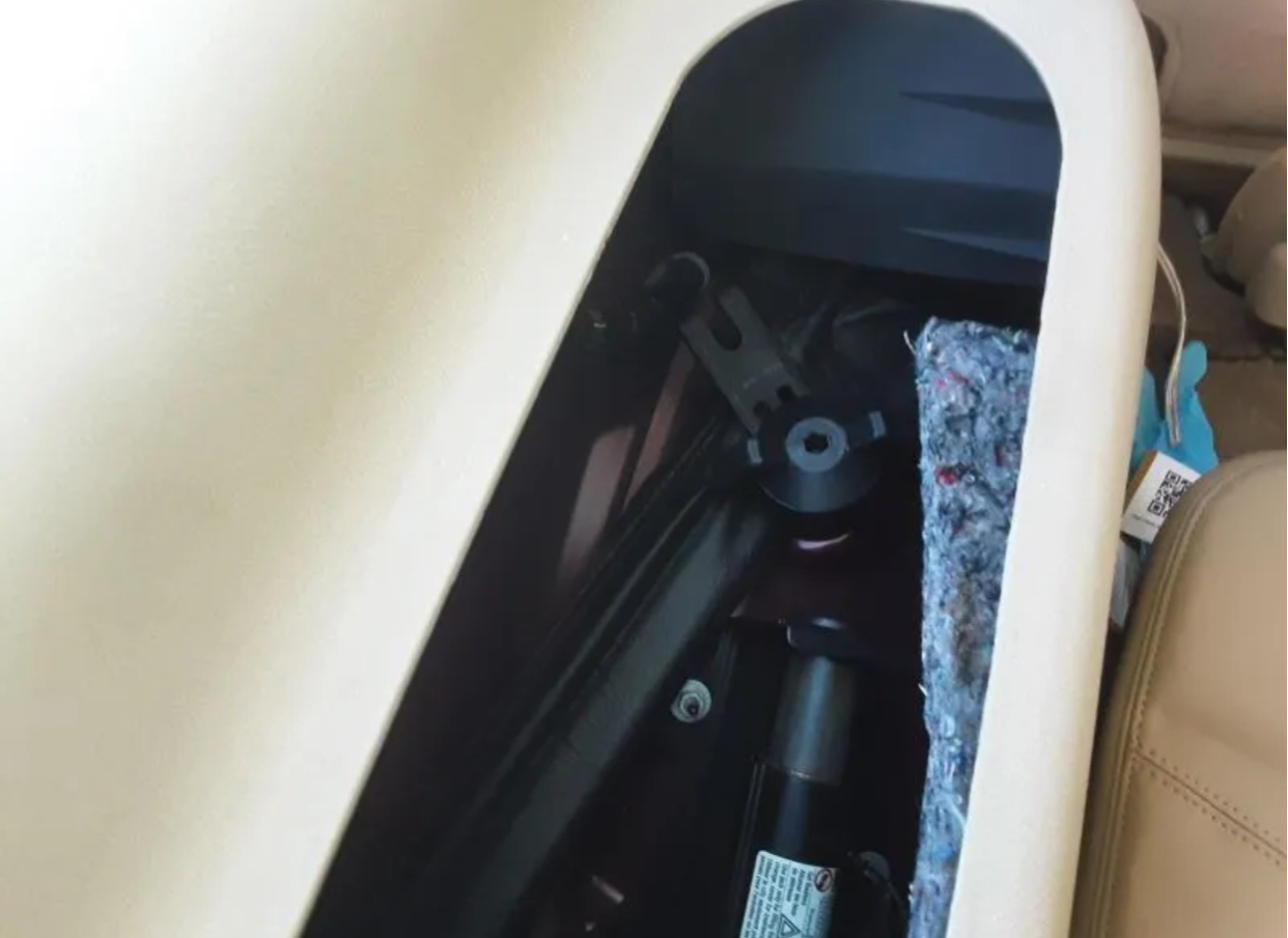

Is that a side view looking to the left in the Tahoe & non XL / ESV Yuke & Esky?
I think GM put the jack in the forward / top (removable) bin on the NNBS XL trucks so you have to fold down the p/s 3rd row seat after pulling the recessed bin cover off.
You do get the advantage of having a side storage bin with a cover where the Tahoe usually has its jack stored but you pay the price when it comes time to access the jack and tools in an XL.
A quick look shows the Esky shorty’s have their jack stowed next to the base of the 3rd row seat after the cover on top is removed. It works, but you’re SOL if there’s luggage or dogs back there at 3am on a rainy night. Knock on wood.
Sorry if going off topic on a Vac prep thread. I can’t remember on our 06 YXL Denali if the jack was in same place as 07-14 but GM did put it in the panel next to the lift gate on the NBS Tahoe & Yuke shortys on # 16 below

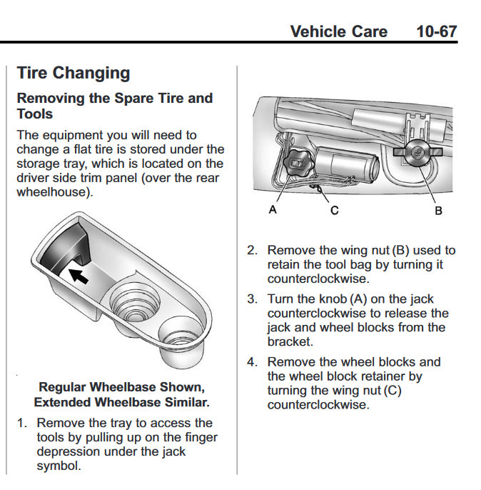

Yes, the diagram I showed is for a GMT800 Tahoe in the left rear inside quarter panel.
Here's the one for a 2012 Yukon XL (still only wing nuts and jack knob holding it in place):
