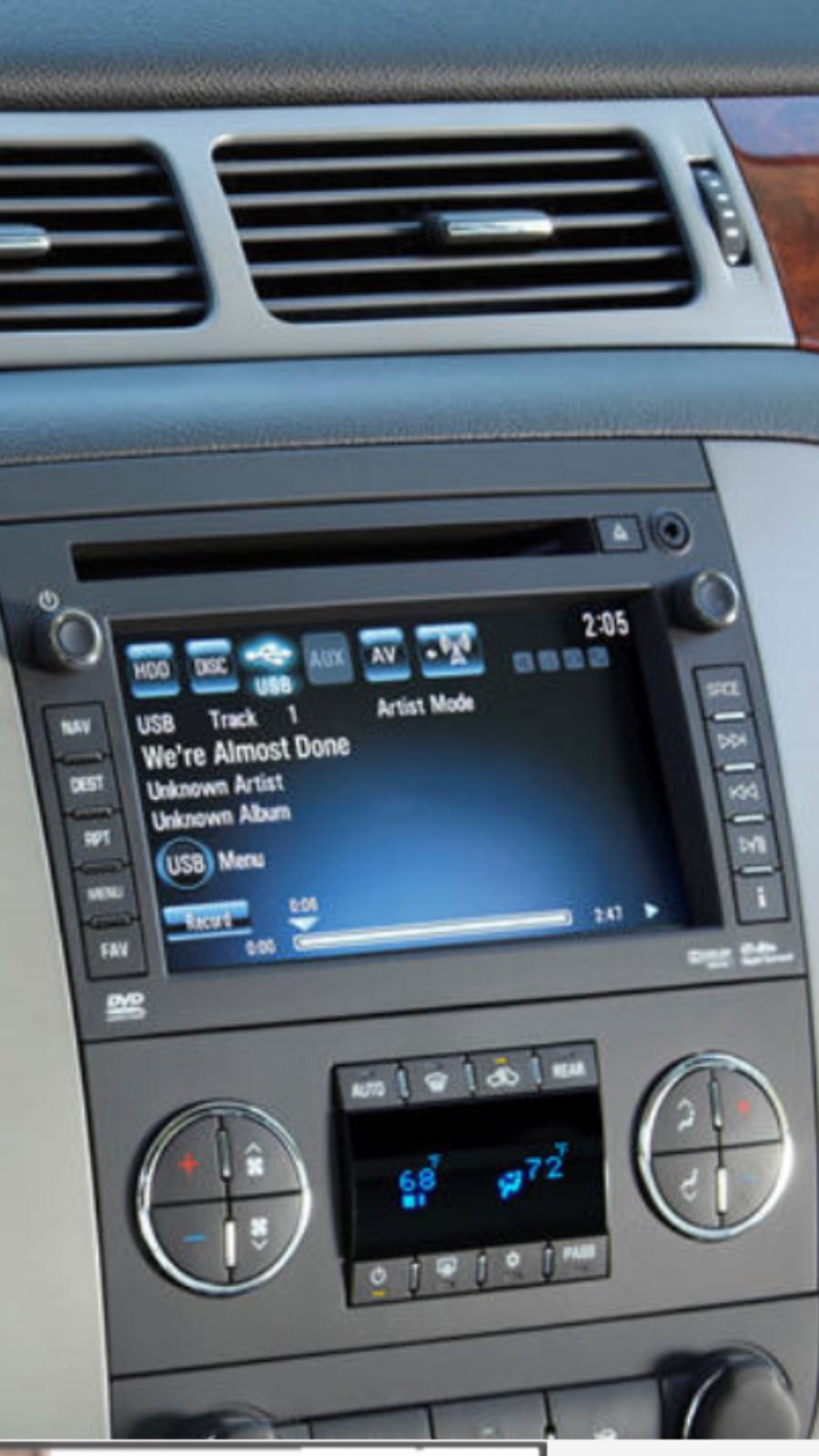

How would I go about getting XM radio to work with this head unit?
Here’s your user manual for 2010. You may have a HDD hard drive Navi system that can pause live radio & store music internally.
If your truck does have the HDD Navi (2010/11+), the XM receiver is located behind the glove box. This means you can add a $59 AD2P music streaming module that integrates directly into the factory controls.
Open Glove box, release the plastic catch so the door will fold down all the way and look up on the right side for the xm tuner that has XM traffic integrated. If it’s there, you’re stoked. To activate XM regardless, call them for a free trial. The best deal is $99 for the whole enchilada for 3 years. XM traffic is about $129 for 3 yrs.

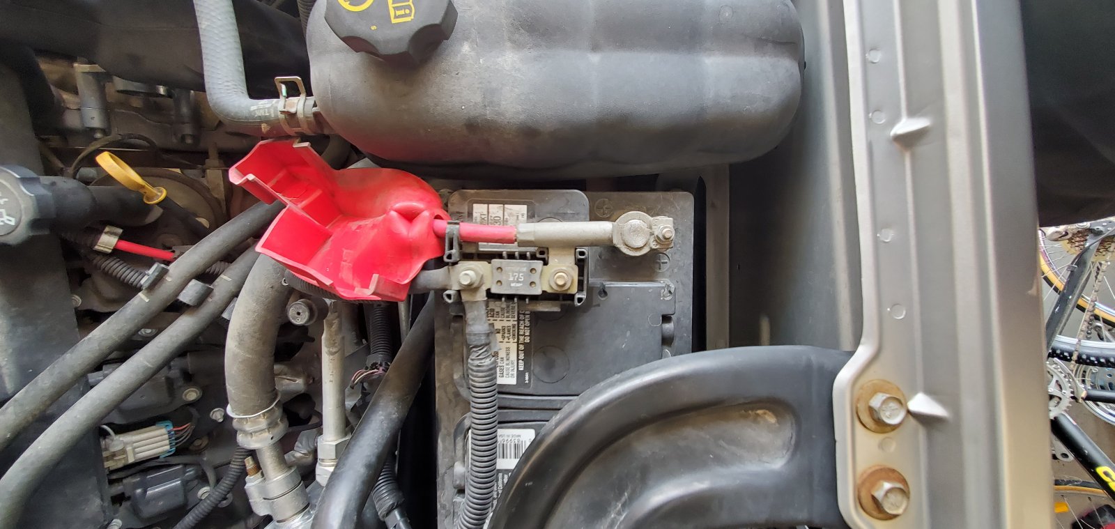

@iamdub - want to make sure I understand big 4 properly:
1) 1/0 wire alternator to battery positive - clear
2) Battery negative to frame - completely remove the factory negative battery cable and run a new 1/0 cable from battery to where? Is this replacing the very thin wire from the original negative cable that goes down to the passenger side body mount bolt and that's where I should take it?
3) Engine block to frame - I believe this is the short wire I've seen in your pics from power steering pump to under engine mount bolt, right?
4) Body sheet metal to engine block - pinch weld at the cowl - should I make this 1/0 if I've got some extra wire?
There is no longer a battery negative to engine block cable?
Also, which of these cables goes through the RVC now - #2 above?
45,012
1) 1/0 or whatever your wire size of choice is. The same size should be use for all new connections as the circuit is only as strong as its weakest link
2) To frame or engine because you'll be running a wire from the engine to the frame of the same size. Battery to frame is shorter, though. Don't forget to route it through the RVC sensor.
3) Correct. The shorter, the better. That was the most convenient points to connect.
4) No need to make it 1/0 cuz you're not running that many amps through the smaller accessories in the body. If it makes you feel better and you have the material- knock yourself out. I think it'd be more of a nuisance bolting a 1/0 to the cowl, though. And you already have the factory 4 gauge, so why not use it?
No. But they're all still equally connected electrically. Battery to engine to frame, battery to frame to engine... all the same. Just like body to engine or body to frame would be the same. The wire is large enough to support all loads of all systems to their maximum capacities with room to spare.
Yes. You don't want any cables bypassing the sensor. The sensor needs to read the total amperage your car is drawing off the battery. Any circuits bypassing the sensor will allow loads to not be detected. Electricity takes the most conductive path. Having a 1/0 bypassing a 4 gauge through the sensor means pretty much all the current will be going through that 1/0 and the sensor will be seeing virtually no load being drawn.
