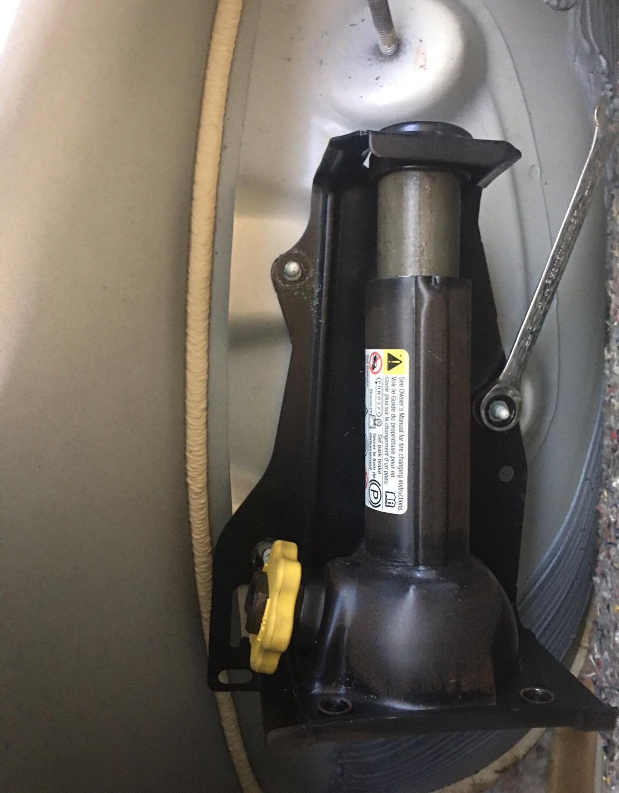

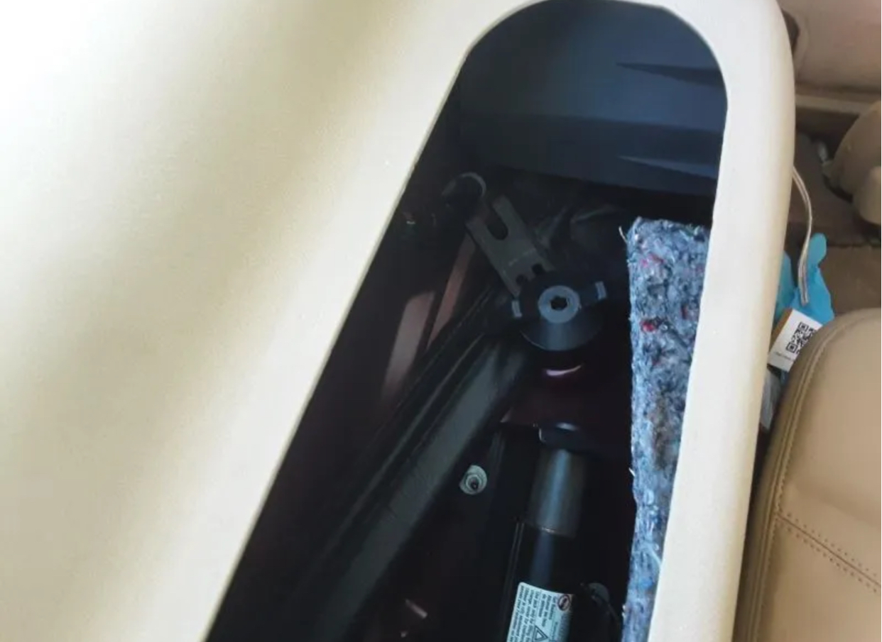

Pull the panel where your bottle jack is located. Unscrew the lug wrench jacket and verify the jack isn’t secured with standard 8mm nuts. If it is, remove one with a ratchet and replace all 3 with wing nuts from the hardware store or your not getting that jack out later.
If the jack is stored per the manual instructions, no tools are needed to remove it. It's all done with wing nuts and the mounting bracket stays in place with the regular nuts.

Regarding the factory bottle jack. Both our 08 YXL Denali & 09 Esky ESV had 8mm hex nuts painted in factory paint securing them to the weld on studs. I’ve got no dog in the fight over whether it’s factory or not, but it’s a thing that takes 5 min to verify.

That's a bracket that does not have to come out as it just holds the bottle jack and chocks.

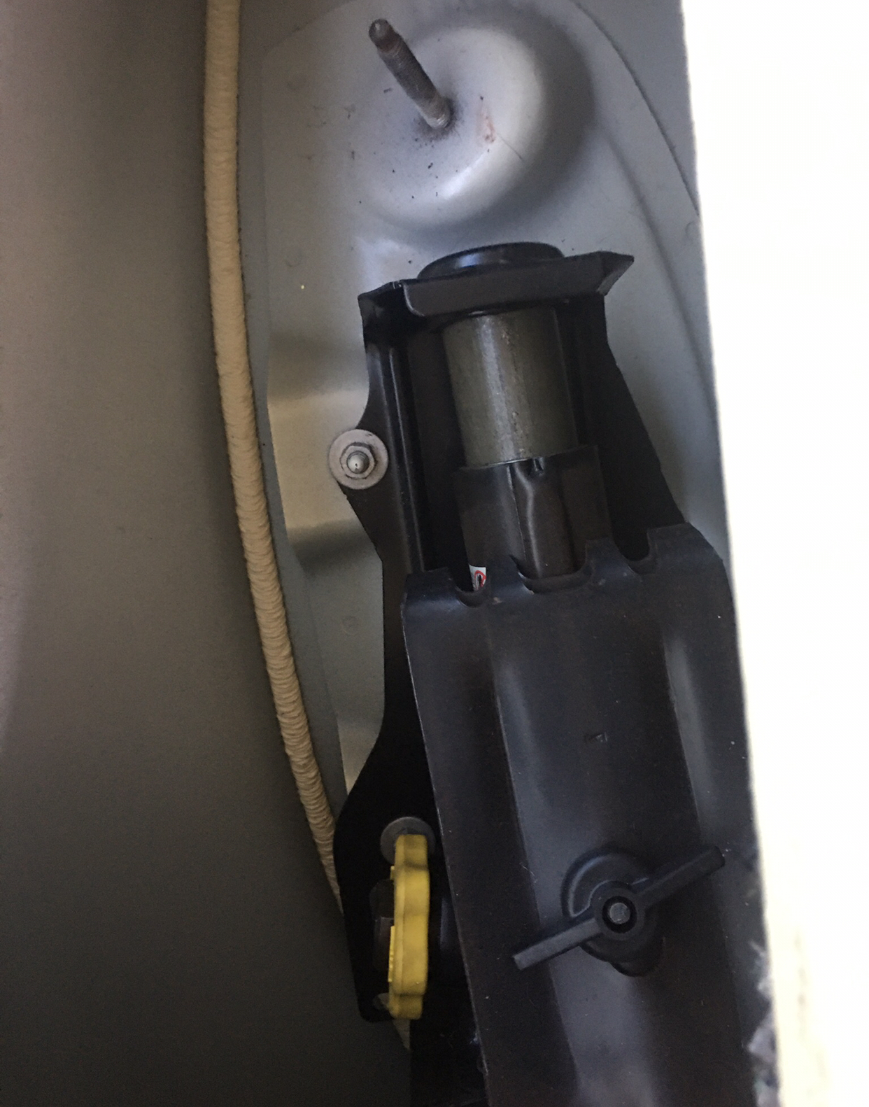

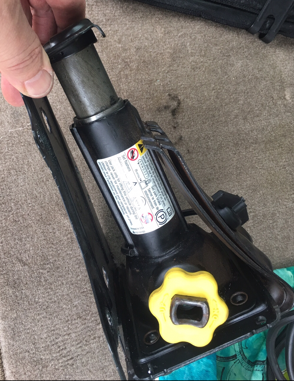

Bruh... You don't remove that bracket. You remove the large wingnut with the plastic wings. It's holding the wheel chocks. Then, you twist the knob to "lower" the jack so it comes out of that bracket, which, you would have had to do to use the jack, anyway.
Hahahaha on me, several times!!! Without pulling the entire jack assembly attached to the bracket it’s a nightmare. Reassembling it and all the components outside the compartment is a he’ll of a lot easier. I inadvertently did a work around. At 6’3” navigating around in back isn’t fun. Especially at night, less time spent back there’s worth it.
45,012
No doubt it's a puzzle in there. I wish I had taken a pic or two of how mine was assembled before I removed it. With all the extras I have crammed in there with it, plus the loss of space from the power liftgate assembly, it has to go back together exactly as it was originally to be as compact as possible.

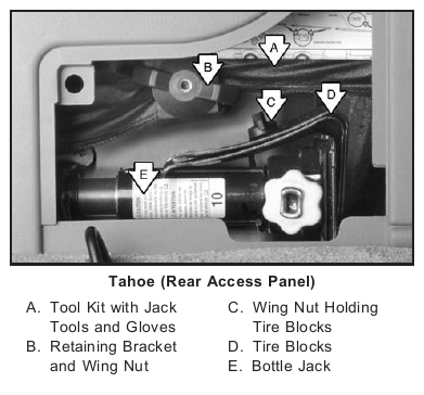

RTFM Puzzle solved....
Pic from my GMT800 manual YMMV

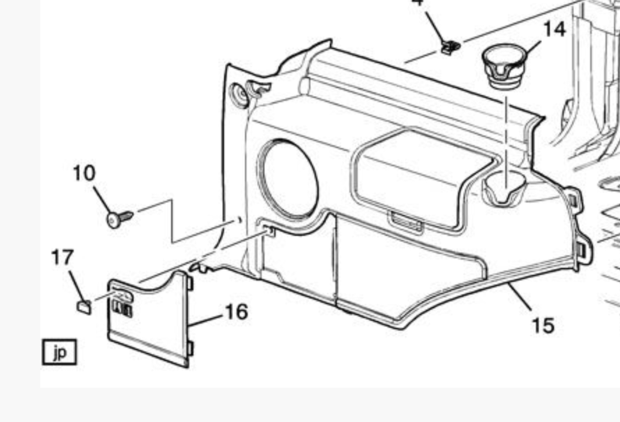

Is that a side view looking to the left in the Tahoe & non XL / ESV Yuke & Esky?
I think GM put the jack in the forward / top (removable) bin on the NNBS XL trucks so you have to fold down the p/s 3rd row seat after pulling the recessed bin cover off.
You do get the advantage of having a side storage bin with a cover where the Tahoe usually has its jack stored but you pay the price when it comes time to access the jack and tools in an XL.
A quick look shows the Esky shorty’s have their jack stowed next to the base of the 3rd row seat after the cover on top is removed. It works, but you’re SOL if there’s luggage or dogs back there at 3am on a rainy night. Knock on wood.
Sorry if going off topic on a Vac prep thread. I can’t remember on our 06 YXL Denali if the jack was in same place as 07-14 but GM did put it in the panel next to the lift gate on the NBS Tahoe & Yuke shortys on # 16 below
