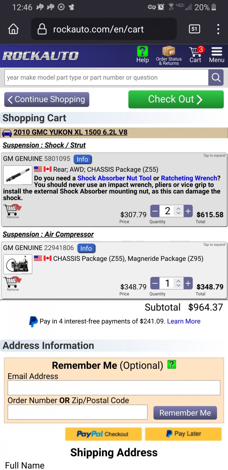

Does this look right if I go OEM? I still have to think this through, but there was a lot of lean when we had all of our stuff back there.
They talk about a shock absorber nut tool - do I need one?
And you guys feel like someone like me (a non- car guy) can do this?

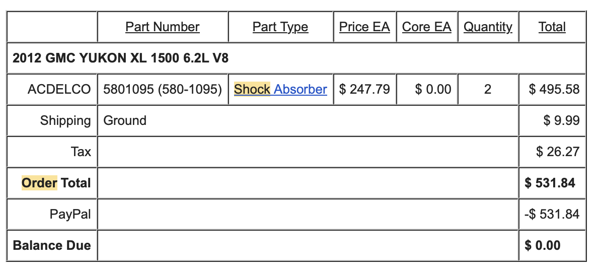

Yes. 5801095 is the part number I installed on my 2012 exactly 3 years ago:

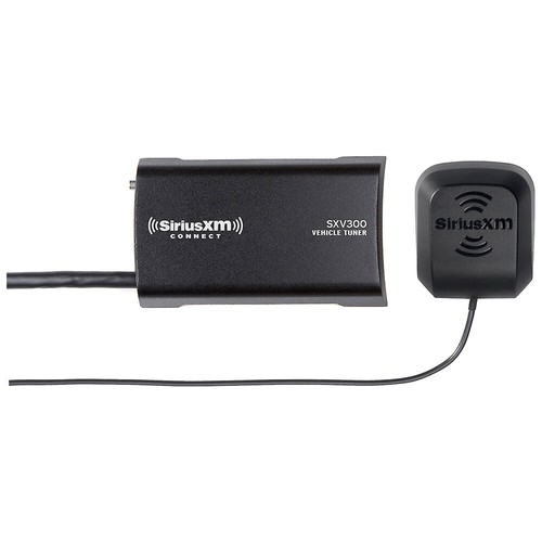

How would I go about getting XM radio to work with this head unit?
depends on the year. if yours has xm already and if it is a separate unit then it can be made to work thru the speedometer cluster, if it is built into the headunit then you need a
svx300 tuner kit which runs about $45 then it will interface directly to the aftermarket radio
