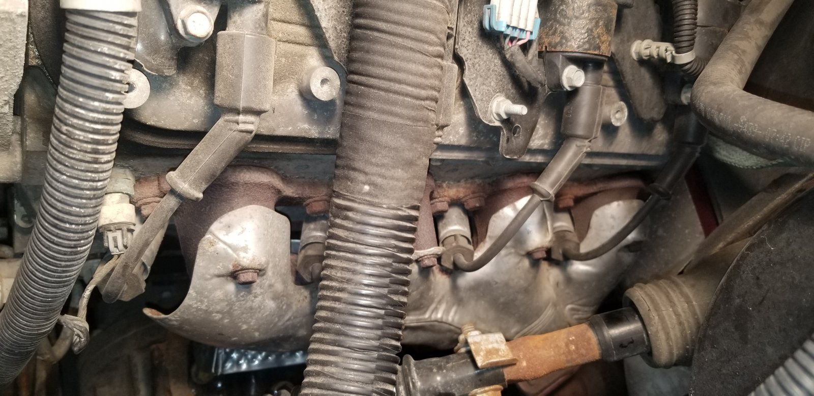

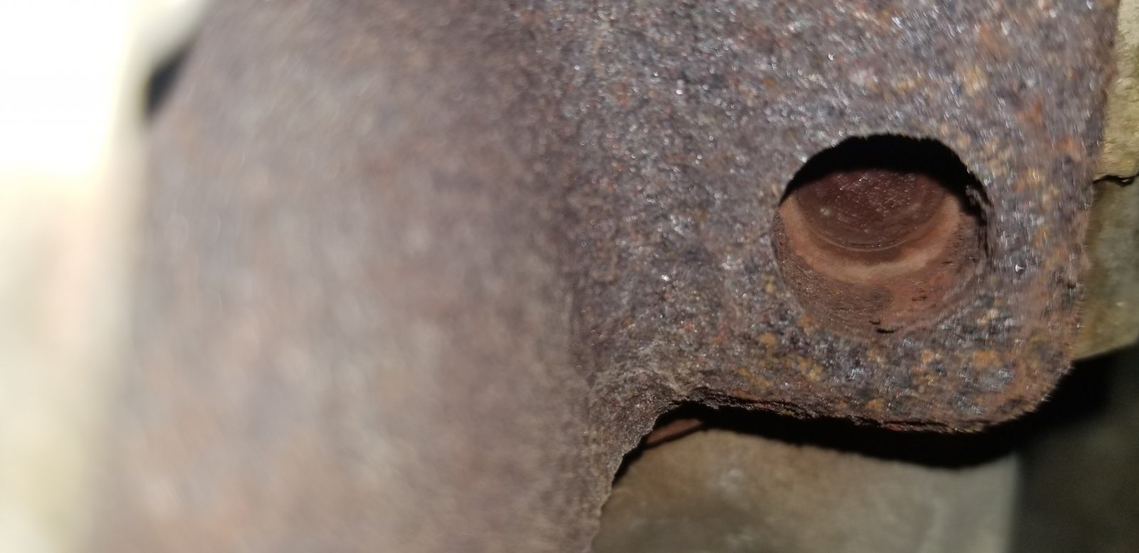

Ok, checked the exhaust manifold bolts. I'm pretty sure I'm looking at the right thing, but a little out of school on this. On the passenger side, I see all 6 bolts. On the driver side, I'm missing the one closest to the firewall. Pics attached. What are your thoughts?
Typical as it's most often the outermost bolts that break. Get >THIS CLAMP< and see if your ticking stops.

Ok, thank you for all of the info. This one at the back seems like is going to get past my capabilities. I don't see myself being able to successfully remove everything you did to get access and then get it all back together.
Any good tips if I wanted to give it a try, or should I just take it to a shop?
Honestly, I wouldn’t worry about it until you get a consistent leak, which may be a long time.
Ok, so nothing catastrophic will occur at this point? I'm thinking I may try to tackle it once I get back from my trip. If I don't have to rush into it and take my time, I'm sure I could do it.
Nope, nothing catastrophic will happen with a missing stud or 3. Send it!
