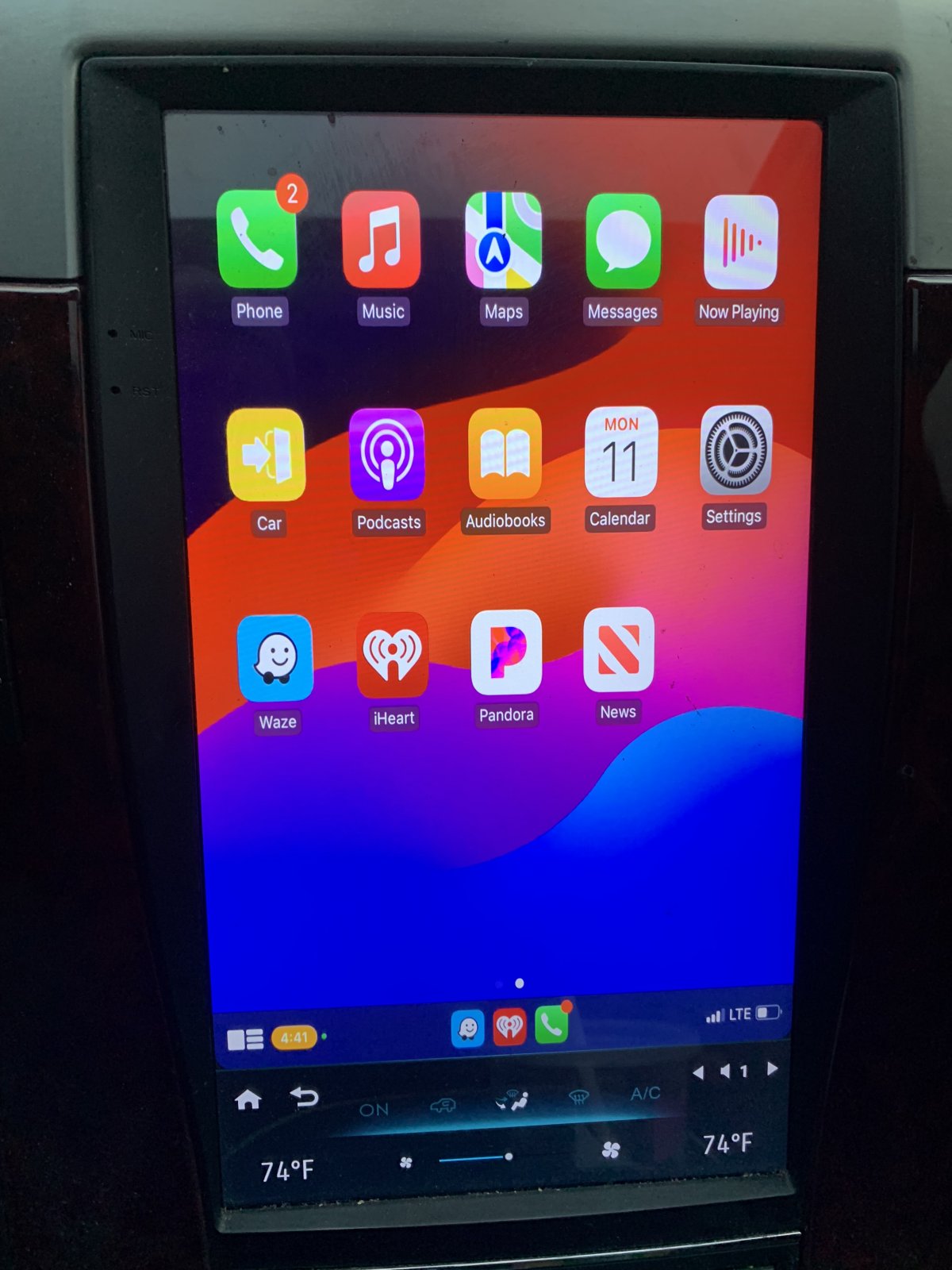

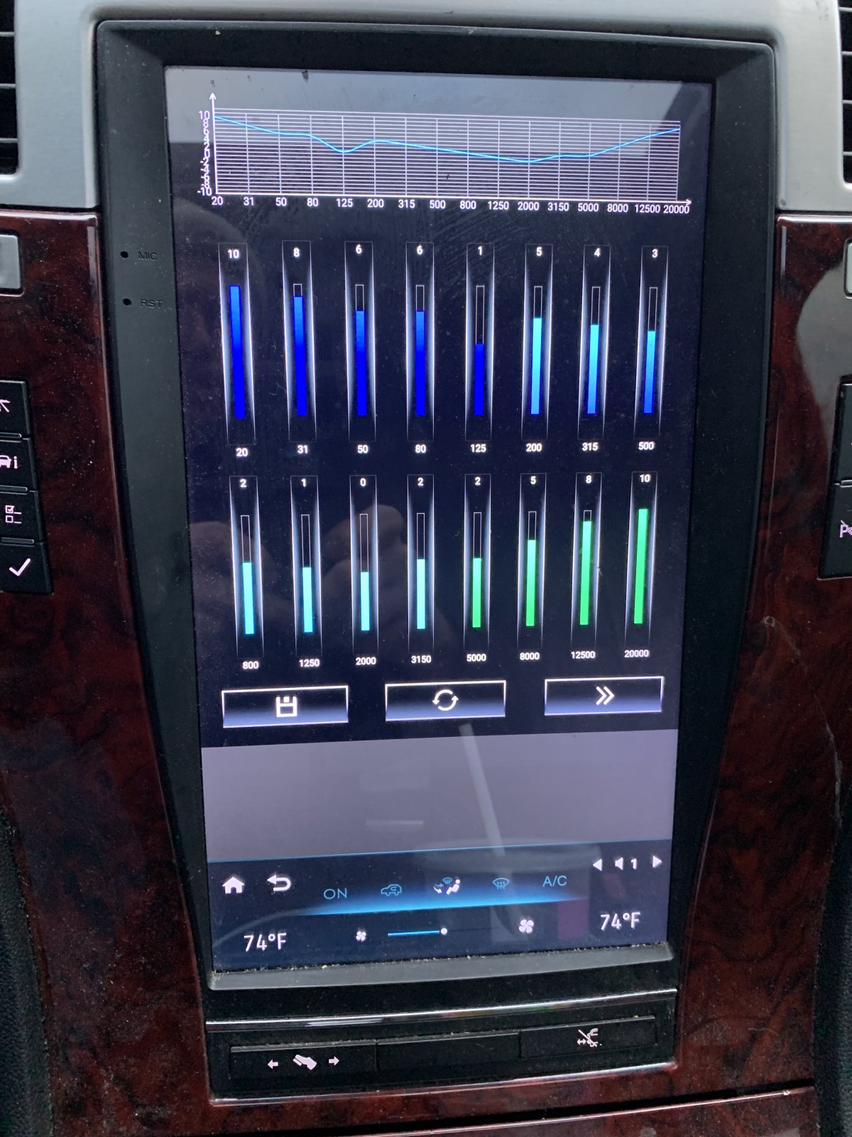

IMO The caveat with the Bose system is it’s a Boses system (heavily integrated) and it’s a 1.8olm setup. So they’re sacrificing higher volume levels for better sound quality. Upgrading your headunit can get you more options to tweak your Bose system to your liking without losing wheel controls. I upgraded to this android setup a few years ago and it’s absolutely amazing, I couldn’t ever go back to the OEM. It opens Pandora’s box to the google apps store for different EQ’s and tons of other things you shouldn’t be doing while your driving ie. YouTube, Netflix,Disney +… I’d also grab one of those cheap harbor freight tool kits and put store it in the 3rd row hidden cup holder compartment. You be surprised in how much trouble you can get into with a ratchet, 10,13,15mm socket and a few wrenches

Wow!!!! What is this!?!

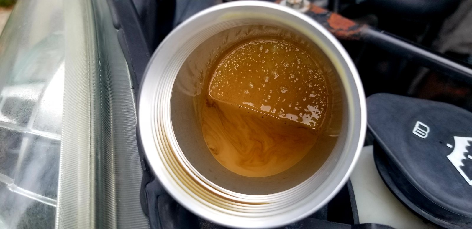

I was not expecting to have this much "latte" in my oil catch can after only 250 miles. Is that possible? The picture is a little misleading - it covers the entire bottom and is up the sides about 1/8”.
When I looked after about 100 miles it was just straight oil (wish I had taken a picture).

I bought it on Aliexpress, they call them “Tesla style android head units”. They’re basically unbranded tablets formed to fit the dash that communicate with the vehicle via canbus. You can find them on eBay and Amazon but the best price is buying it from china through aliexpress or Alibaba. If you or anyone else is interested in one of these android head units I’d highly recommend joining their private Facebook group. It’s about the only place you’ll find support or trouble shooting help if you run into issues or need help figuring things out. The group founder also writes custom firmware upgrades to correct some of the loose ends and custom background styles. It has a very similar to this forums atmosphere, very active with a wide
knowledge base and quick to help out.

Your environment (temperatures and humidity) will affect how much moisture you have in your PCV system. It seems that this is a lot more common in colder areas. Maybe even more midwestern. Never get it here.
This is why cars subjected to lots of short trips can have bearing failures despite the low mileage. They're not driven enough to get the oil hot enough for long enough to steam out the moisture. Was the weather warmer when you checked it at 100 miles?

It was mid 40 to low 50 degrees in the area after the first 100 miles - nearly all highway miles (all oil and a drop of water).
The next 150 was nearly all highway miles with temps mid 40s to just cracking 50 a day later (more moisture).
These are unseasonably warm temps for this time of year.

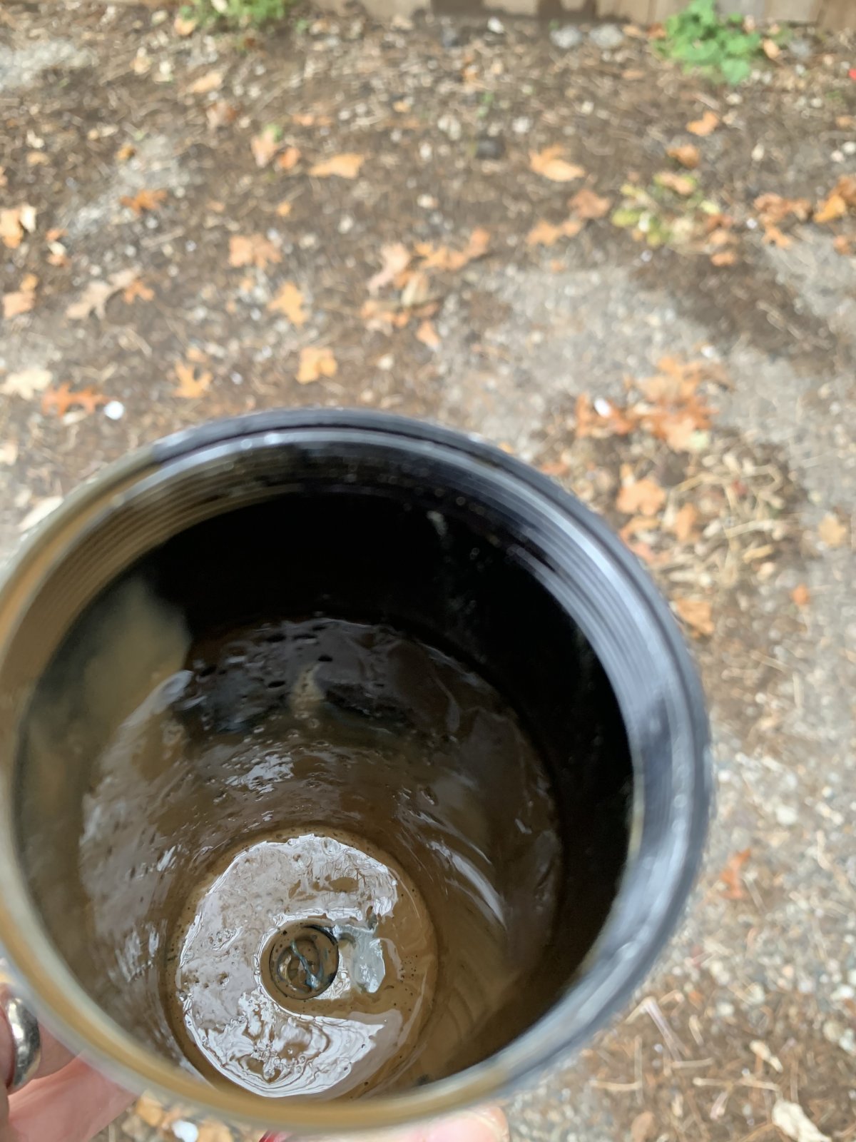

Im also in Michigan and emptied mine out today too lol same thing. It was half full that’s just the residue..

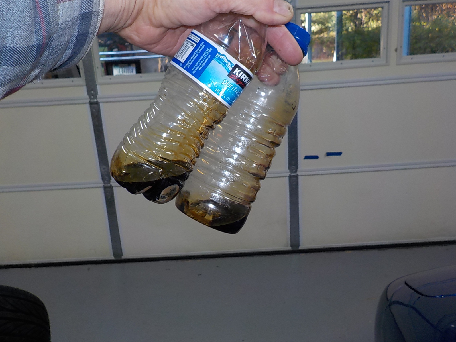

there is rpo code BS1 in my 07 Denali glovebox = Insulation, Acoustical
and
I have 2 different brand/style catch cans on 2 different vehicles and get 1 to 2 oz of dark oily fluid from each per 5000 miles.

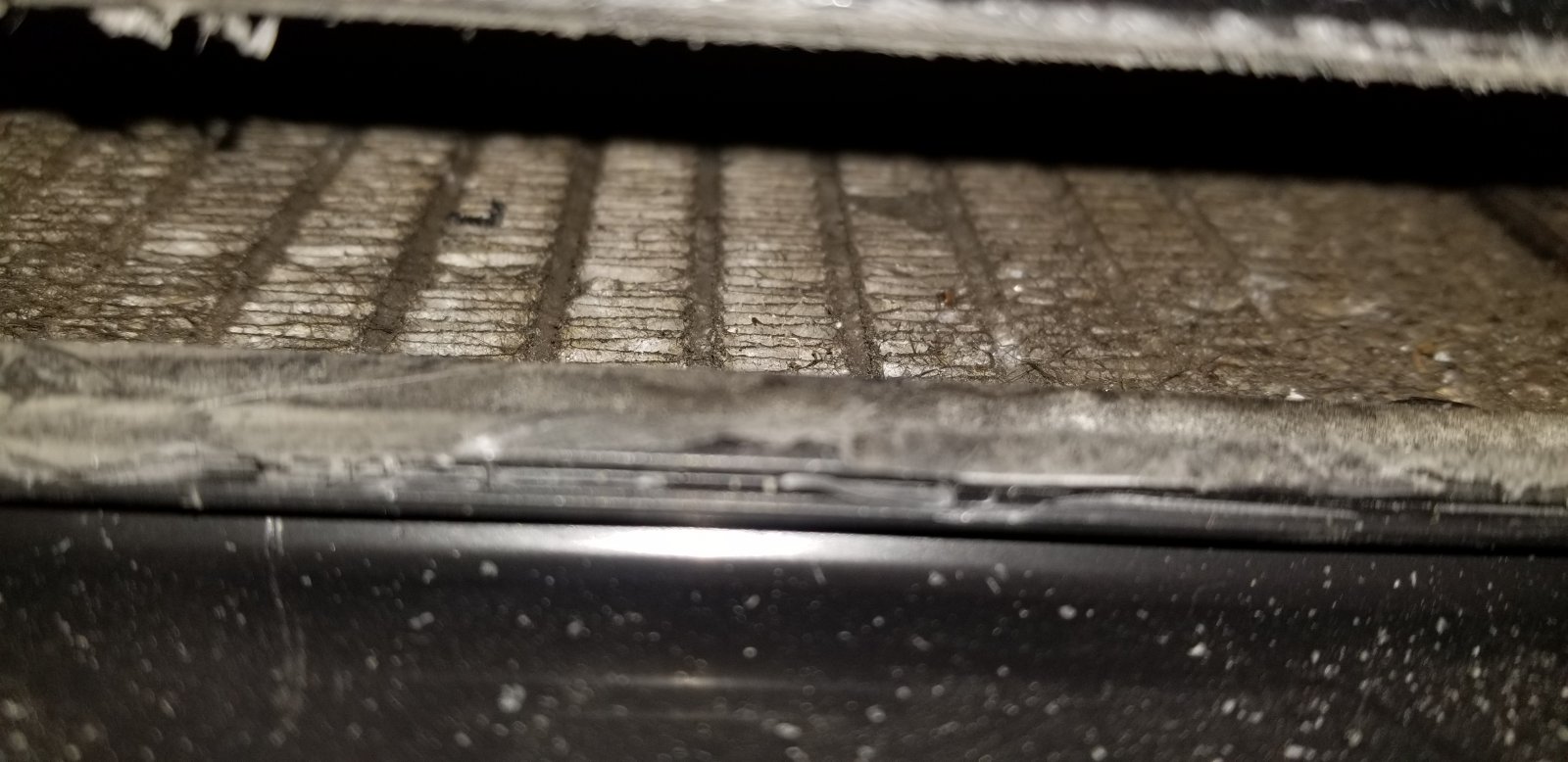

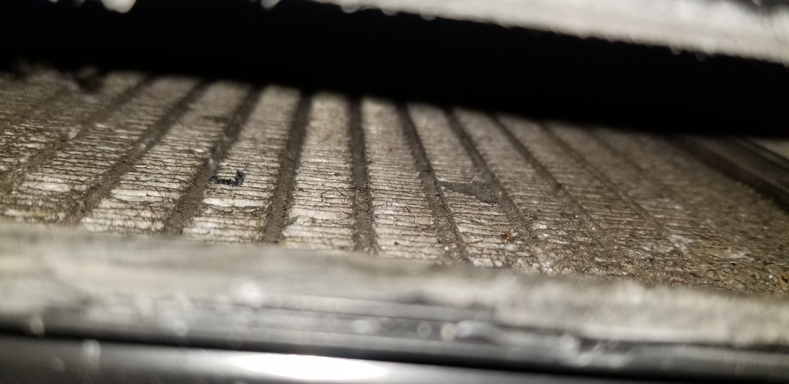

Working on my cabin air filter now...but when looking up at the evaporator - what's the best way to clean this up? I saw there are sprays. I was thinking about using a brush. What are your thoughts?
