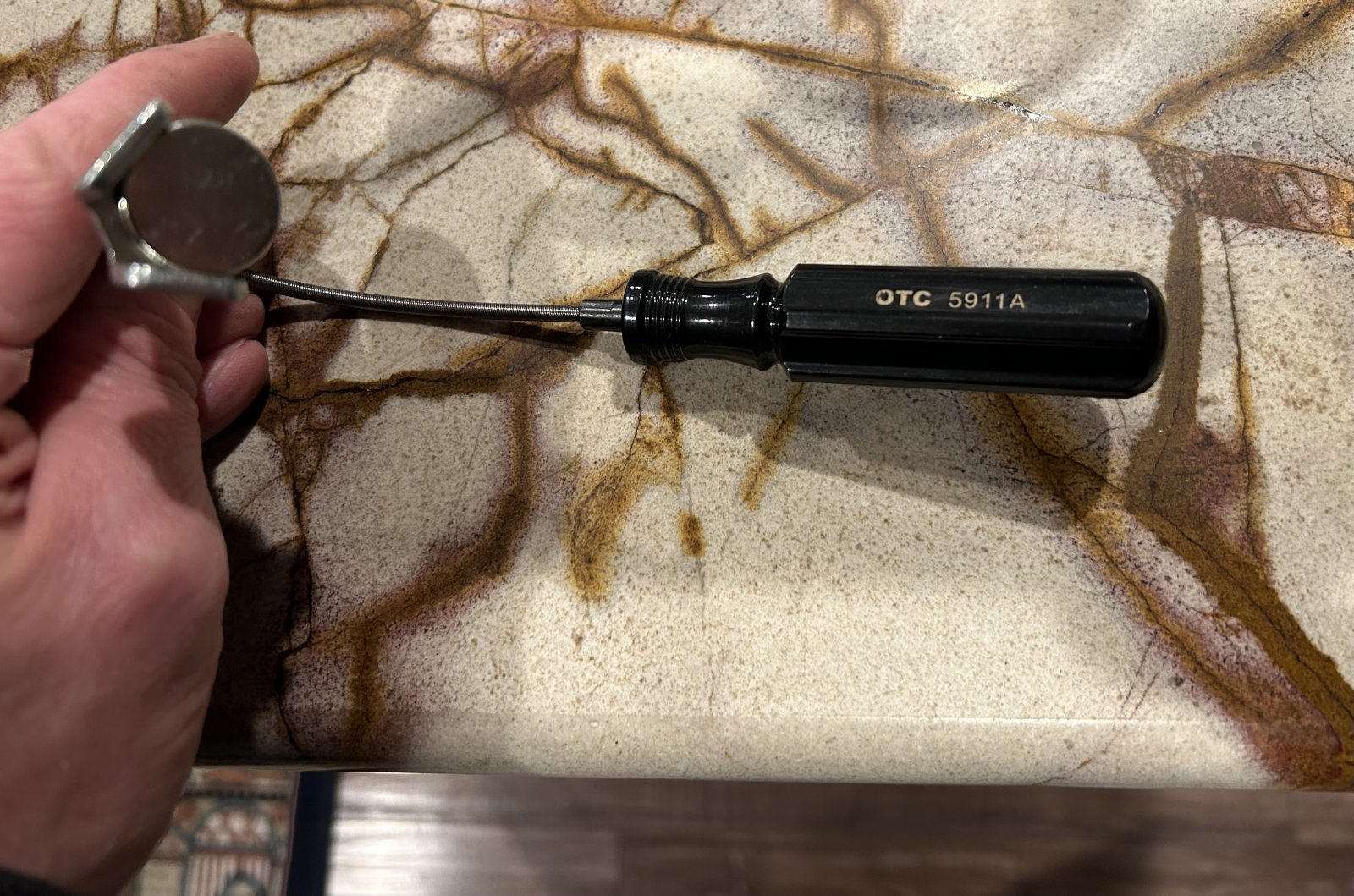

As for the oil change, I have to make a couple comments for any of the new guys who lack the Jedi abilities to pull the plug without splashing a drop of oil. First hint…do NOT pull the fill cap prior to pulling the drain plug. Hot oil moving way too fast for the rookies. Wait to pull the cap until after you’re out from under the vehicle - in a safe zone. Just be mindful of your drain pans location. Personally I have my drain pan sitting up close to the vehicle frame to prevent spillage, and I also use a splash pad inside my drain pan to keep oil from getting all over the place. The same goes for my transmission drain pan. It has an oversized splash pad/mat for the larger catch pan, and they normally sit on top of a metal drip pan (large rectangle pan, very shallow but helps with any: “areas of concern, oops’, oh $h*ts!, or by the way’s…”; all of which are sitting on a big piece of cardboard.
For those that don’t already know, or for whatever reason don’t own a funnel, you can cut the bottom out of a Mobil-1 quart and thread it onto your oil fill tube, which can then be used as a makeshift funnel. I keep it along with one and a spare quart of Mobil-1 in my Denali for just such an occasion. This may work with other brands, but I can’t say for certain as I have never used any engine oil in any of my vehicles besides Mobil-1. The trans and differentials have only ever seen ACDelco, Amsoil or Royal Purple. Other than my ‘02 which used GM’s special blue Transfer Case fluid. I’m sure someone else can chime in.
Lastly on the oil change topic. See the photo below in the event you do not already own enough tools or lack the patience to become one with your Jedi abilities. This is a flexible drain/fill plug tool that uses a neodymium (rare earth) magnet to assist in unthreading the final turns necessary to safely (and cleanly) remove the plug. Doing so without dropping it into the pan splashing oil all over yourself, your clean cardboard, the underside of your vehicle…etc, is somewhat of a learned skill.
OTC - 5911A

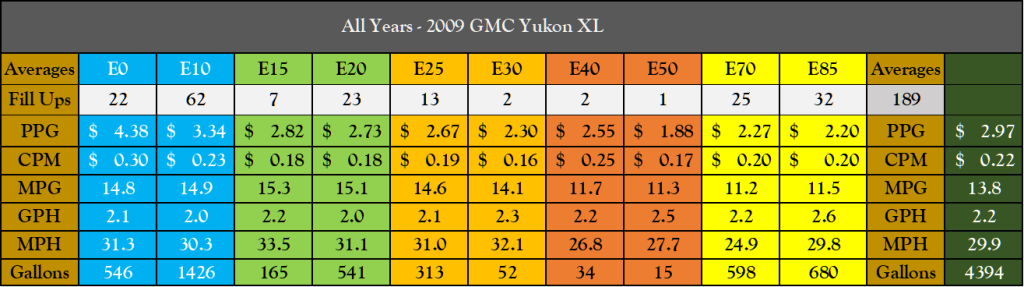

I've run 87 octane for a yr, 89 for a yr, and 91/93 for the past 2 yrs. I even done 20-30% mix of e85 with unleaded. Runs great on them all. But I got knock message a time or 2 when running 87 & 89.
Here a data chart someone? here (not me) posted a couple of yrs ago.
I think this is from @swathdiver if I’m not mistaken. He and I geek out on excel spreadsheets often shared on here and some of the other similar sites.
Not having a flex-fuel vehicle, did you have to change your fuel trim info via tech2? While this table is obviously subjective due to the amount of miles driven in a year, the temp, driver, traffic, weight, pax, inflation…etc. but did you see a difference (other than knock detection) in say E85 & 87 versus running premium. I ask because you have a 6.2 vs the 5.3.
I my case? No, didn't change a thing.
Pulled up to the pumps, put 5 gal of e85 then filled it up the rest of the way with 91/93. Saved about $5/fillup at the time. Same MPG and performance (conservative driving).
